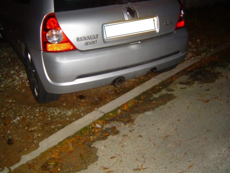

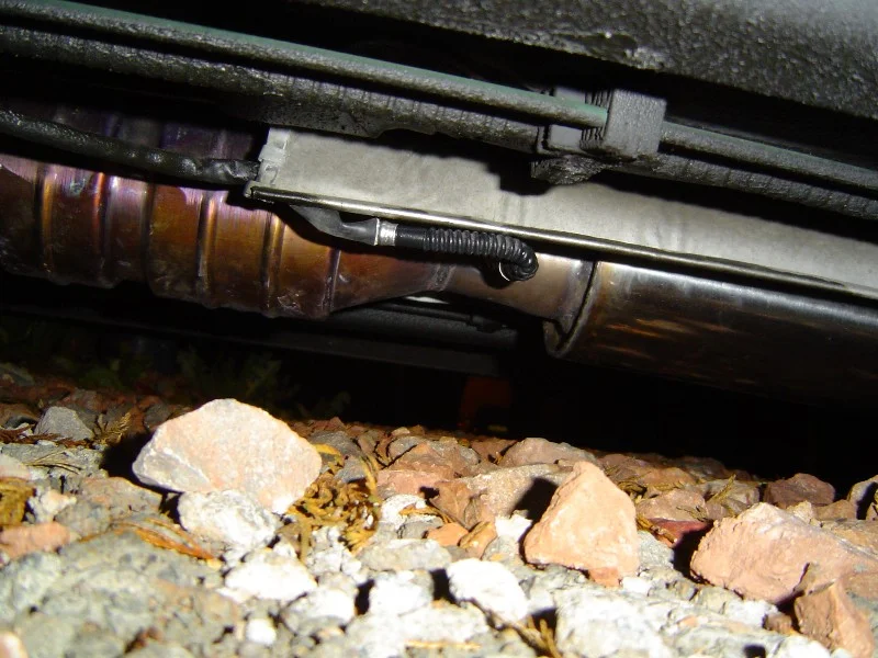

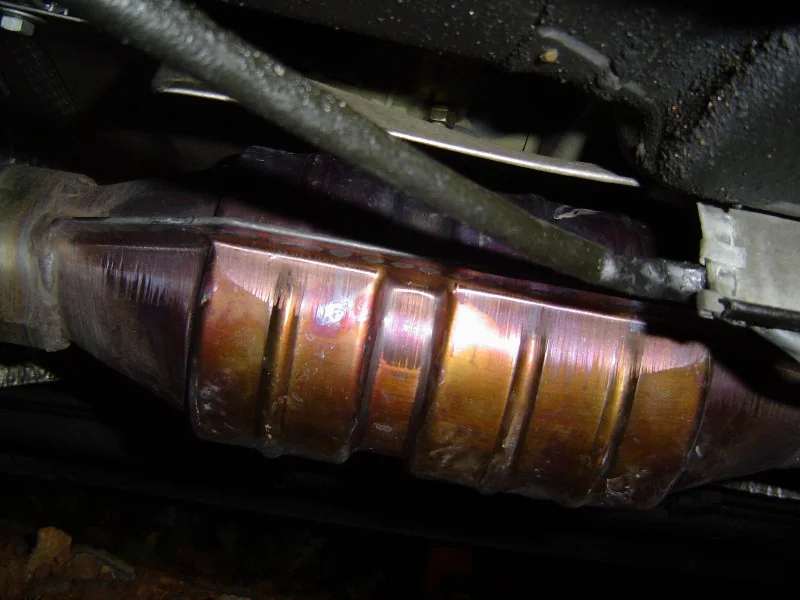

hmmm, cheap sports cat mine was £160.
This did seem cheap and when I looked at it was not what I expected see pic. Others I have seen are tubular metal where as this is pressed and flatter. Oh well if it fails I will have to invest in a better one.
I am getting an Omex fitted next week so my SERV will be on anyway!
