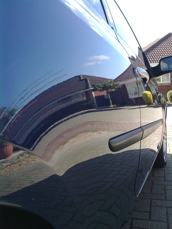

Just thinking how im not looking forward to car cleaning in the winter so thinking is there anything i can do in order to make it easier. Im thinking lots of layers of wax. Using megs at the moment but any other recommendations im thinking CG xxx

Yeah clayed my car not too long ago but think i will give it another good going over spend some more time. Think payday i will be treating myself to some nice new waxs :)

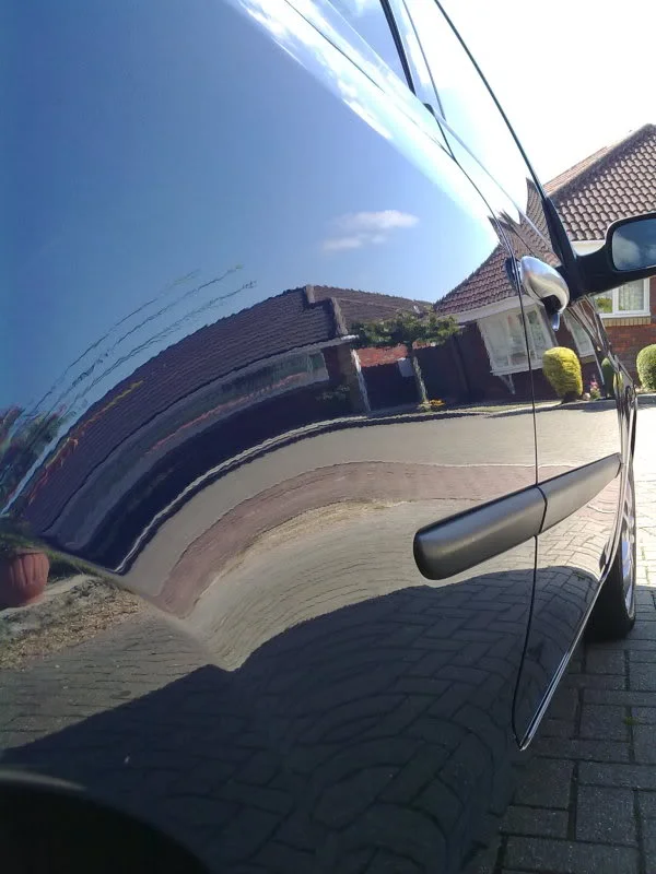

Want to keep it looking like this really: (how it stands today)
