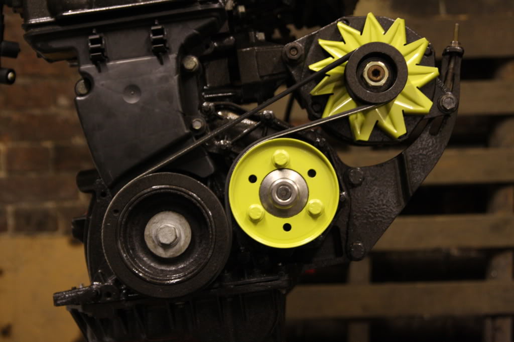

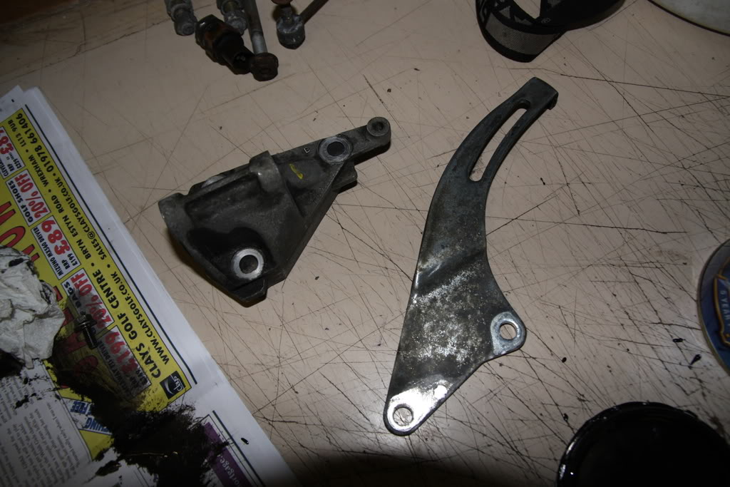

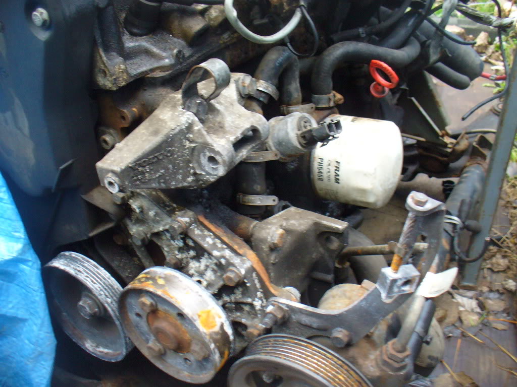

You need these parts then put them on like this:
with a 5 rib belt to miss the cam covers, the brackets can be found on non PAS R5 1.7's, volvo 440/460 and 480's
You can also use the brackets that come on PAS volvos with slight modification to the bottom bracket to miss the subframe.

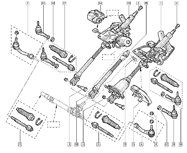

Id like to have pas back in my vag cup but god knows if its possible - any ideas welcome :)
Find a donor clio with an elec PAS pump built onto the column ( no 13 )
I take it you have changed your rack when you removed the PAS system. If not it will be very hard to steer. I fitted a standard 1.2 Steering rack on my conversion and it was very easy to steer.
