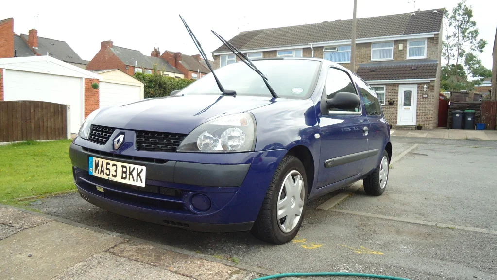

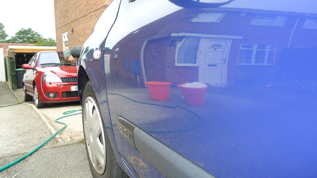

Pics of the shed when I got it:

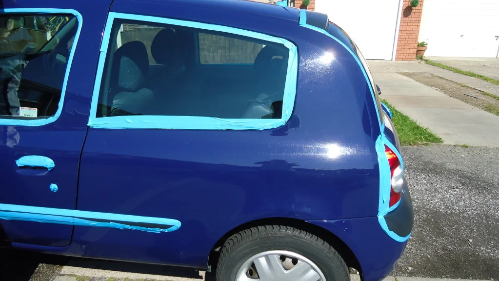

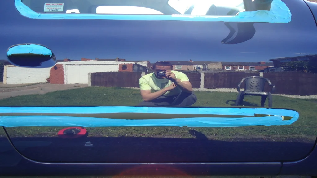

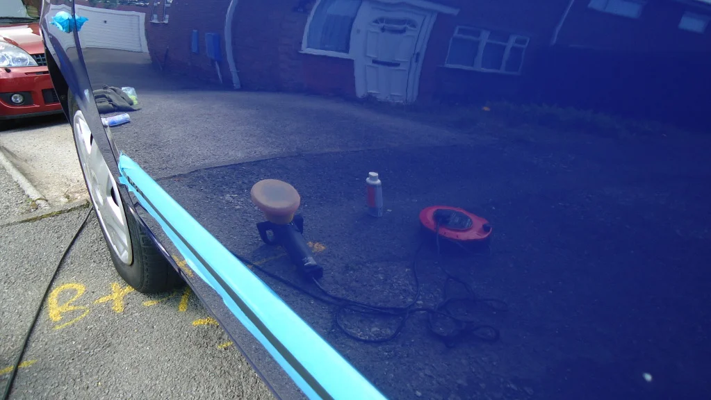

Taped off ready to be polished. You can really see the swirls in this pic:

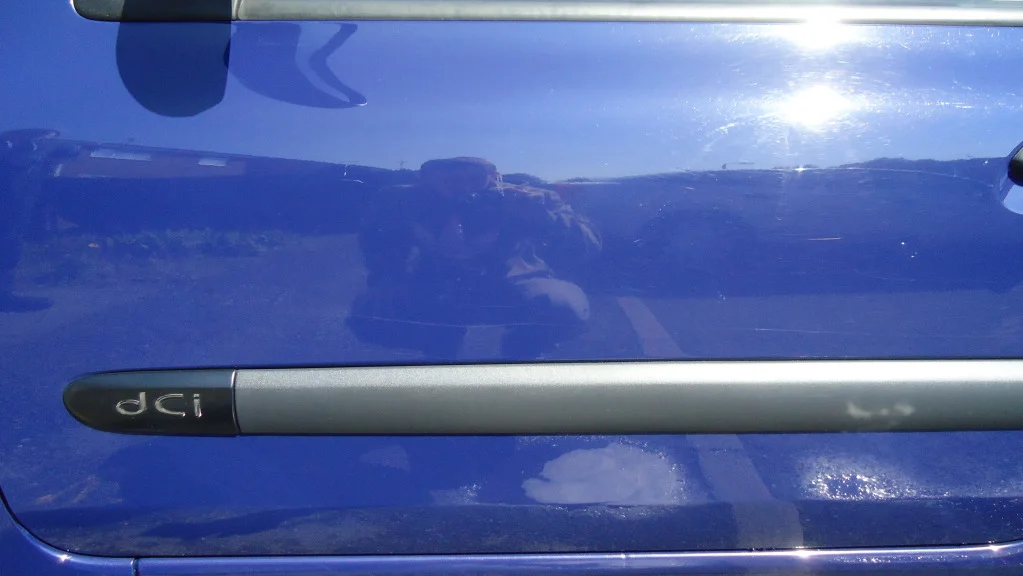

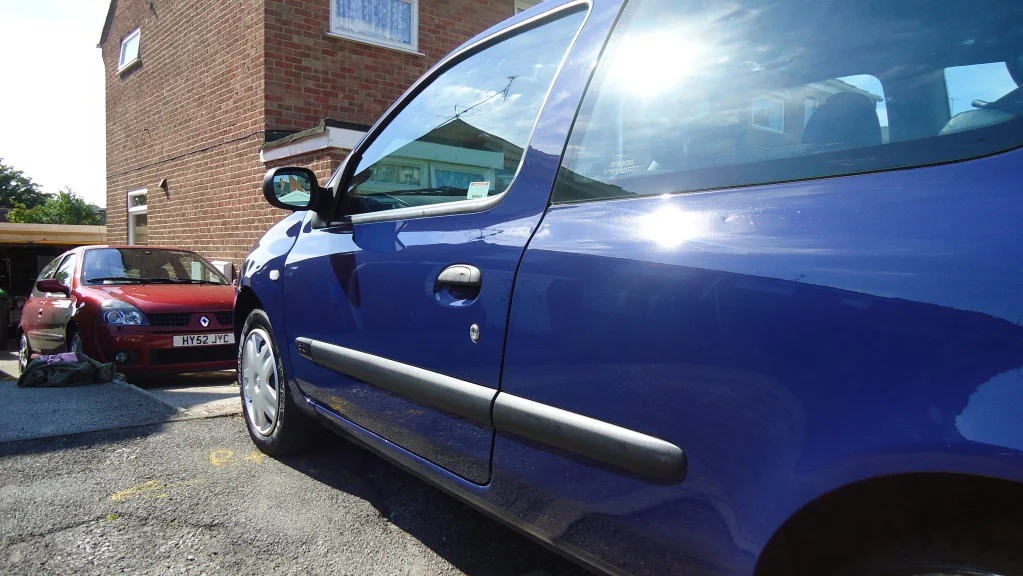

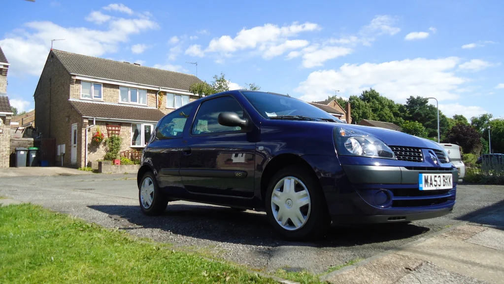

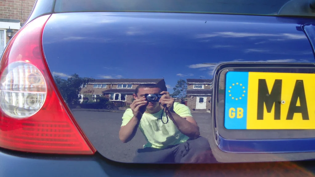

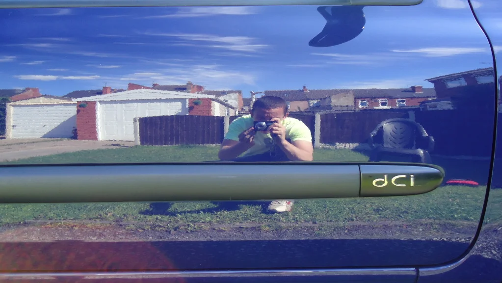

The finished article:
Im not totally happy with it as there still are some swirl marks left, but I didnt want to end up taking too much paint off or causing any damage to the car so I left it as it was.
:star:
Looks good. Quick tip in future to save you time and money (costs of tape); take the side bump strips off. They pop backwards and forwards and off. Much easier!

- Taped up using 3M tape
- Polished using G220
> Menzerna Power Finish and Mild Cutting Pad
> Menzerna Final Finish and Polishing Pad
