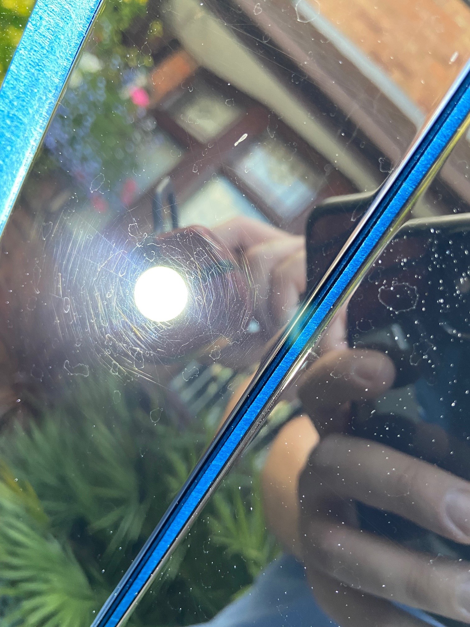

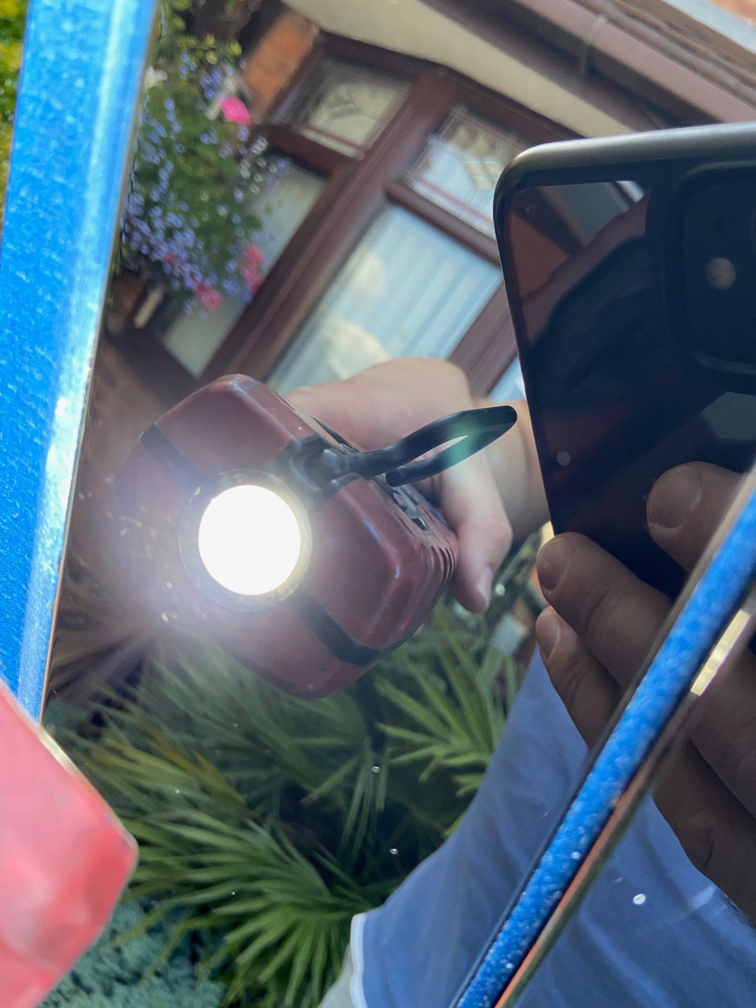

As my new Megane Trophy came with free dealer applied scratches 😡 on the gloss black plastic door pillars and around the sunroof what is best to remove them?
I have a DA with hex logic pads orange, green, white and black and Meguires 105&205 what would be the best combination to remove them? Or is there a better product out there.
once they are removed can a ceramic coat be applied on the plastic or is it for painted surfaces only?

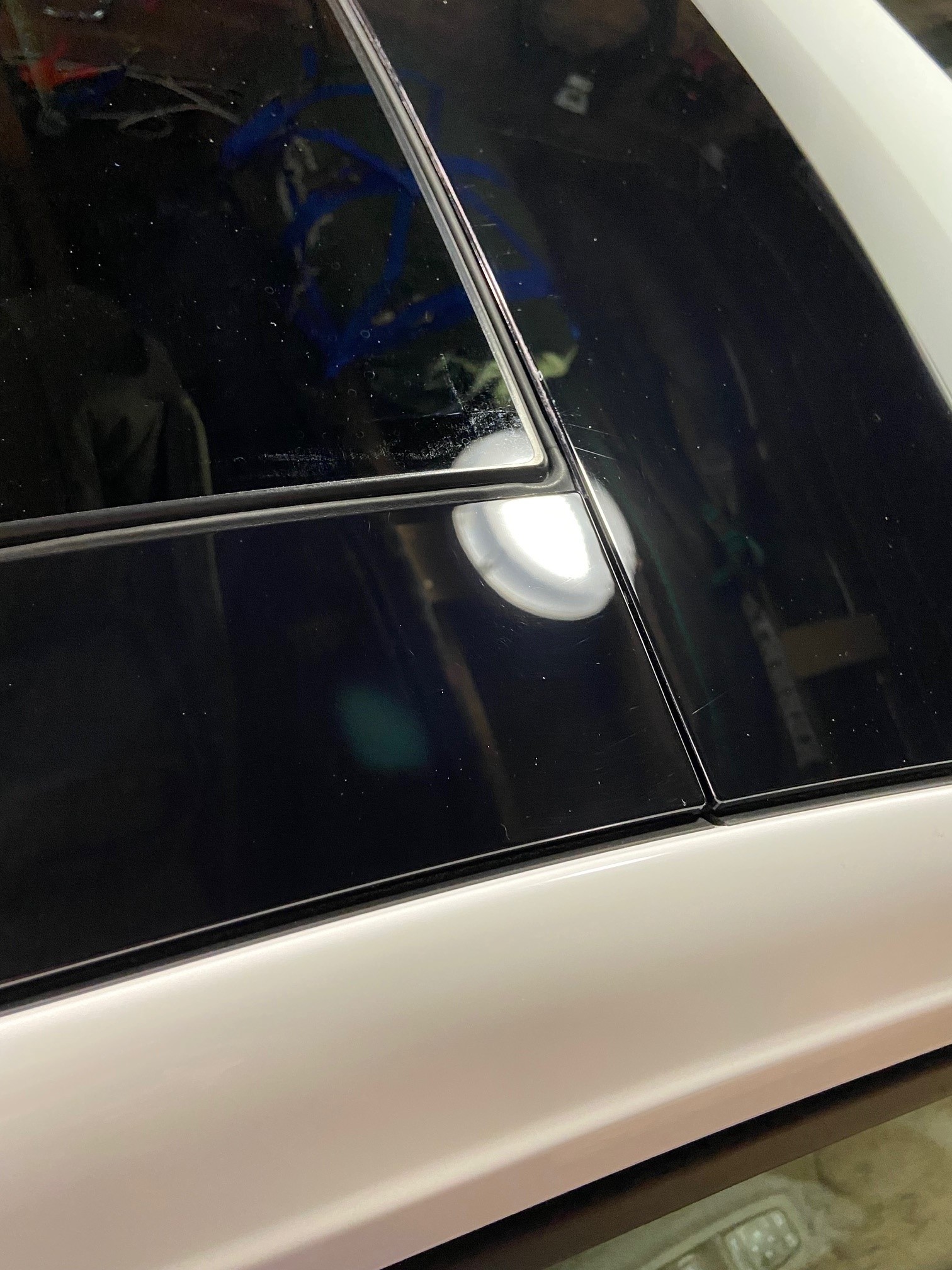

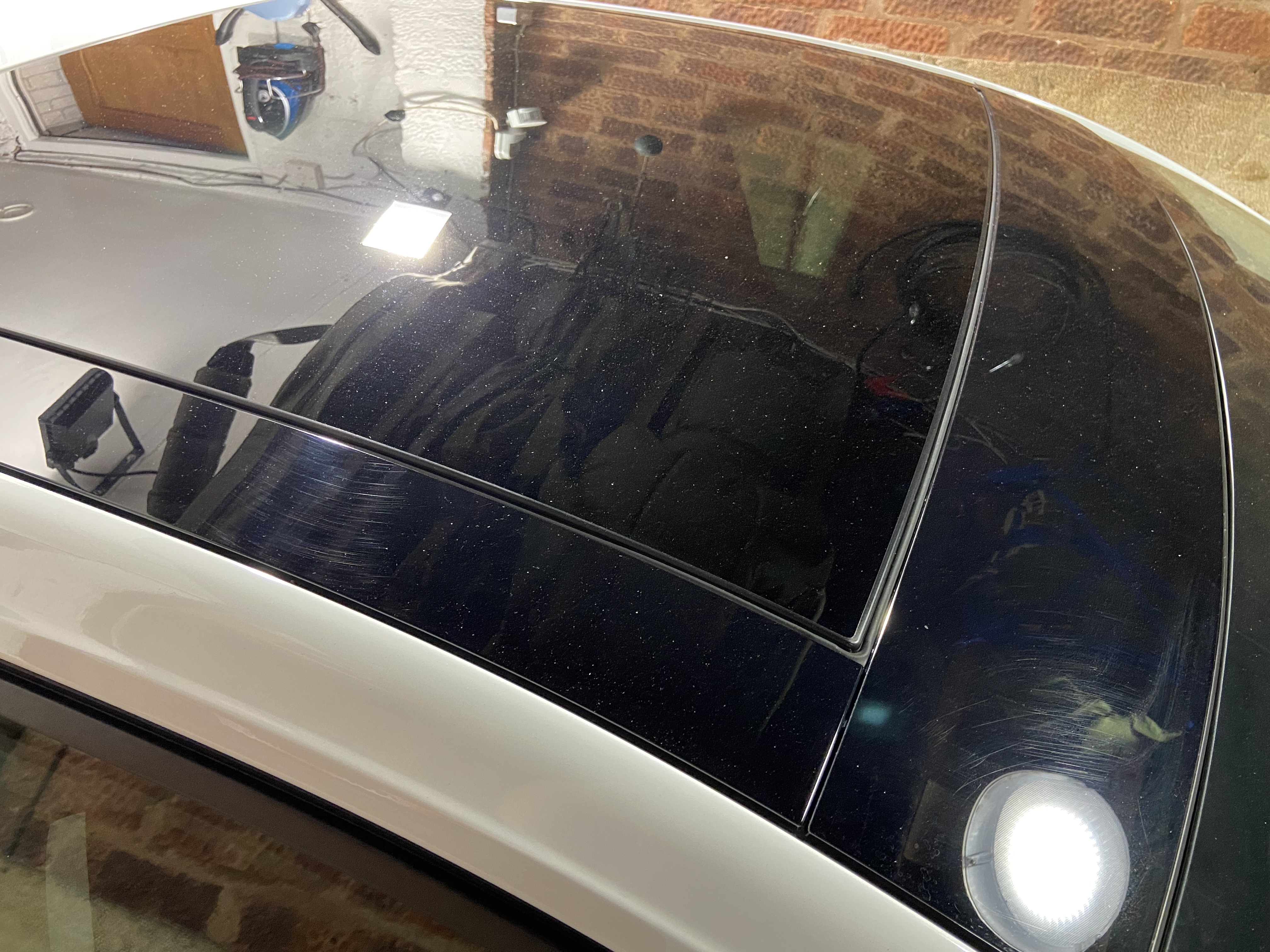

the sunroof surround is the same material as the door pillars looks like they used a Brillo pad
I would take it back but the dealer is a long way
Just to update on this, I polished the sunroof surround and B pillars and they have come up quite nice not perfect but a lot better.
Went over with a hexlogic green pad with Meguires 105 then onto Menzerna 3800 super finish plus with a black hexlogic pad.
