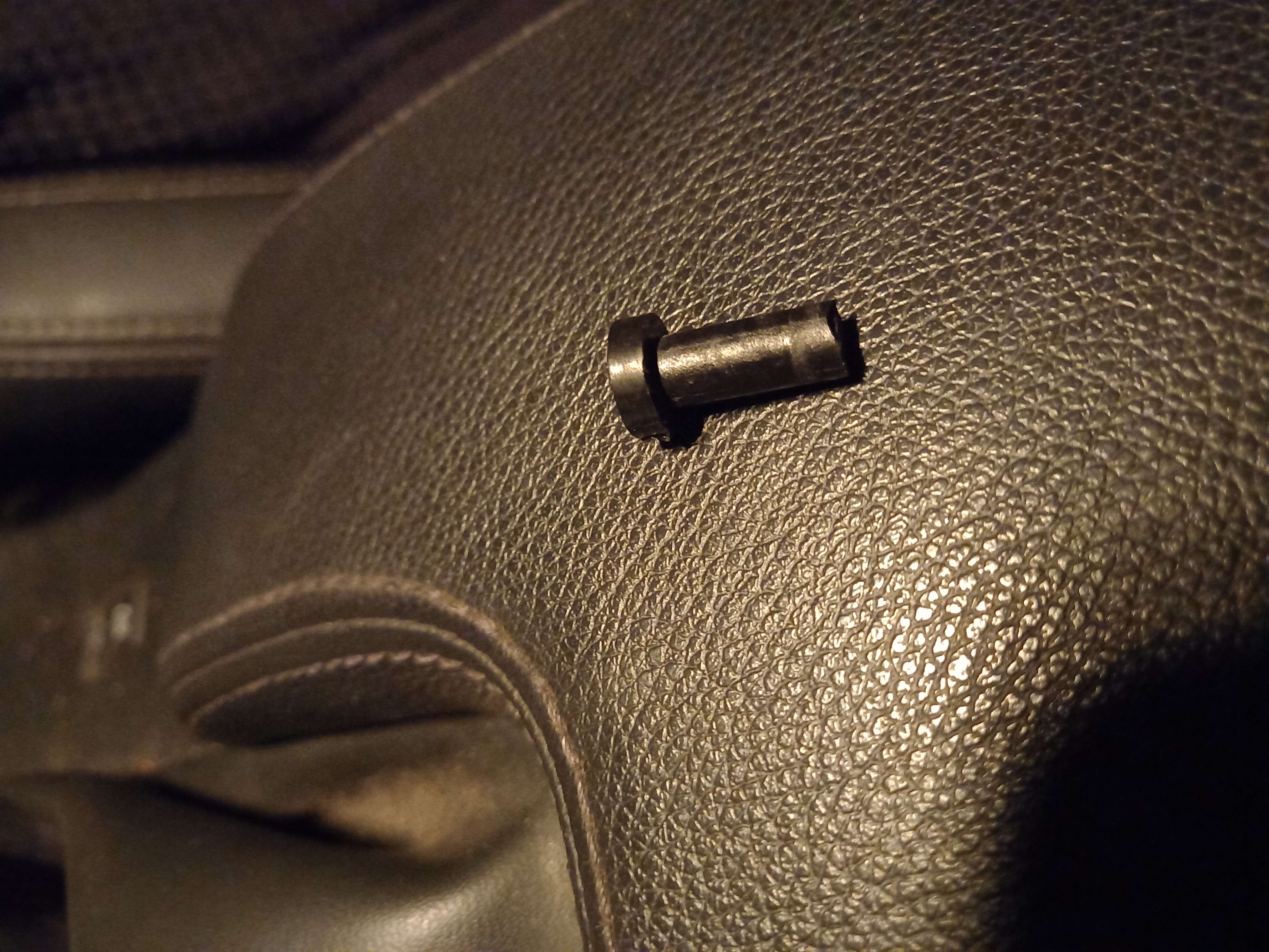

I believe this little black plastic pice is the problem. It runs true the hinge.... Just took my glove box out and knoticed this broken... so I found a bolt a little bigger than the hole and screwed it in as a replacement. Seems to have worked. 🤙 #plastic$h1t3
