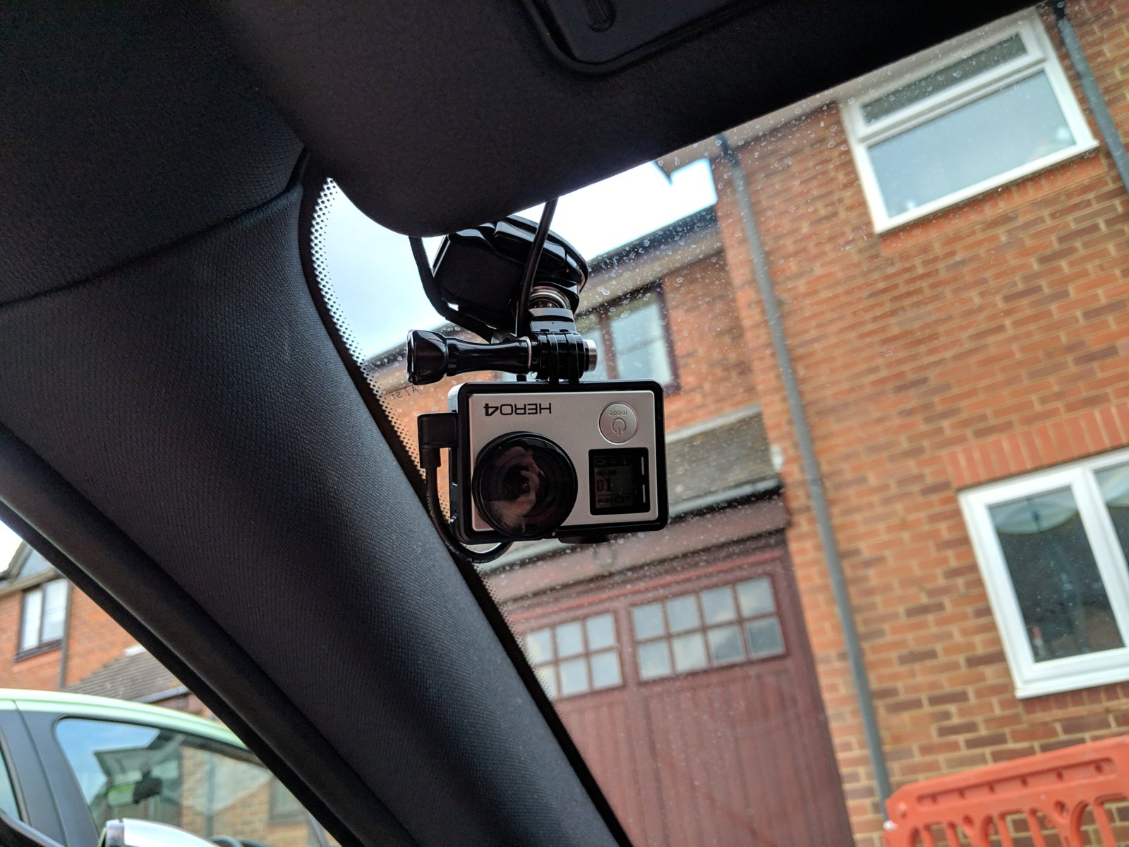

I'm new to it, but I was testing my GoPro position earlier and it seemed to get a good picture with the suction mount fitted:

Think that is what I need the pivot part. As I have a suction pad but need it to spin to view the center of the car more
If your using it for track then a suction cup mount always requires an additional tether. Which limits you to placing it below the rear view mirror.

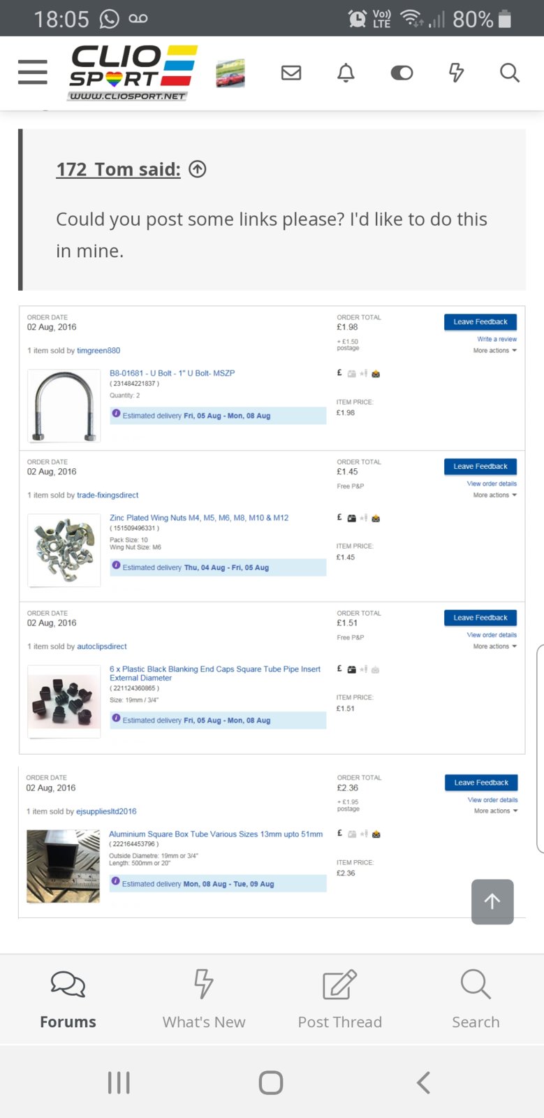

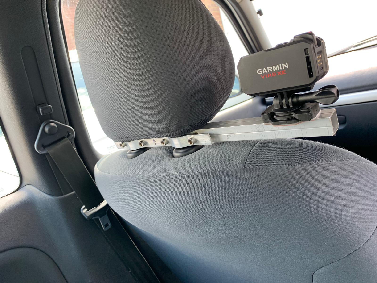

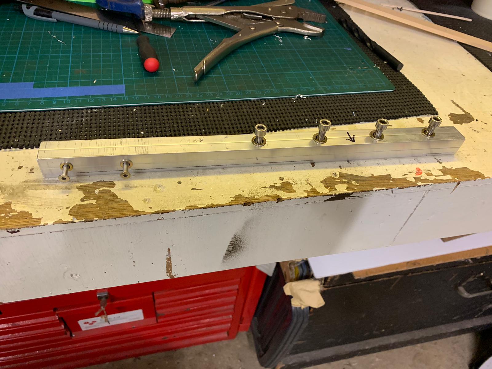

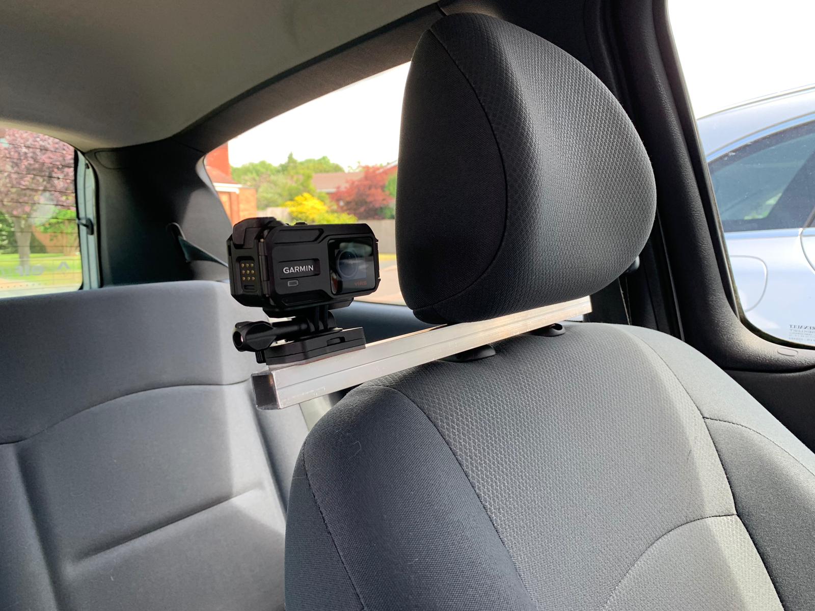

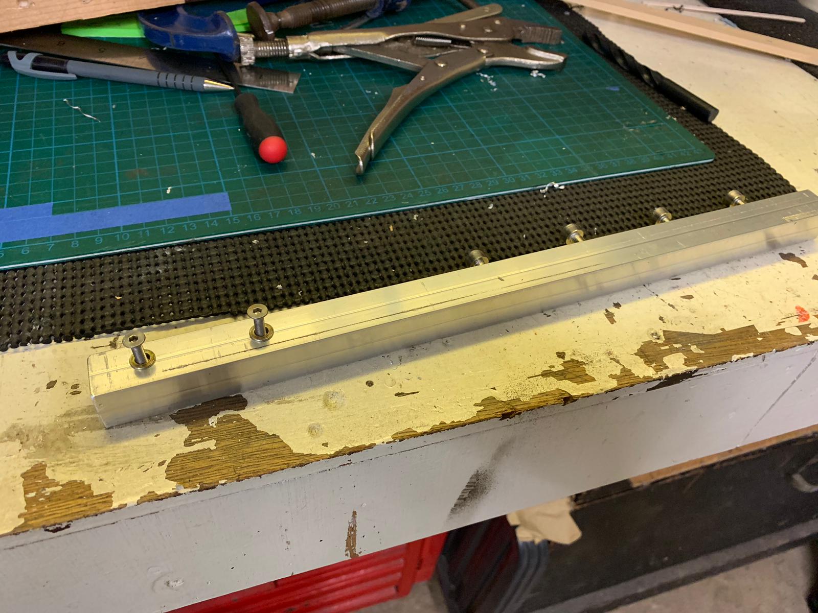

For my old Clio j just made my own headrest mount and used the bicycle handlebar clamp that came with my SJCAM.
DIY headrest mount bits

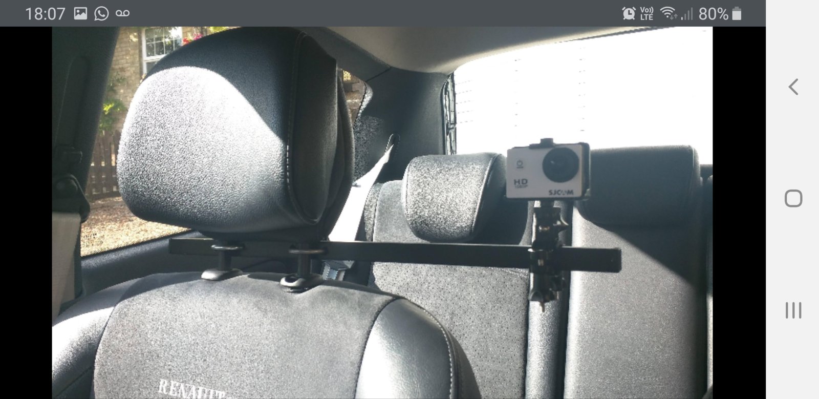

Finished article thanks to @Amos91
Theres a full how to on here somewhere, I just had a quick look but couldn't find it.

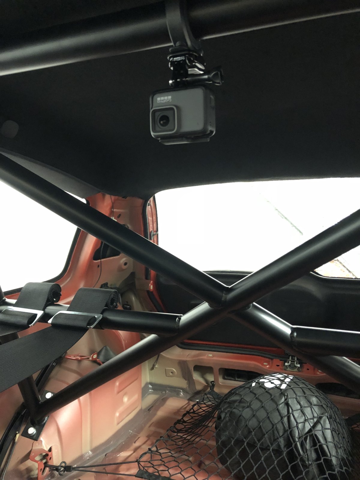

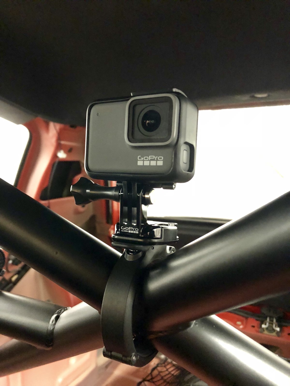

Depends if you want you (the driver) in the image or not. It’s easy to mount off of the dash and you get the best view out of the car but you can’t see what the drivers doing.
Mounting off of the cage X is good but you don’t see much of out the front and the GoPro seams to struggle with contrast. Inside looks good but outside is so bright you can’t make out anything. I’ve found turning the go pro on out side and not in the pit garage helps reduce this.
Ideally you need the camera near the side of your head area between the two seats but it awkward to achieve this. But with this you get a good image of how you’re driving and what’s going on outside
Thanks for the replies seems like the headrest is best bet. I haven’t got a cage. I do have a suction mount but it just doesn’t work great. Either way I’m going tether is as got told off before for having it on the helmet lol

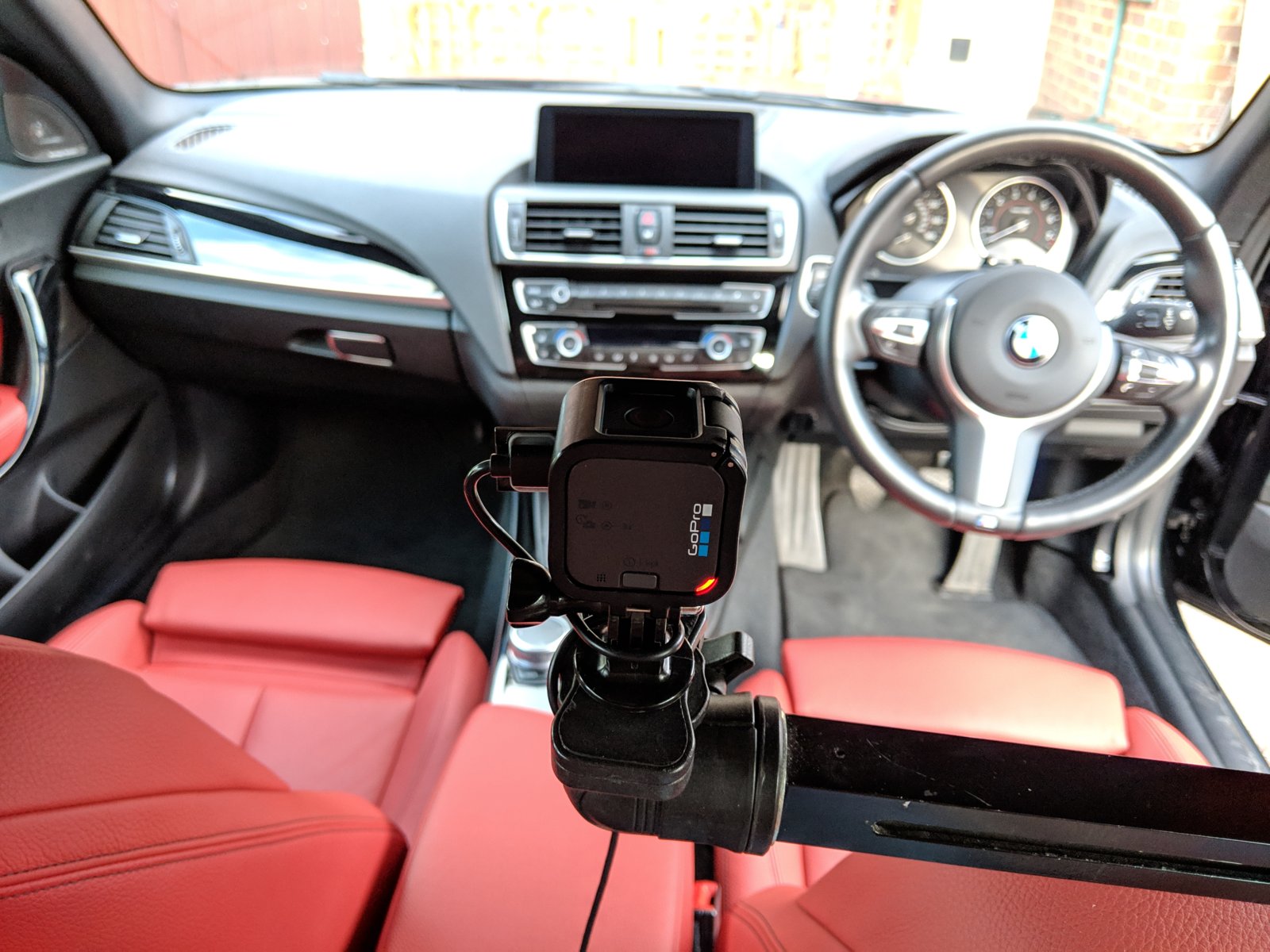

I've got the Hague headrest strut mount which works flawlessly, has done for 15 years now, but as the seat moves a little when you're hammering it on track you ideally need something with some inbuilt stabilisation to compensate for that movement.
For an alternative, and without needing to buy a suction mount, consider using one of the flat sticky mounts on your windscreen. I use it to have the camera facing inwards but you could easily have it facing forwards as well. You will probably need a tether as well for that one...I use para cord ones which are available on eBay/Amazon for actual pennies. As it's a fixed rigid mount you need zero stabilisation.
Also, if you can, get hold of one of the swivel ball mounts I'm using in the picture above. I think GoPro have discontinued them now so I tend to buy them whenever they come up for <£20 - it completely removes the old two axis only alignment issues you might have and blows away every other swivel/ball type mount I've tried...and I've tried a few!

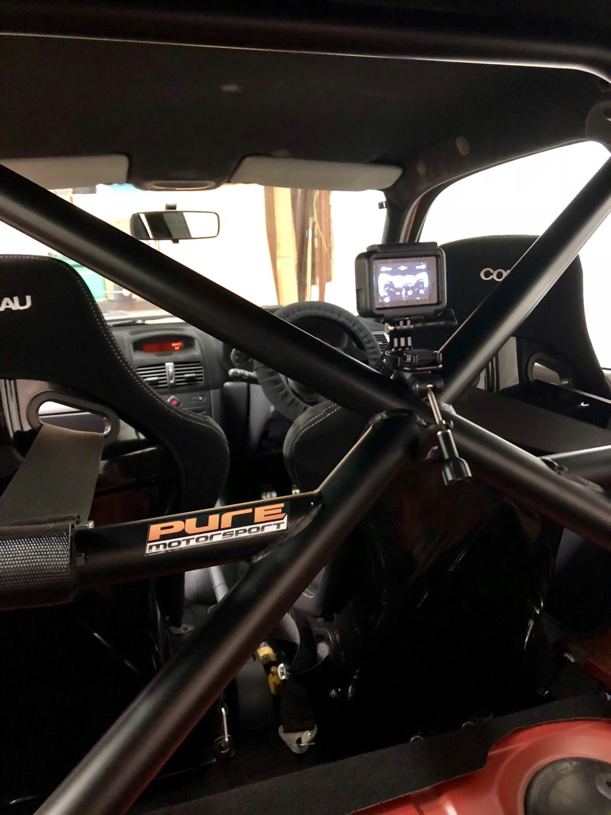

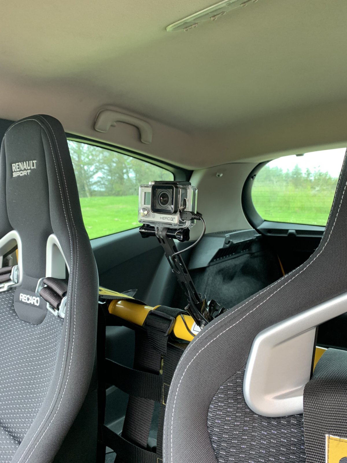

Attached to bar behind seats, wired in.
