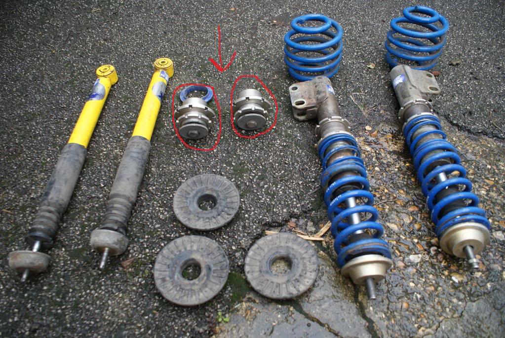

Ok in this picture, the red things circled you should have those? Or something similar
There are two locking rings, you need the one thats on top as thats what the springs sit on, the bottom one i got rid of and just put the platform ring right to the bottom.
yeh ive got them mate. i know what you mean now but do you think i could leave the whole ring out ie just use the spring? or would you think its best to kepp the bottom ring in for safety?

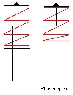

Can you fit shorter springs to the front so that you can wind the coilover up?
Thus taking the slack when jacking up the car and giving a better rebound
