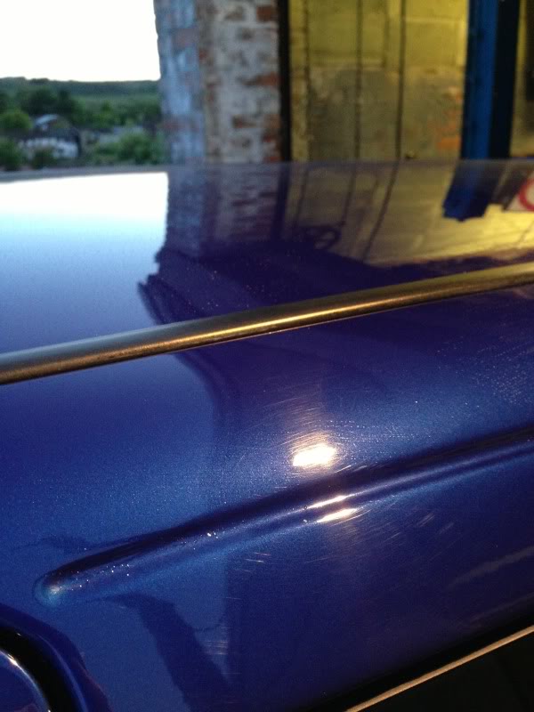

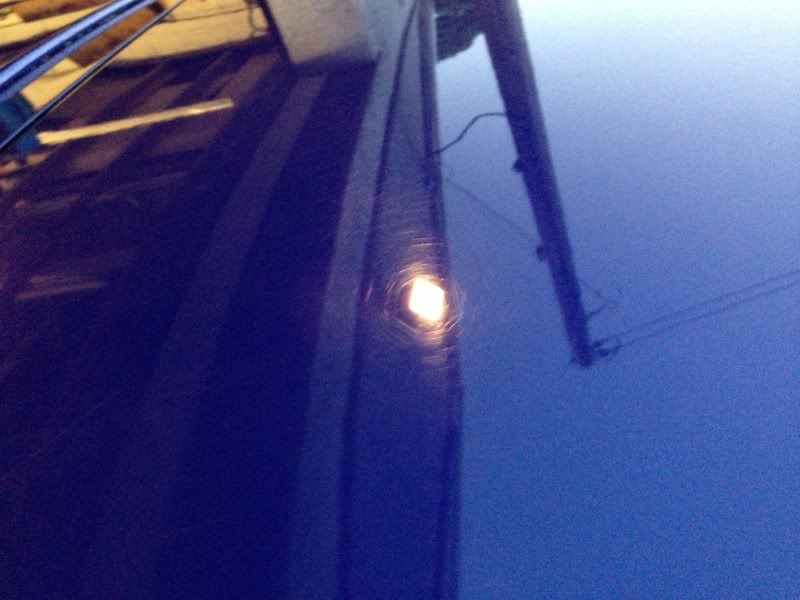

Hi guys, thanks for the advice, ive always been into clean cars, but i just want to step it up, i havent had no proper rotary 'experience' as such, ive given my van a going over with a rotary and ive got another clio which ill probably have a toy with first to get used to running the polisher over the paint
few lil pics of what im up against, photobucket has killed quality
as you can see theyre quite annoying lol

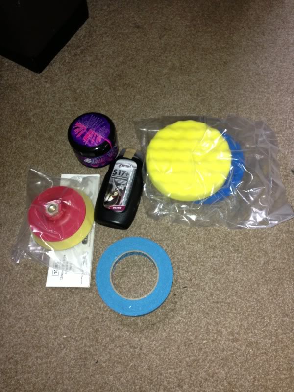

Well thanks to all of the advice
this lot came today
can see how an expensive hobby this could develop
into, it doenst loom much for the money lol
looks like im going to be im the garage most of today
Dude as you've only got one of each pad you need to regularly wash them out. (Especially with s17) fairy liquid and warm water. Pat dry then spin it up on the machine to dry!
