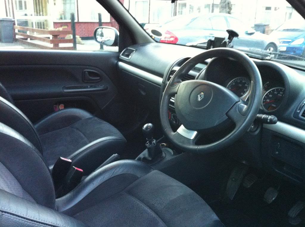

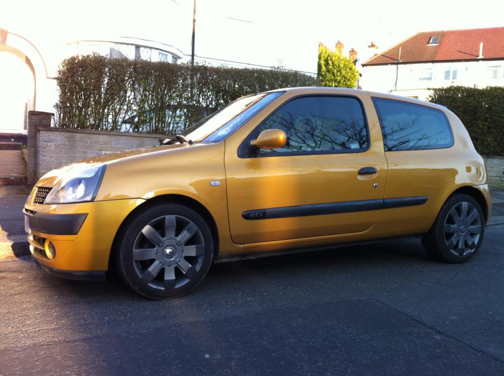

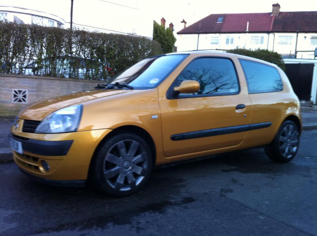

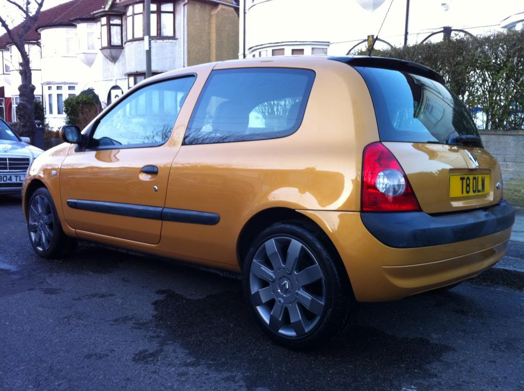

Hi Guys,
Been a good while since i've posted, thought it was about time to put up some pictures.
Any thoughts? Sorry for the poor quality.....camera phone.
Cheers,
Ollie
Cheers, not bad for 128,000 miles!
Think the next plan is to cc the side strips, not sure if the gold will have faded though and make it difficult to match. Had a yellow ibiza before and it was 5 different shades of yellow!
