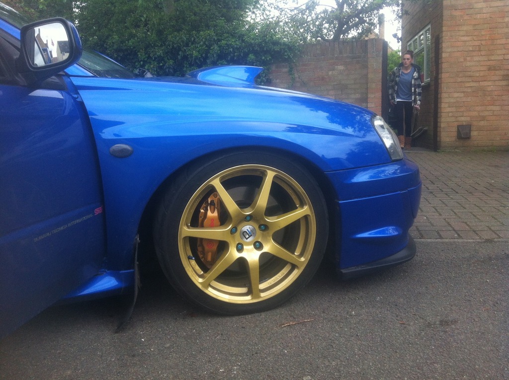

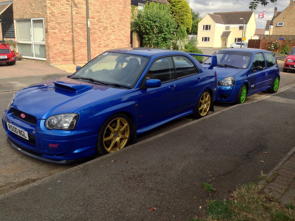

This is the paint I used to refurb my speedlines, took me ages to find the paint as I wanted an exact match.
Yeah I think that's the one! The colour Turini's come on Subaru's in/can be bought in? The only problem is the paint shop need a paint code for the powder coating, that's what I'm struggling to confirm. I've found this so far: AKZO 7E81208. But as they have to order it in, I don't want to just go off a forum post in 2005!
yeah you will struggle as from what I can remember they were wet sprayed, I had same problems
