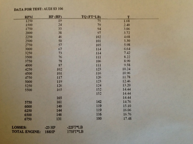

Well, here we go....

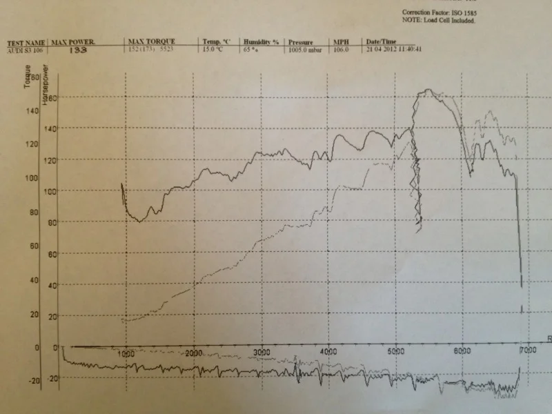

Graphs are at the wheels, max power is shown on the table at the flywheel and written on in the graph (as they ran out of colour toner, and the power is in yellow so it didn't show up in the printout)
The lumpiness I was told was more to do with the rollers and the tyres (as the tyres are very very new and they were slipping a little, which is where that huge blip comes from). He said there's no way the engine was running that lumpy as it didn't feel like that when he was in it. They reckon the drop off after around 5500 rpm is probably spark plugs, so i'll get them changed asap.
So 188 at the flywheel, and 165 at the wheels. Torque was 173 at the flywheel and 152 at the wheels.
Interesting figures. I know people will say that this is high, but I'm really just using it as a base to work from, so I have a start point to measure changes.
Technically if the power was up at standard and with the exhaust and the sports cat in place, in theory this could actually be correct.

Graphs all say Audi s3 ?!

I dont think its the engine, I just think those rollers are rubbish.
Assuming that it does have a problem that means its making peak power at 5500rpm, that peak power would not be more than about 160bhp.
Torque of 173? Thats more than most throttle bodies engines with cams make!
TheEvilGiraffe
As Chippidychip said, the rollers look awful. Curves should be smooth. Also, if the machine thinks it's an Audi, the calculation steps for the final drive ratio might be WAAAAY off.
I also don't like guestimates at wheel back to fly power. There's no way of knowing the losses through the box. Three runs with 3 different types of tyre on the car will give you 3 different results.
At the hub is the only way to roll, IMO ;)

Power loss at 4500 from 102 to 101 then up to 117. Normal?
Well no, but it's not necessarily power loss, there were some tyre slippage issues as the tyres are so new, the first run showed 90bhp cause they were slipping like crazy - i need to bed them in more. I'm not looking at every individual blip on the curve as I know there are discrepancies and I know the car doesn't drive like that, so i'm just looking at the average trend, which shows it going up. The only thing that I AM looking at is the drop off after 5500rpm - that's definitely not that normal.

The whole thing is not normal mate, I would get it on some proper rollers before you draw any conclusions.

I don't have doubts about the engine at all, it runs just fine (and the guys at k-tec agree when they drove it), all that dyno suggested was maybe a spark plug issue causing that dip after 5.5k (although it could be anything, or simply a balls up on the rollers). I'll just check them and if they're fine then I'll leave them and just hold fire until I go for a remap, where it'll be put on a more reliable rolling road with renault specialists.
Ultimately it was a quick last minute test cause I had some time spare, with someone local to me, that didn't quite run well due to a number of factors, that hasn't really revealed a huge amount about the engine. I know the jumps and losses on the graph are from the rollers as the car feels fine and pulls well and is very smooth, so I'm not worried in the slightest, I simply don't really know much more about my power output than I did this morning due to the strange output from the dyno.
