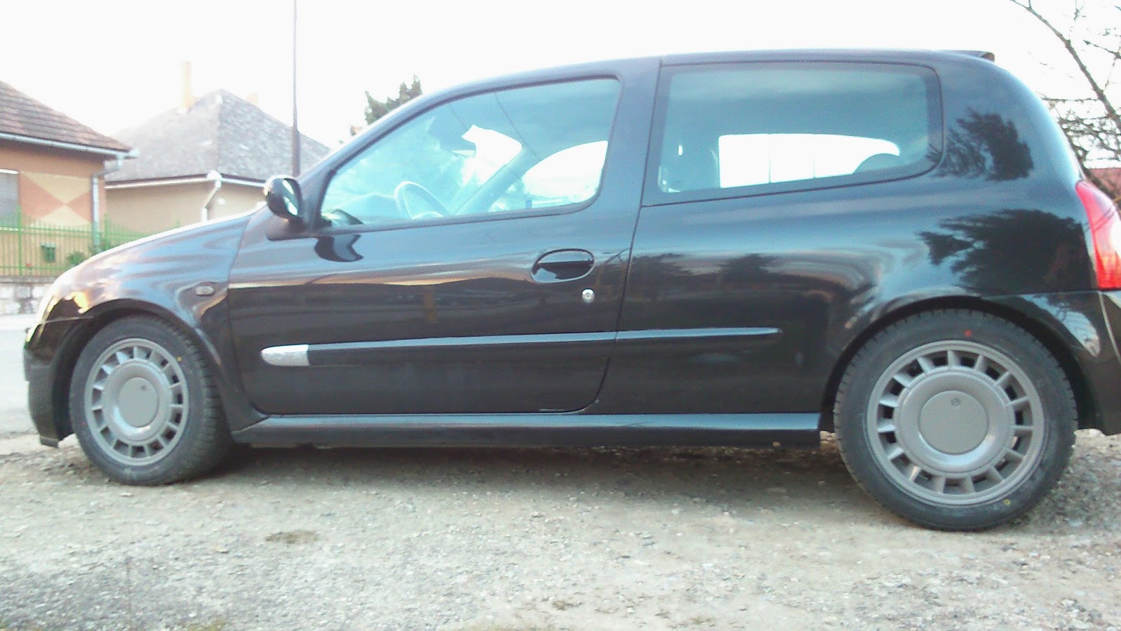

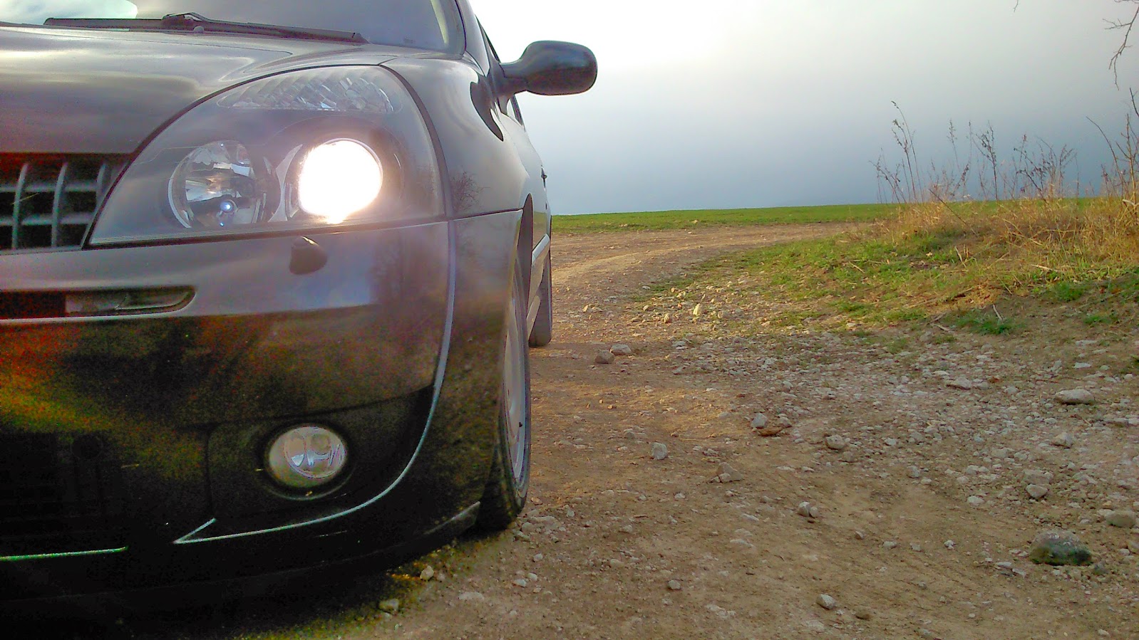

Fitted today....rubbing like hell (koni sports, eibach pro lines). Also front sits very low. Still on non cup wishbones. Also negative camber happened, due to beeing so low i think.
I wrote to eibach to confirm what are the spring for that i have. Must be something wrong on it. I will see what will be reply, i might try the konis with oem springs. Any comments welcome:)

You will get rubbing when going any lower than standard, as said it will only be the small bulge that covers the bumper bracket. So..... not the end of the world.
Them wheels aren't cup turinis as I'm sure you know but they are very high offset from the looks of it. Also, doesn't Koni shocks have slotted holes to adjust camber up front? And have you checked the tyre isn't rubbing the shock absorbers on the front and rear and the rear inner arch.

At a guess I would say that is circa 3 deg negative camber up front which shortened shocks with standard drillings and non slotted holes won't give you, neither will lowering it with a macpherson strut arrangement give you that camber.
The back does look fine, anymore and you would run into rubbing issues by the looks of it.
