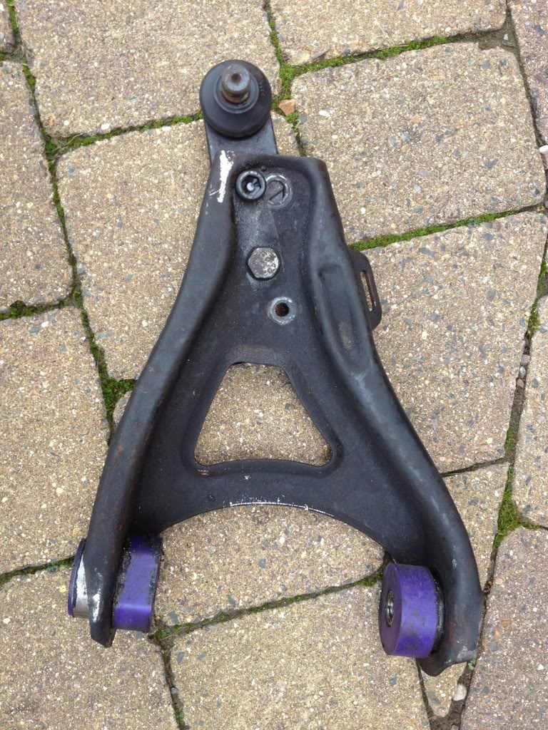

Chip, cheeky I know. But if I was to send you a seof 182 wishbones, you dont fancy doing what you did to a set of yours? Pushing them right to the edge of the arm?
Nick
Your best bet is to oval the hole a bit and try it, then do it again and try it etc to find the optimum point, then just just the bit you dont need welded up once you have worked out where is optimum for your car, if I just did the same thing you'd probably find it rubs like hell and needs changing anyway.
And TBH its a really trivial thing to do, you dont need someone like me doing it, any grease monkey mechanic with a welder should be able to plug the hole for you and then you can drill the hole in the position you have found that is optimum for your car.
I can do it if you get really stuck though, but honestly, there are better fabricators out there than me, I am "ok" with a welder, nothing more.
Okay Chip, tbh I was planning on going mad like yours were as well as running AST topmounts. No problem with rubbing, i'll happily cut away in the bracketry/bumper/anything else to make it work as it'll be going on a track/racecar.
  182/RS2/ Turbo/Mk1
On mine I swapped to cap head bolts to allow me to go even further into the corner.
TBH I see no real value in bothering to welding up the old holes on a race car, I just did it to be neat really, so if I were you I would just drill some new holes as far in the corner as you can get them, and then leave it at that, it wont go anywhere once bolted up anyway, and you can always plug the old hole at a later date.
  182/RS2/ Turbo/Mk1
Ie, like this picture:
No actually need to do anything other than that, the old hole wont cause any harm at all.
  182/RS2/ Turbo/Mk1
Get the caphead bolt first so you can work out how far you can mount it, then drill the outer hole, then file the inner hole to allow it to be the right distance from the new hole.
