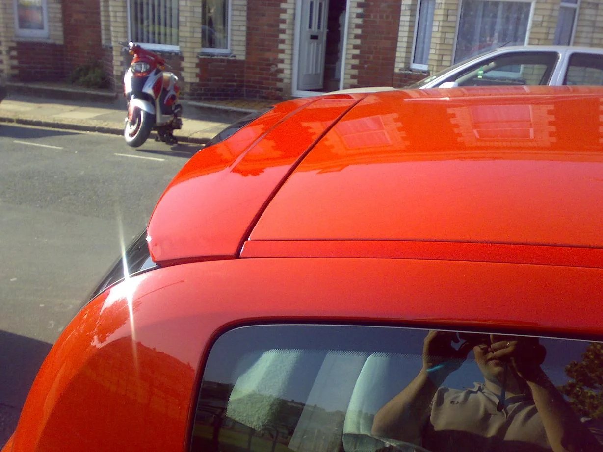

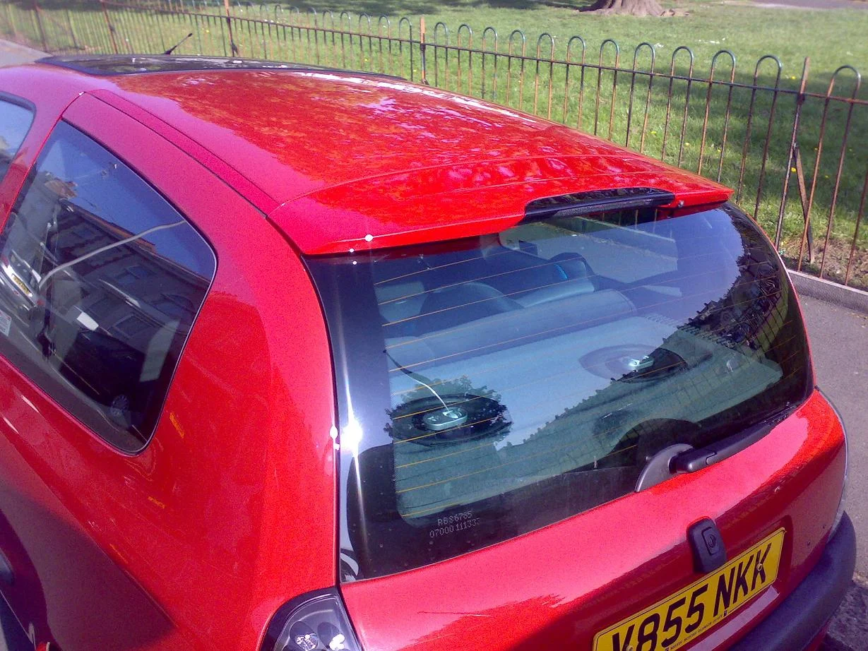

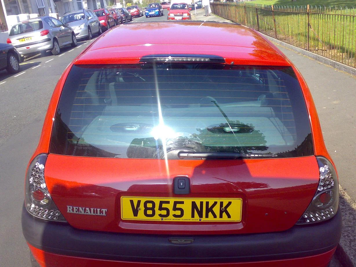

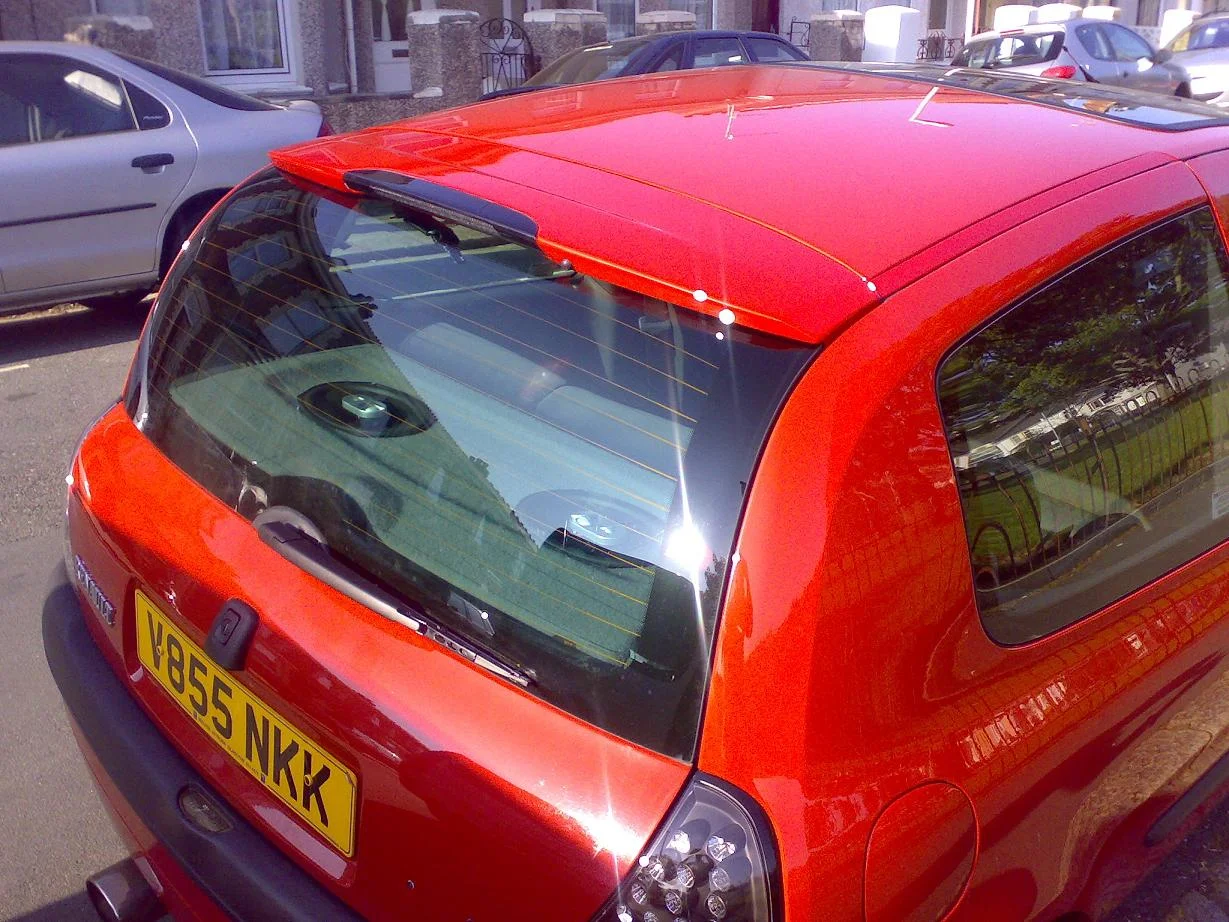

Got my Spoiler back from being Resprayed
Car  Renault Clio 1.2 RN MK2
i was just wondering shall i put merr polish on it of can i just leave it as it is
the bloke did say come back tomorrow and ill polish it up for you

yeah, it looks nice!
but never polish fresh paint. ever. especially with a cutting agent like SRP etc ...i've never used Mer so i don't know if it's very abrasive.
give it at least a few weeks to properly cure and harden. you could wax it if you're gentle and want some protection.

It is fine to polish new paint, chances are it will have been polished after painting. Most jobs need a light flat even on little areas and being polished after.
It is bad to seal or wax it unless advised ok by the painter. Would not use SRP on it though as it polishes and seals. Use a pure sealant free polish unless advised other wise.
If it has been baked properly it will be fine to polish/seal/wax. Ask the painter/bodyshop to be safe.
