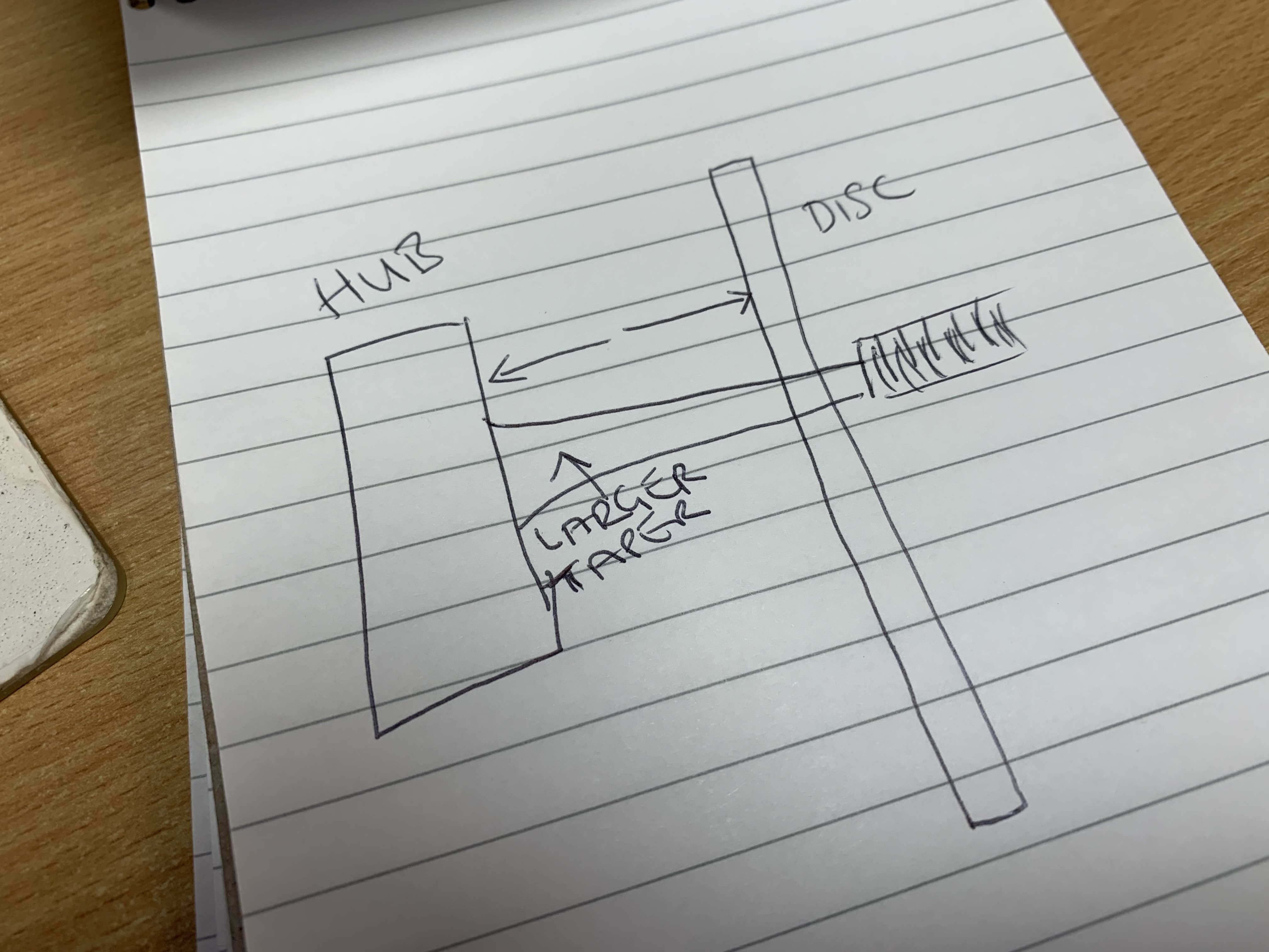

Mr Underhill
Just for the avoidance of doubt, the bottom image should sit towards the car?
Just as the other side still has a inner taper albeit smaller
Much appreciated though! 👍
I can't tell by your images tbh. The larger taper towards the car/hub.
The Flattest side sits against the bearing in the disc if that makes sense.
Mr Underhill
Fag packet illustration 😂
My writing’s atrocious 😱

I hoped that would be the case as it’s the way that makes sense to me! Just want to avoid fitting one way and being forced to strip it down and reverse!
