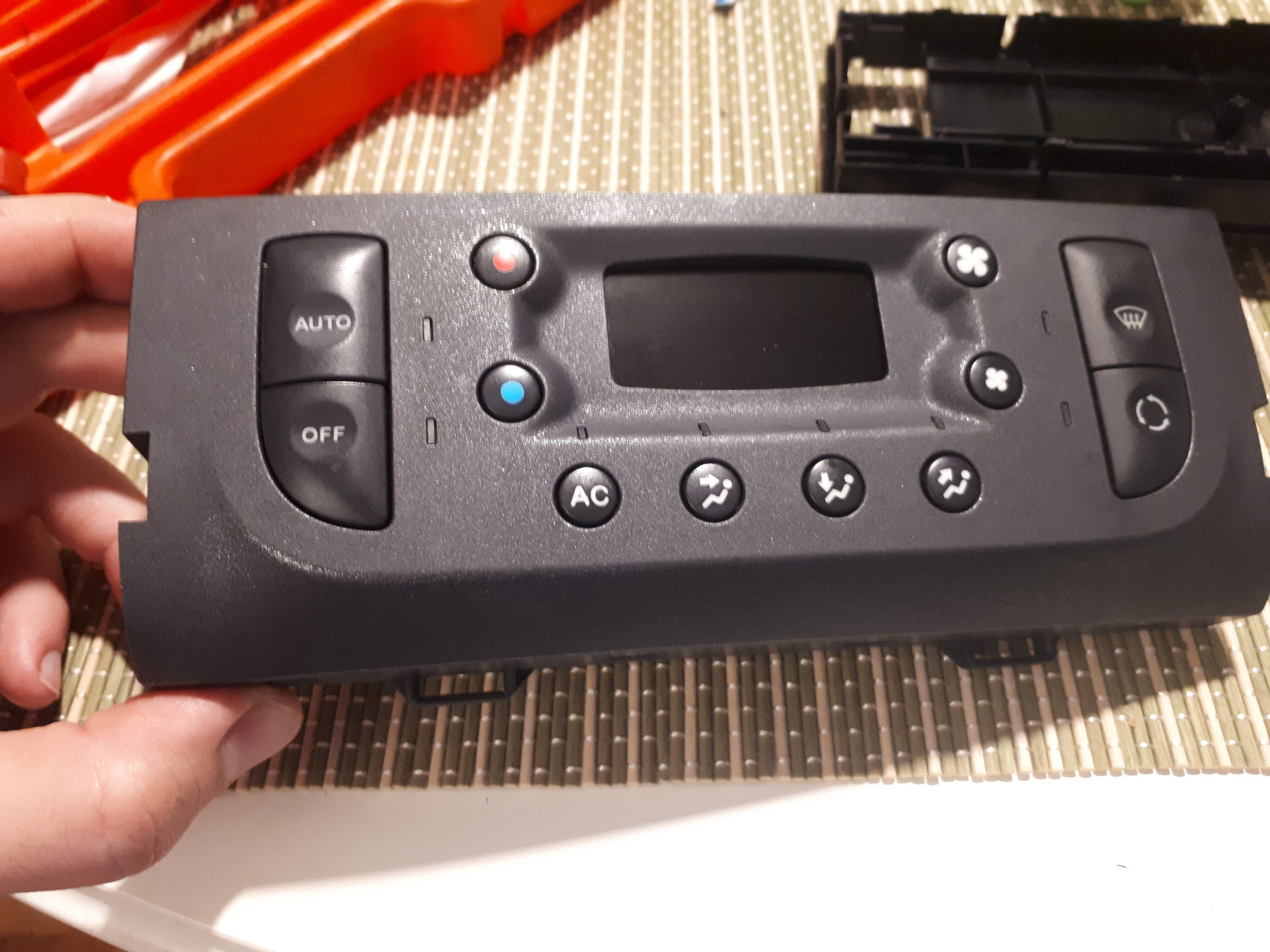

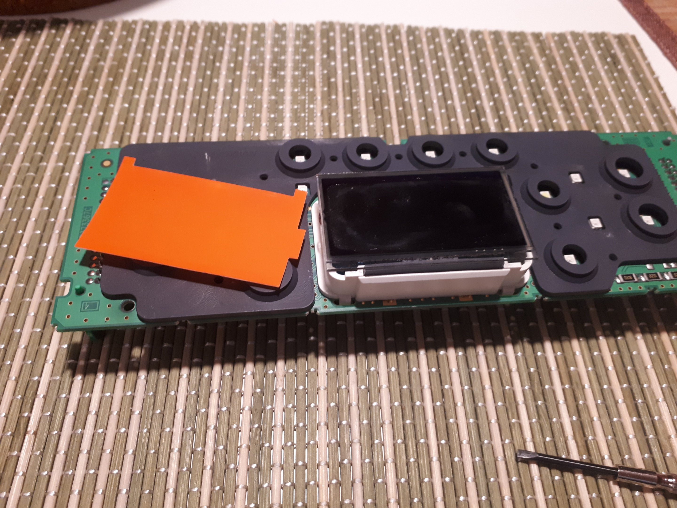

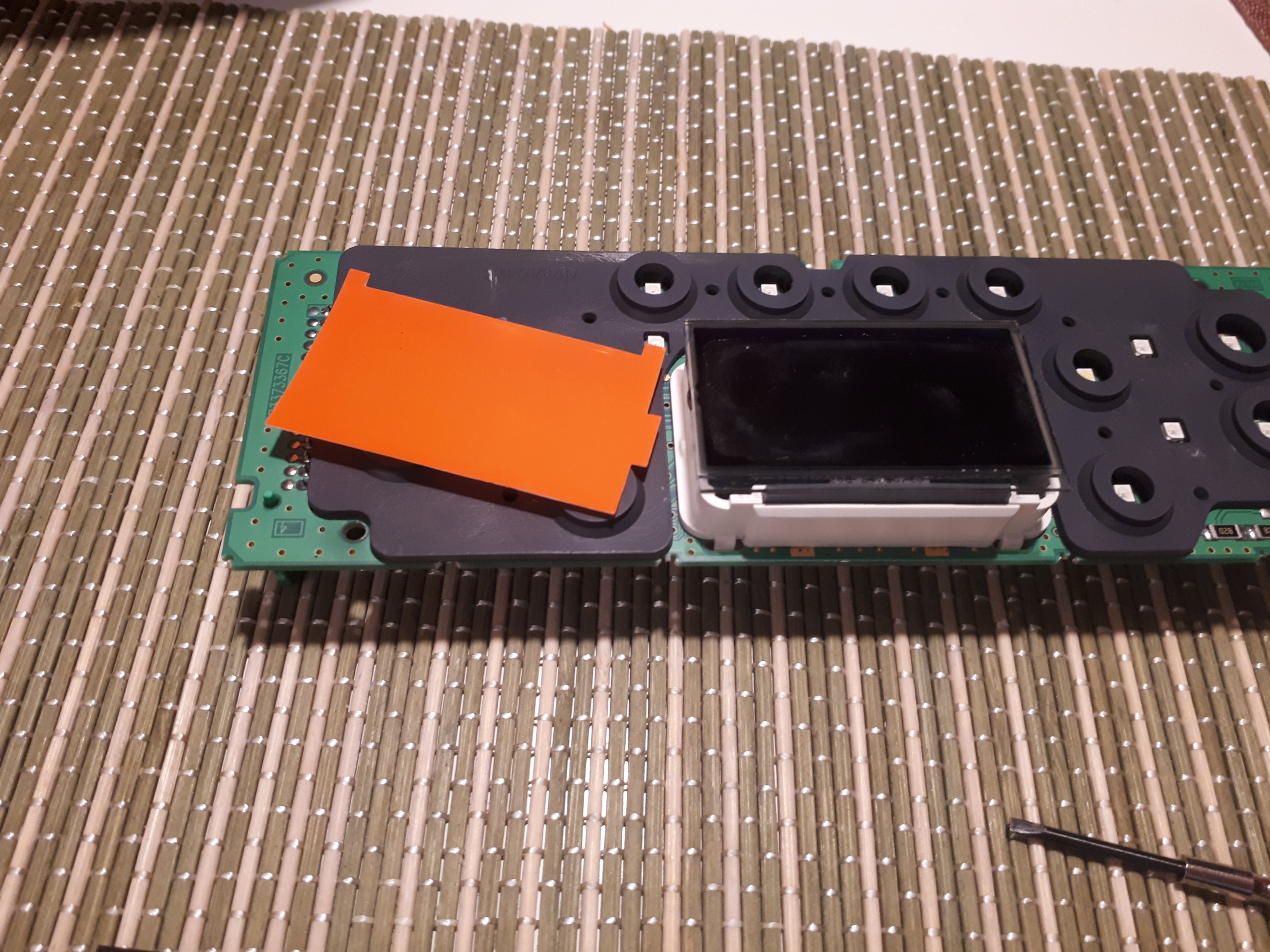

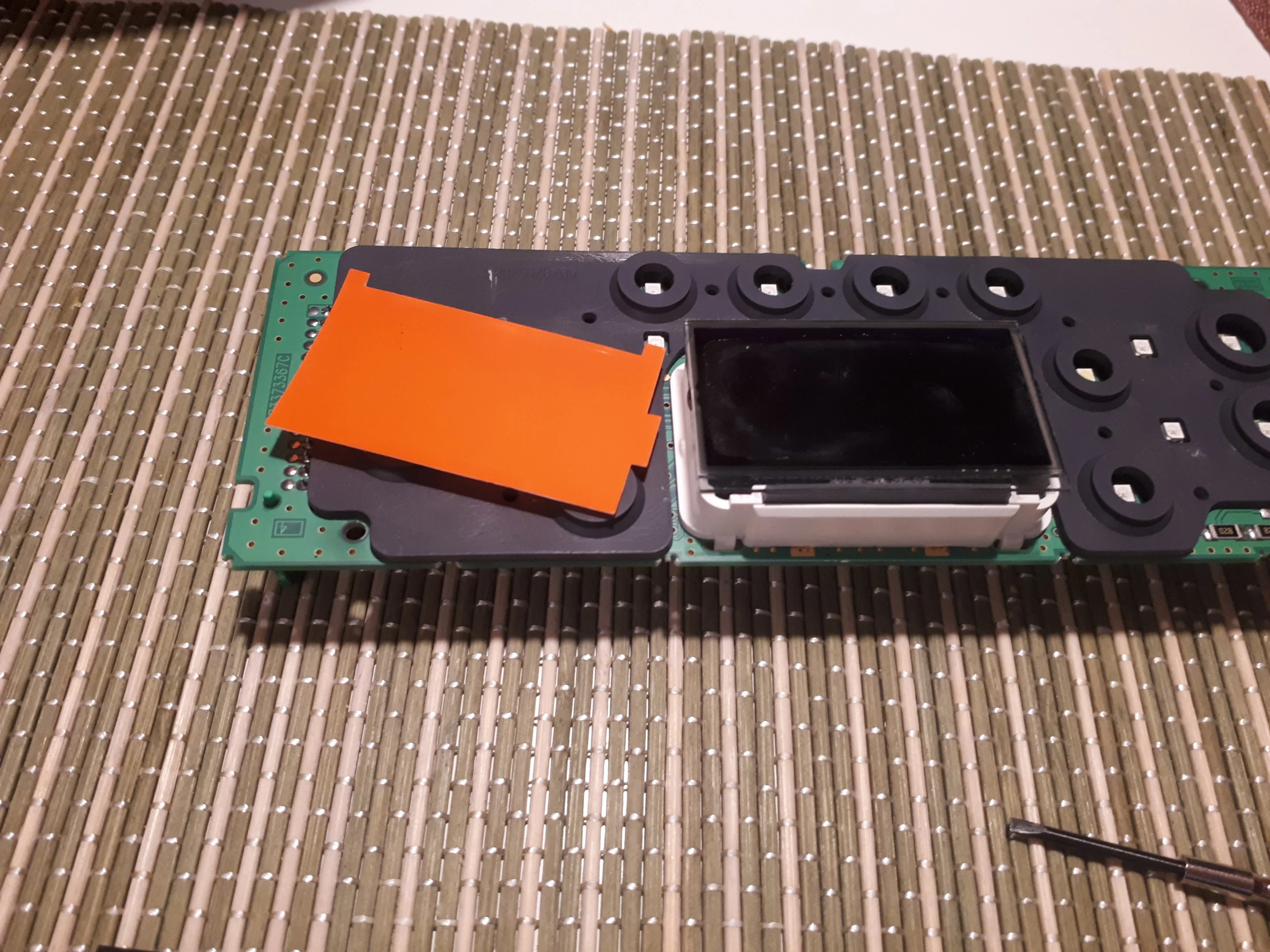

I took apart the AC control box to clean it and in the circuit board compartment I found this orange plastic thing. Any idea where it should sit?

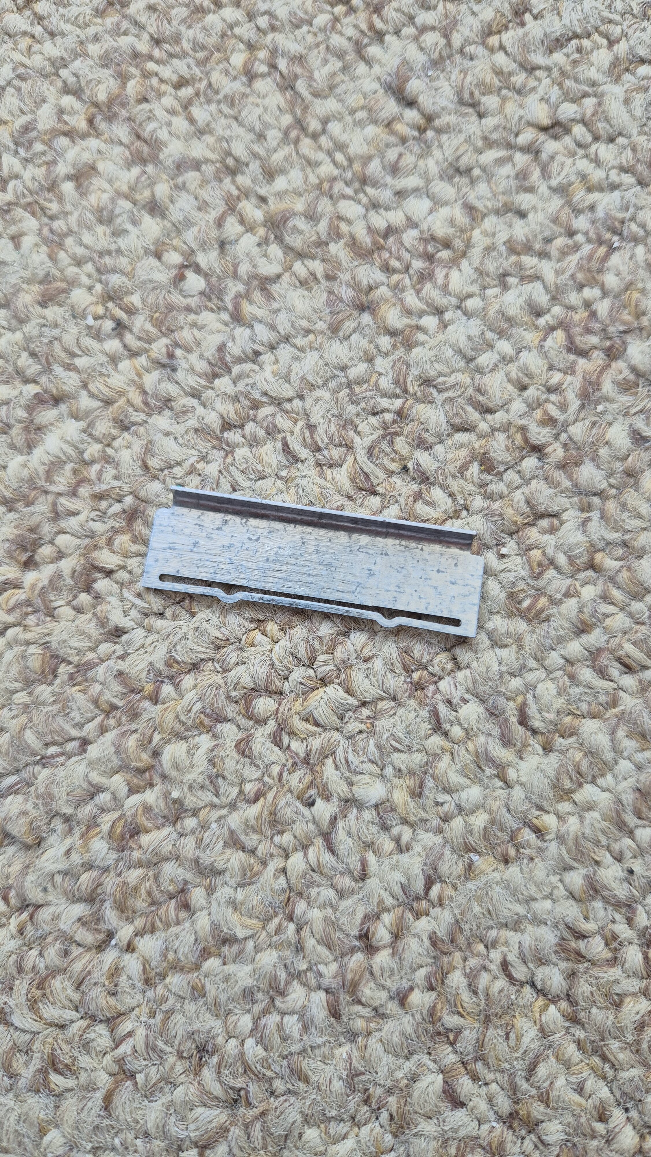

I took the AC panel apart and this little metal piece dropped out but not clear from above photo or from the unit where it goes, any ideas please?
Doubt its related, probably something from an old aftermarket radio cage or similar

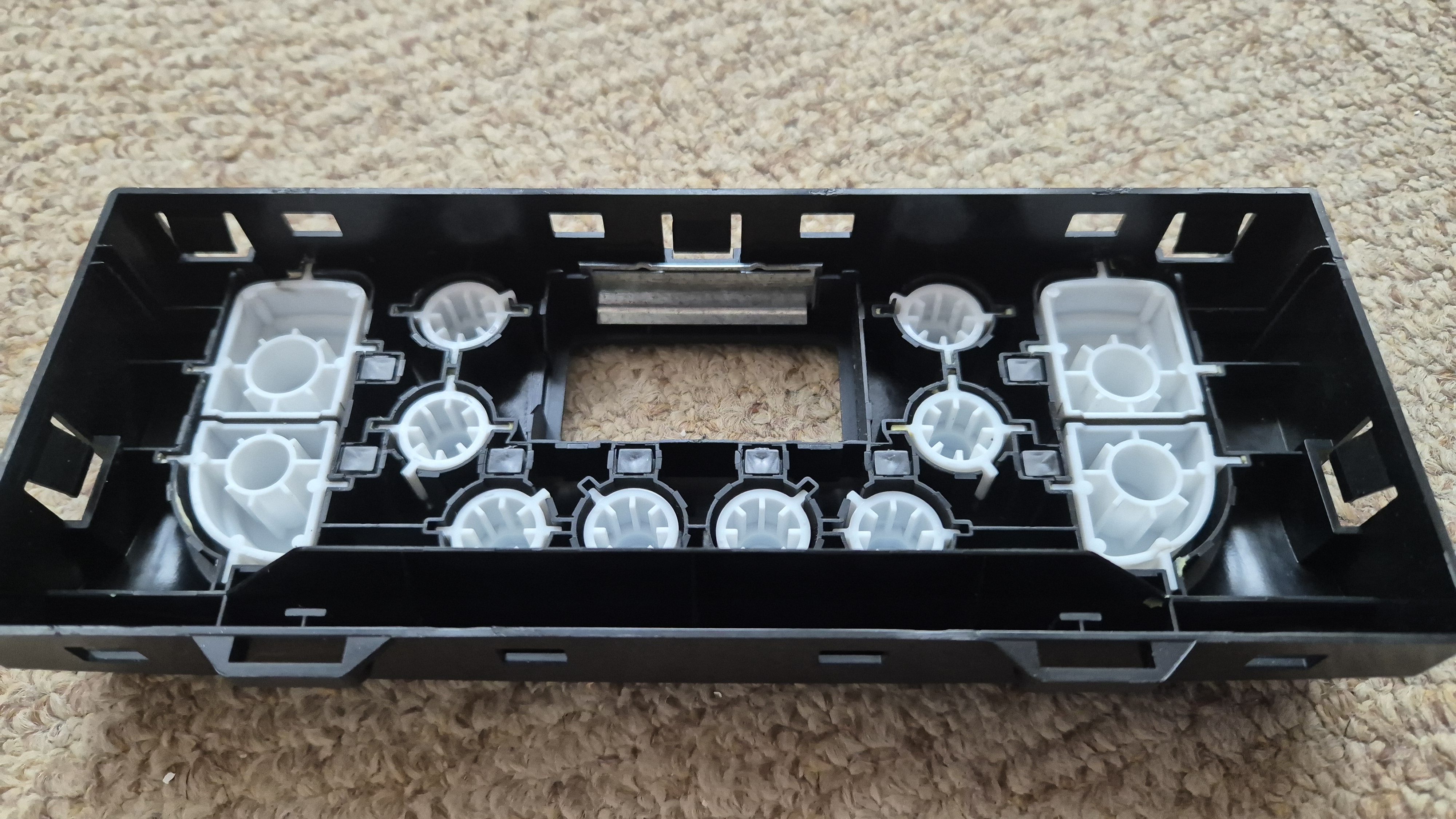

I'm sure I saw that when I took my AC panel apart, pretty sure it goes behind the screen? Unfortunately it was a couple of years ago and I didn't get any photos.
Thanks, went back and took another look. Slots in here perfectly. Looks to hold the screen connector.
Photo for anyone else finding them in this situation. Otherwise very easy to take apart if you are careful with the clips
