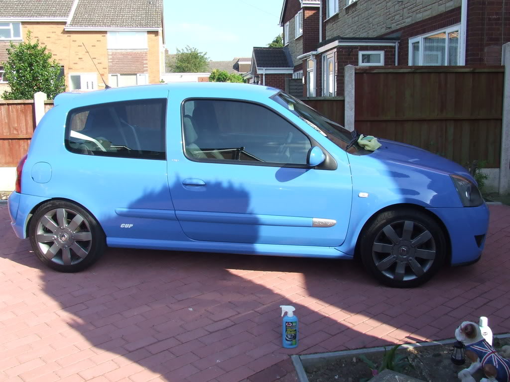

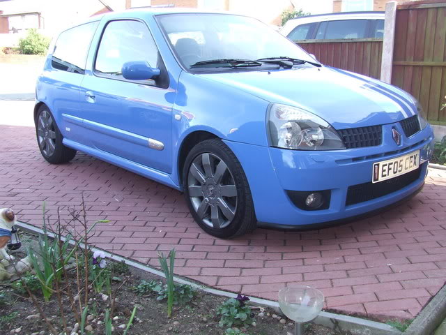

Can someone help me ive got an 05 plate 182 cup fitted with adjustable H&R coilovers but i think that the front is too high but i have not got a clue how to adjust , i know you have to use the c-shape spanners but thats it , mechanics are certainly not my strong point. is there anyone in the area that can do this for me i would be very greatful££.
Heres a pic tell me what you think
yes mate im in staffordshire ill try yozzasport any idea on price, thanks for the info
best to phone yoz and speak to him about price, depends what you want doing.
You could just, measure the ride height, rim to arch, jack the car up, mark the coilover rings turn them down the same ammount of turns on each side.
remove the jack, let the car settle (push back and forward) and measure it again. its very easy to do. Keep going untill your happy with the way it looks, getting both sides level is really hard without a flat floor
