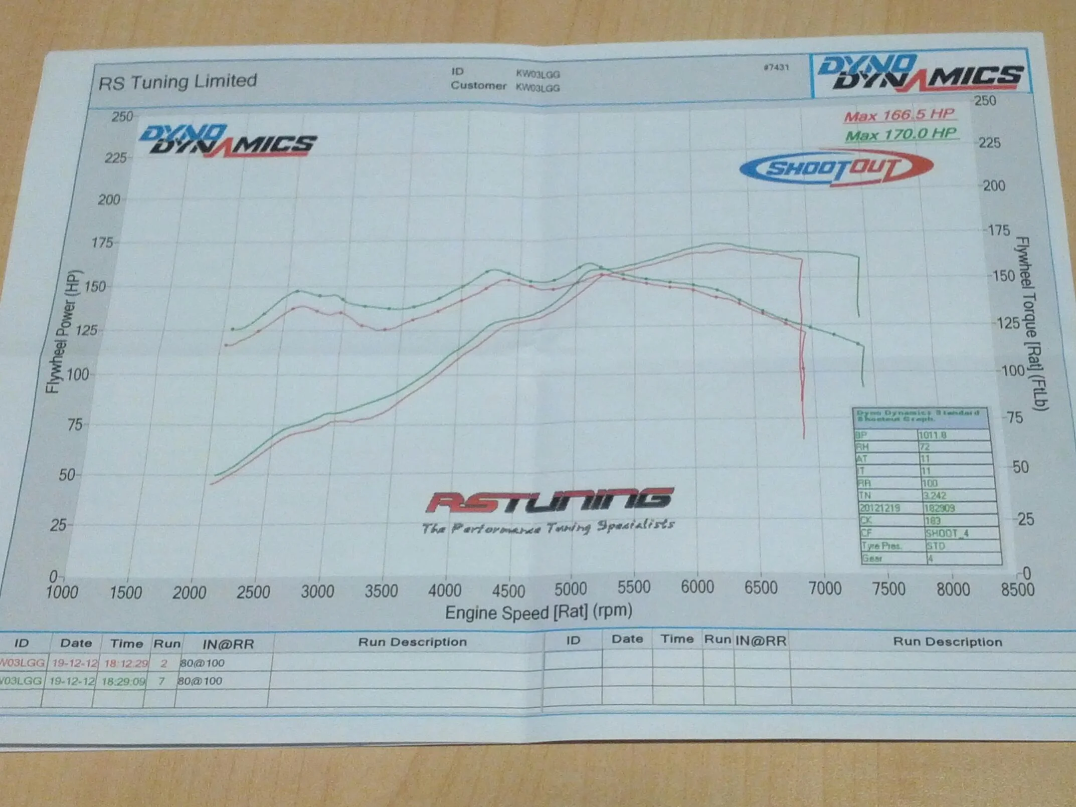

Had my 172 cup remapped at RS Tuning on Wednesday night.
When I bought the car it had a Dyno Dynamics Rolling Road graph from KTEC racing noting 162bhp - totally standard car.
After purchasing the car I fitted a straight through de-cat, the car has no other mods at all (standard exhaust etc).
The first run at RS Tuning (also Dyno Dynamics) produced 166.5bhp - which either shows a big variance between the RRs or the de-cat added 4bhp? :)
After about 20minutes Paul had finished his mapped at the car produced 170bhp exactly, or 140.3bhp ATW.
The graph shows the differences before and after. I know the numbers haven't grown very much but I'm all about how something drives not what the end figure is.
The car feels so much more responsive to drive and generally has more 'get up' from any gear - I can't wait to get out on some dry roads with it.
Very happy with RS Tuning , would recommend them :)

figure seems low IMO but if it feels better on the road thats what counts.

Glad you like it Dave :)
Why ouch?
Because it's not making 10000000hp from a simple remap like some quote?
Lol. No I'd rather of paid someone half what you've charged this chap to upload an RSTuner cal file to my car, as that's all you've done pretty much? Would of had similar gains with that also.
Dave - If your happy with it then fair enough, a little research would of saved you a few quid though.

How's loading a GENERIC map the same as having a car mapped on the dyno? I did 6 files for this car before we came to this result with the chunk of midrange torque and disabled the second 02 sensor.
Sir_Dave
ClioSport Trader
Is there really much point doing all that to add 3.5bhp though?
Genuine question btw, surely from your perspective if would be more profitable to just upload a generic map lol.
RSTuning
  R35 GTR
Its not all about the end dyno graph only showing gains at WOT, it's about how it picks up when you initially go for it, midrange cruising and how smooth it is.
It's very rare that i have put a final map from one car onto another car and it be the same.
So yes there is every point

I've had generic maps before on previous cars and suffered because of it.
I trust Paul and would not have considered going elsewhere.
6 files in 20 minutes? You were with my car hours calibrating it Paul. Tbh it's not even the fact of whether you custom mapped/loaded a previous cal file from another car and tweeked it/etc or not, it's that for half he price he could of had similar results with ease. Even if it made two horsepower/torque less, you wouldn't notice that and would of saved himself a few quid.

Yes 6 files in 20 minutes, they take seconds to load to the car and changes are quick to make in the fuel and spark maps.

I had a very similar experience to the OP. I made 172.8 before and 179 after. More mid range torque and it feels allot better than before. I know I could have bought a second hand RS tuner and got it done cheaper, then messed around getting it unlocked / buy the correct map ect ect. could I be arsed? No. Spend abit more, get a before and after and a dyno map.
