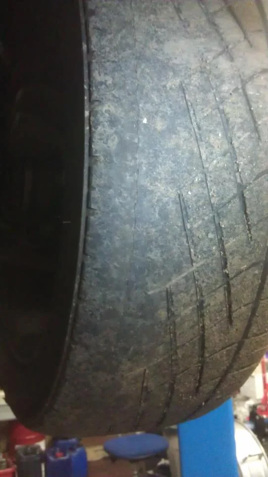

205 GTI i bought had 5 degrees of toe out. Drove it home from Bath. Tyres were legal when I left (only had a quick check)
when I got back to Bedford.....
It would be interesting to set the tracking at -1, zero and +1, see how differently the car drove and what tyre wear was like over 1000 miles!
1 degree toe in will make it feel a bit understeery, 1 degree toe out will make it feel more twitchy and more keen to turn in, both will marginally increase tyre wear over a more parellel setup.
