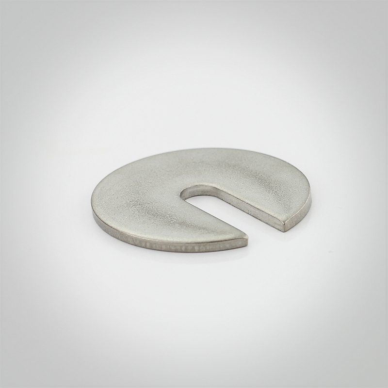

Ok hear me out. The handbrake on the passenger side is working fine, so presumably adjusting the handbrake using the adjuster under the exhaust heat shield will result in the passenger side binding. The driver's side is pulling the lever, but obviously not enough to actuate the handbrake fully. What's to stop me just throwing a slotted washer between the cable and the lever on the driver's side to effectively shorten the cable/increase leverage on the lever? :unsure:
R3k1355
That'd work if one side is slacker than the other. But if it's a problem with the caliper, it'll only have an effect for so long, till the cable stretches out and it's back to being poo.

Well I just replaced the caliper with absolutely no change so I'm guessing it's the cable being too long
