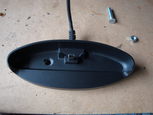

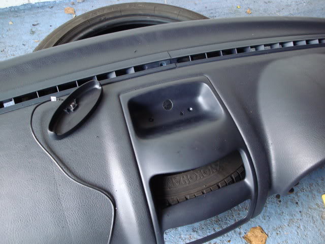

So my brother came up with a smart idea - Mount it on the desk stand in one of the dash board pockets, so with the plan in mind i sat around for half an hour trying to work out the best method of instal that would involve no long term damage if i ever need to remove it all... with it all thought up, work began

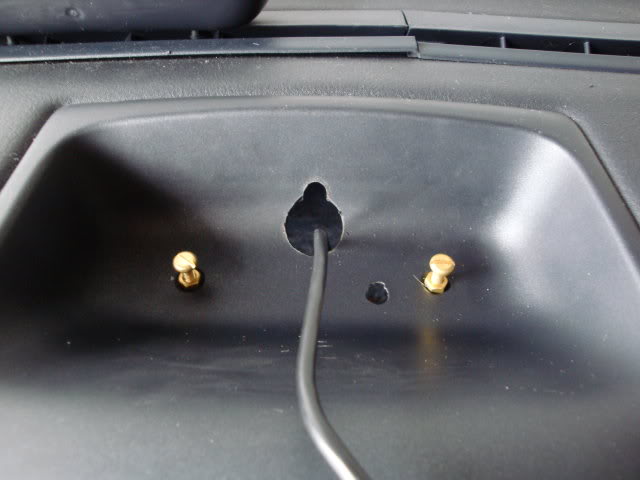

First off, remove the upper part of the dash, pull the rubber pocket liner out and send a 20mm holesaw through the back of the dash, low enough that if the rubber lining went back in it would cover the hole
Next, clean it all up and make a hole for the cable to sit in, also added a pair of M4 screws and bolts so the height could be adjustable

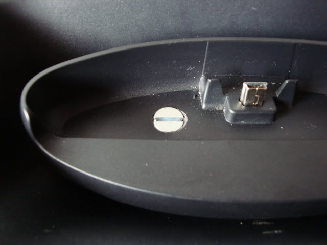

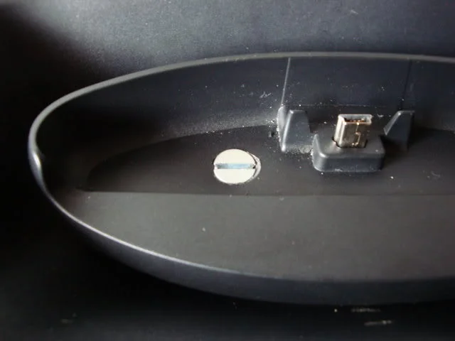

Now for the 1 day old desk mount to recieve some love, 6mm hole, countersunk

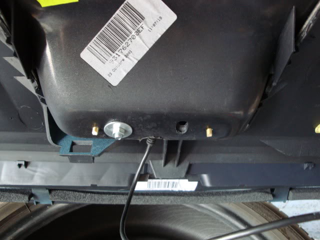

added a counter sunk 6mm screw, bolt & few washers to clamp it all down with
Shot of the underside

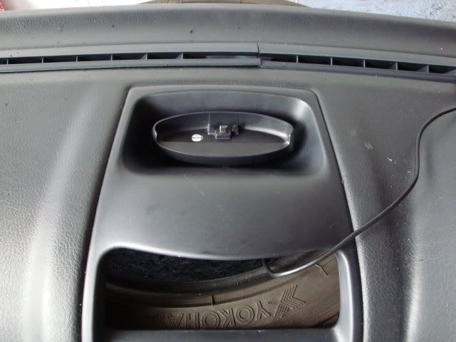

All ready to go back in the car

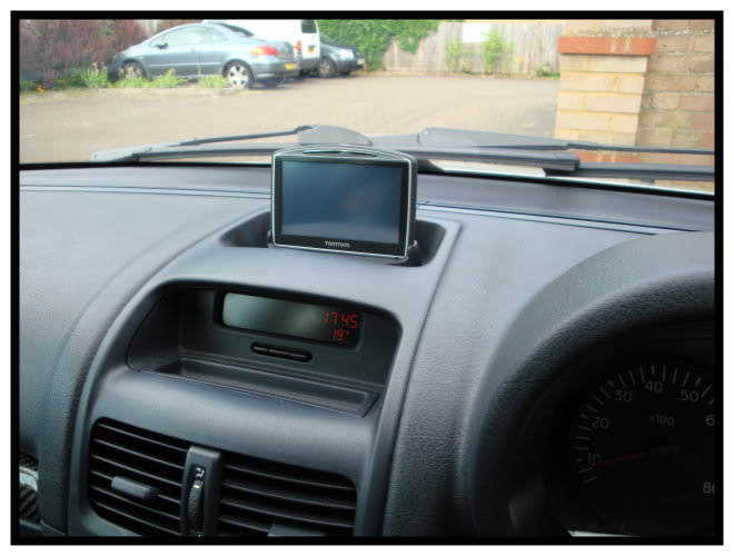

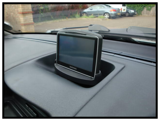

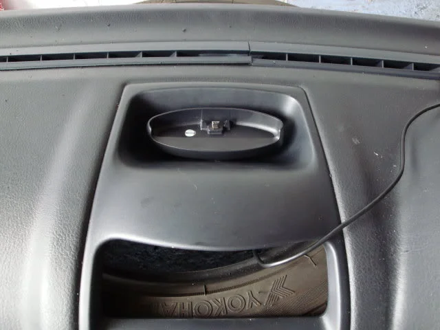

With that all complete i managed to find a good route for the power cable straight down to a 12v source, so bolted all the dash back in & did a quick trial fit, the result
No cables, no sucker, no mess ;)
