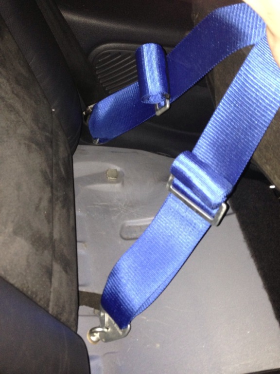

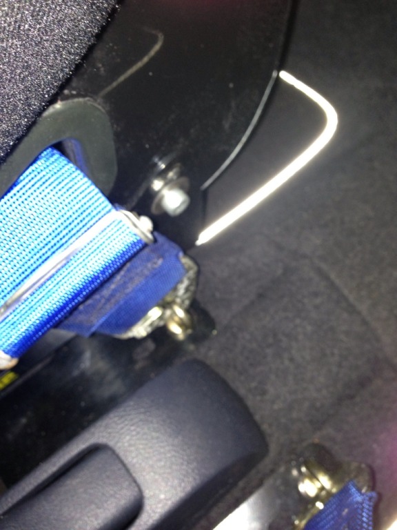

Got my harnesses delivered to day and cant find a good place to fit the lap straps, just wondering what you guys have done and any good suggestions as i cant find anywhere to fit the inside one nearest the hand brake ???????
If you have d clip type harnesses then for the centre point as said a long eye bolt and nut underneath where the original seat used to bolt trough.
FYI the outer lap belts on the b pillar can be secured with an m10 eye bolt through the original fixing point and the rear two with 7/16 UNF eyebolts through the original rear belt fixing points (not ideal but its the only good fixing point on a standard car without a cage or a bar welded in)
