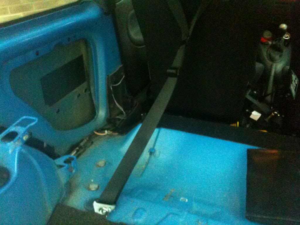

Fitted some 3point harnesses and was wanting some opinions of where i should fit the rear harness clips until i have enough money for a cage.
Currently have harness eyes screwed in the rear iso-fix holes

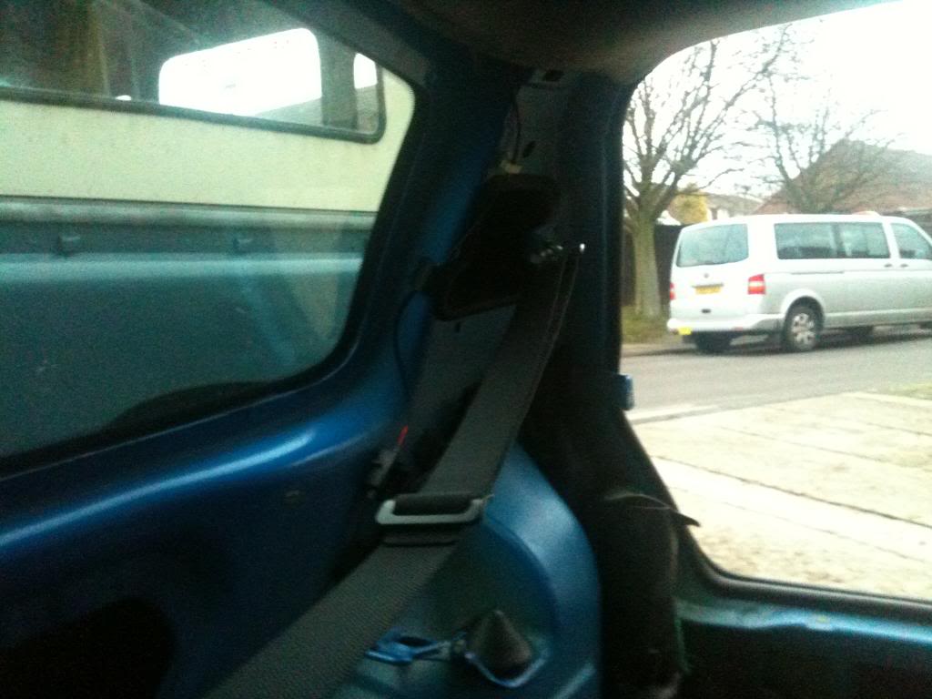

but read a few threads saying its the wrong place to fit them and have seen a few people mount them where the upper rear seat belt bolts to show below
Upper seat belts is the best place.
The sear seat belts point in a crash could kill you as they would compress your spine.
