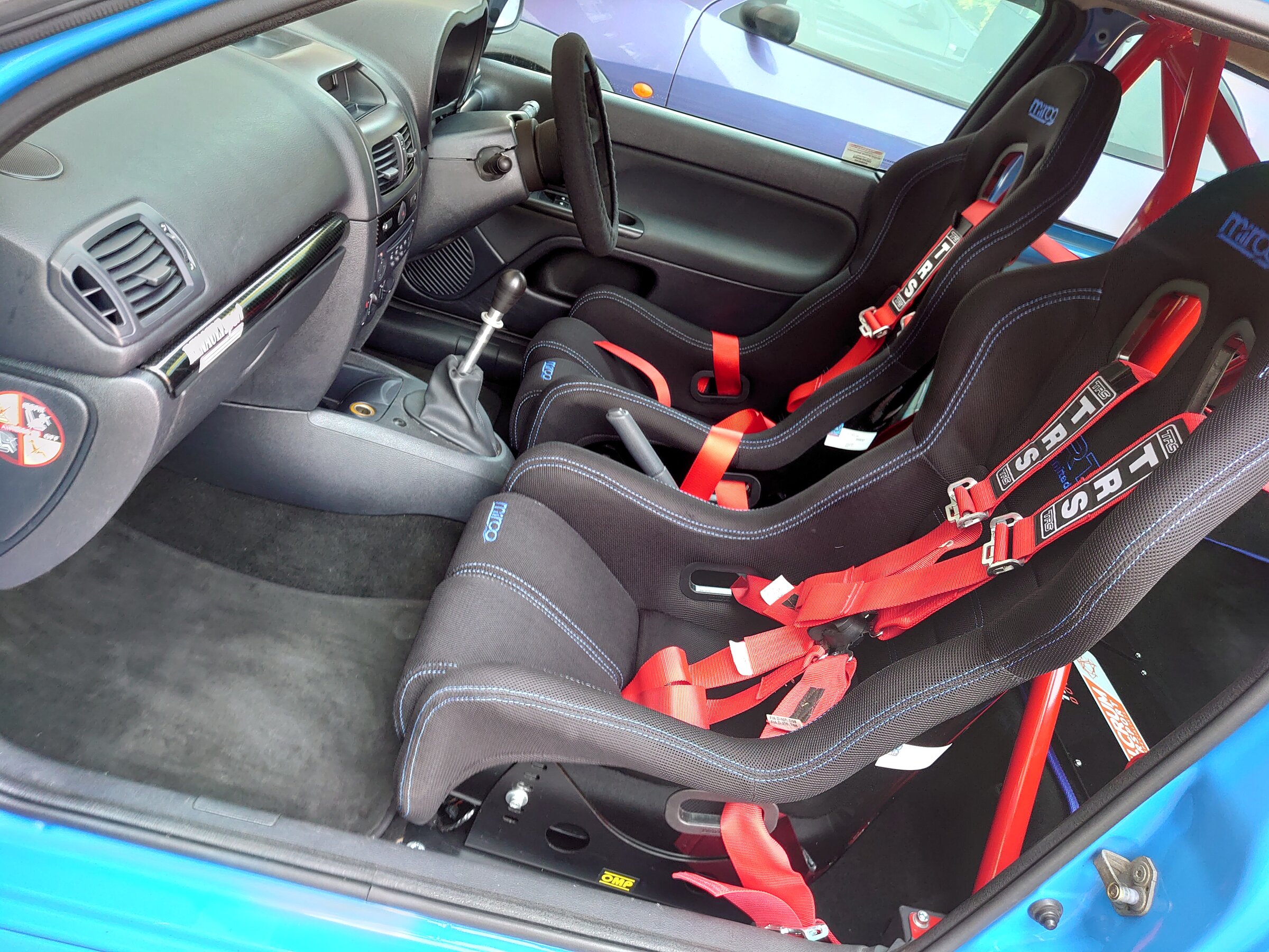

I found trs to be good value and quality. They do a 3 point with seatbelt buckle if it's mainly road use

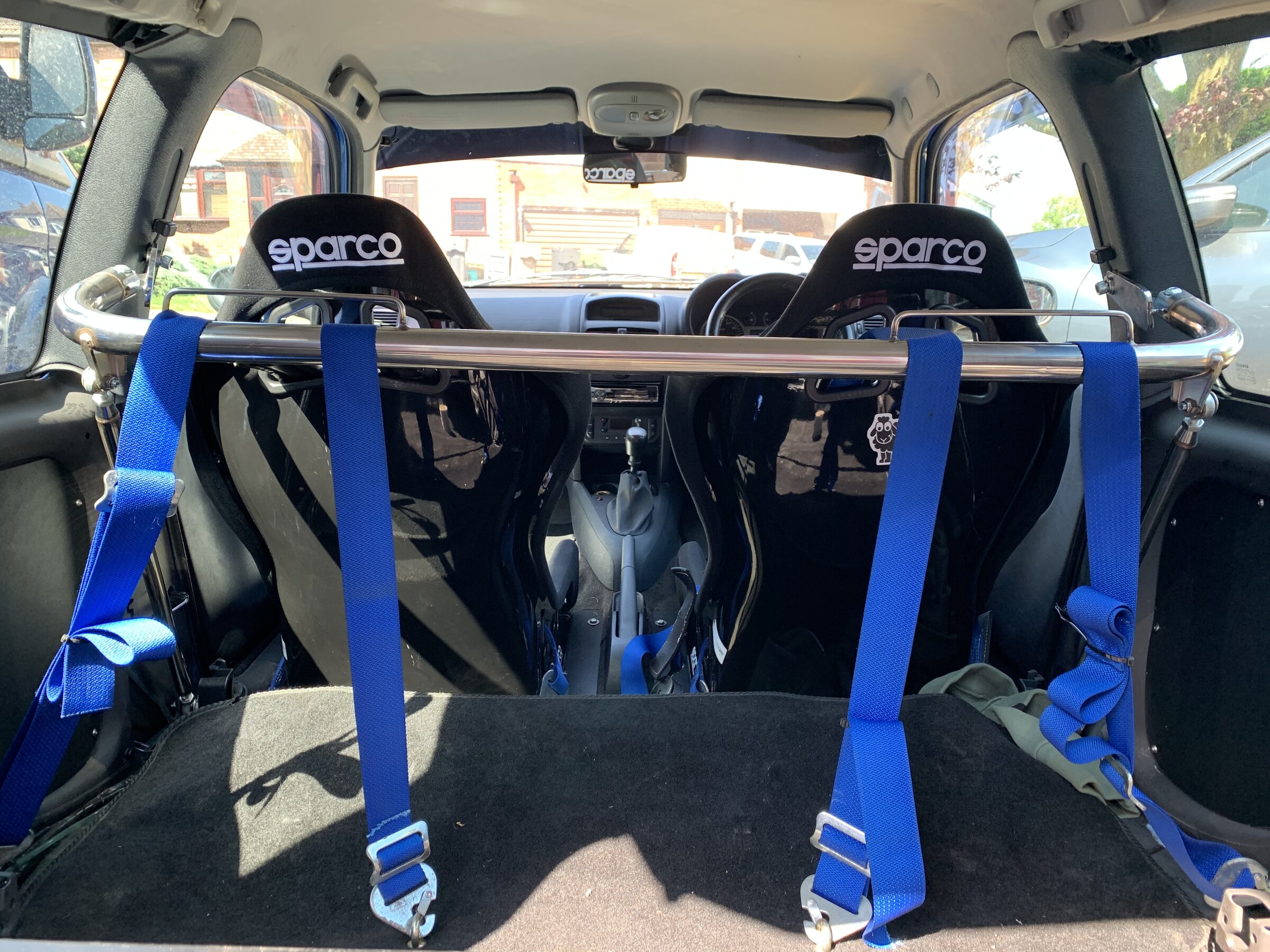

I’m not experienced at all things Track day cars (just picked my Clio up this year) but, Recently fitted a “unuversal harness” bar to sort the angle of the harness’s, it’s not cheap, but it’s good quality and from a reputable source (Tegiwa).

Seen a few of them snap or bend in the past so I definitely wouldn't feel safe in that :o
Also learn how to roll your excess harness properly :P
Personally a decent half cage for around £550 is a safer option. Especially if being used on track

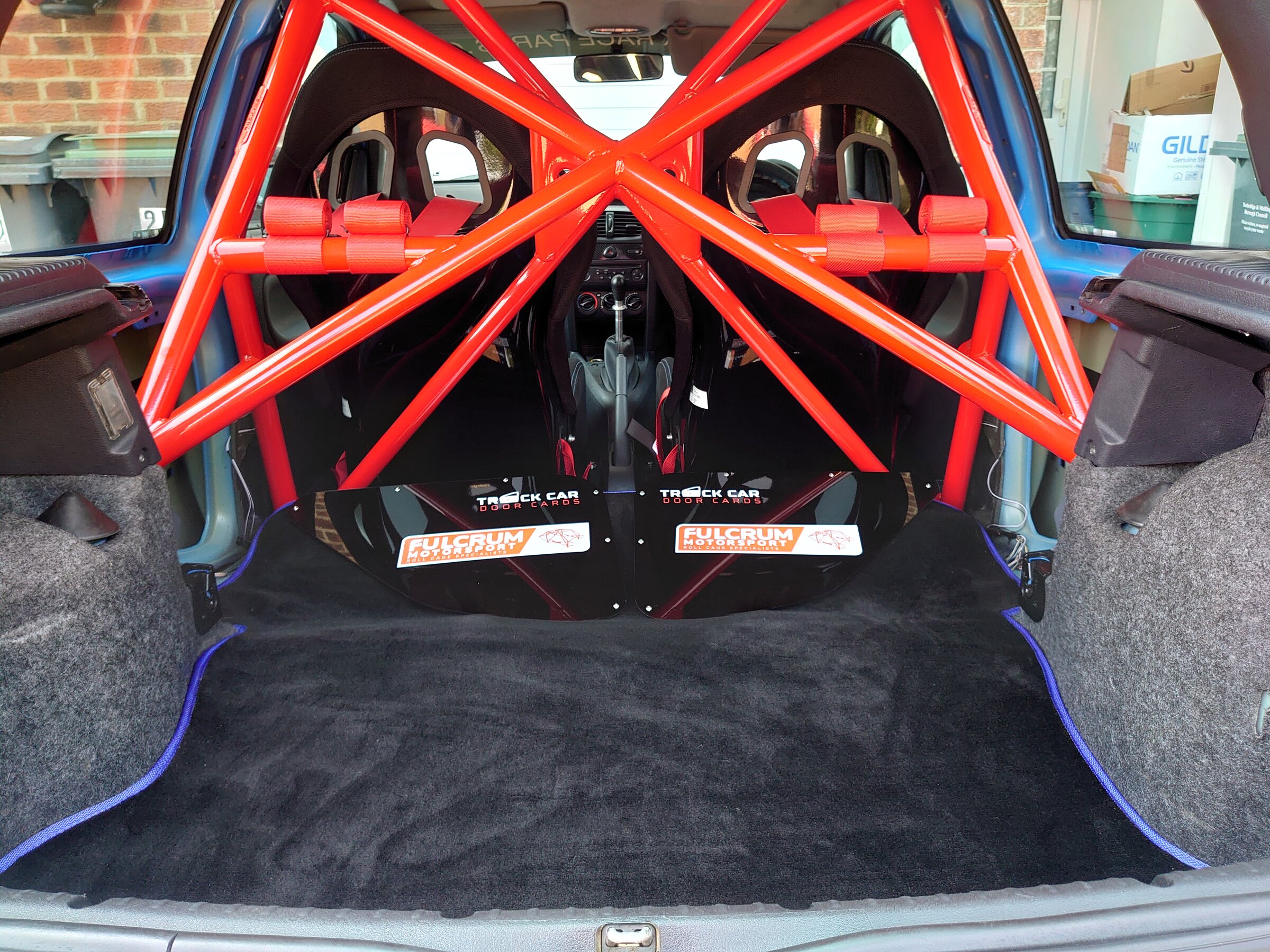

Yeah I just had a great chat with Mark Fisher motorsport who use safety devices and think I am just going to go for a race spec half cage which can be converted to a full cage at a later point - safety first!
Safety devices and fulcrum both do the rear cages ready to add front at a later date. Both really good cages
