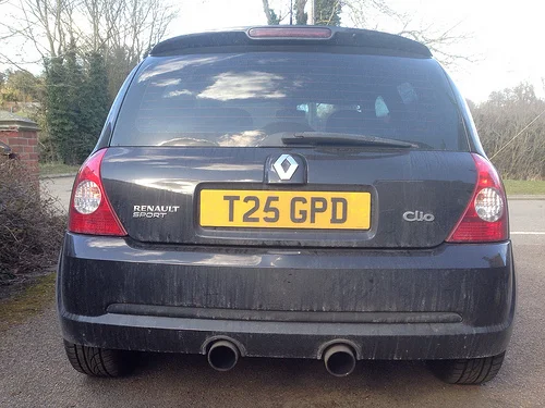

Firstly the exhaust started blowing, so I chopped that in for a scorpion rs192 - which has been great tbh and I didn't have half the fitment issues that most people seem to? Then, one of the welds on the catalytic converter started leaking - after welding it twice I decided to replace it with a scorpion de-cat.

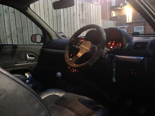

I have replaced the standard steering wheel with a Sabelt one, which has been modified by me to keep cruise control.

Scorpion RS 192 (with de-cat)
