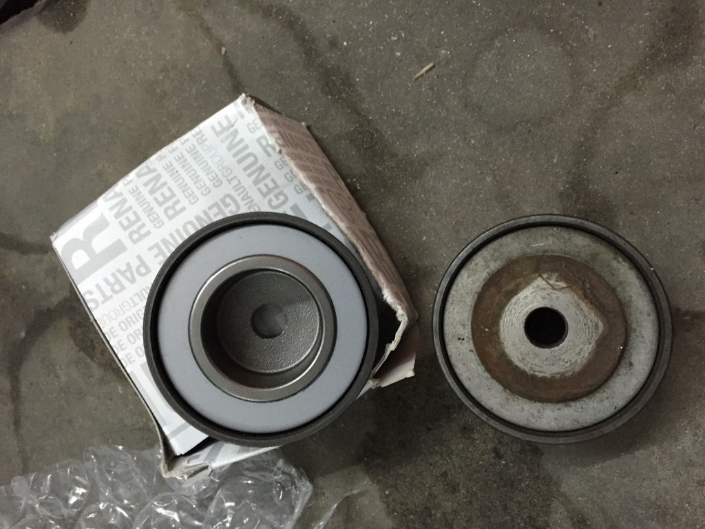

So i looked at Renault manual and they request to use tool which I didn't had so i used something that fitted correct. Pushed for release the tension. No go. Push with lever. No go.Push again with lever and one more friend. Tensioner socket broke.

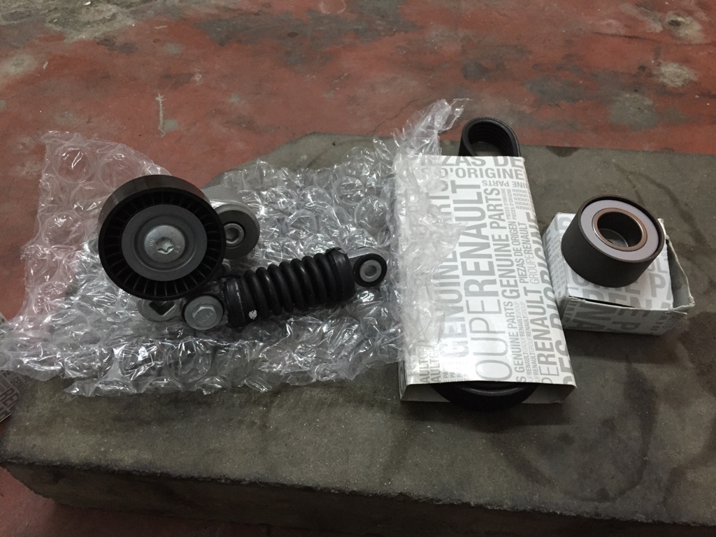

Removed the the tensioner and compared it to new only to find out that the bearing inside the tensioner was stuck from rust.( genuine oem btw). Thats why it needed so much pressure ...
So i finished replacing aux belt kit, thermostat seal and thermostat housing gasket.

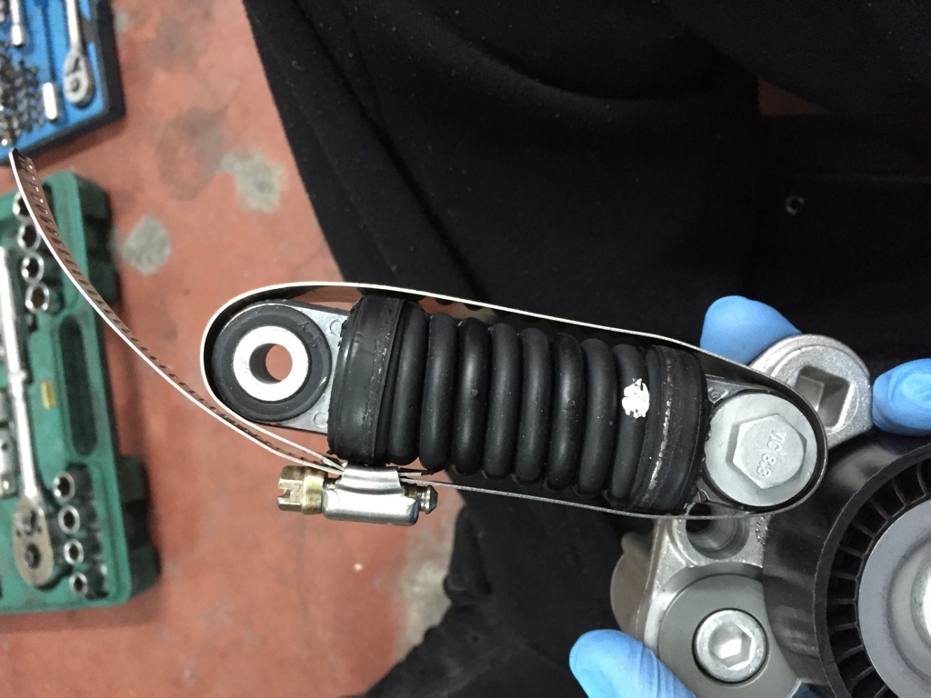

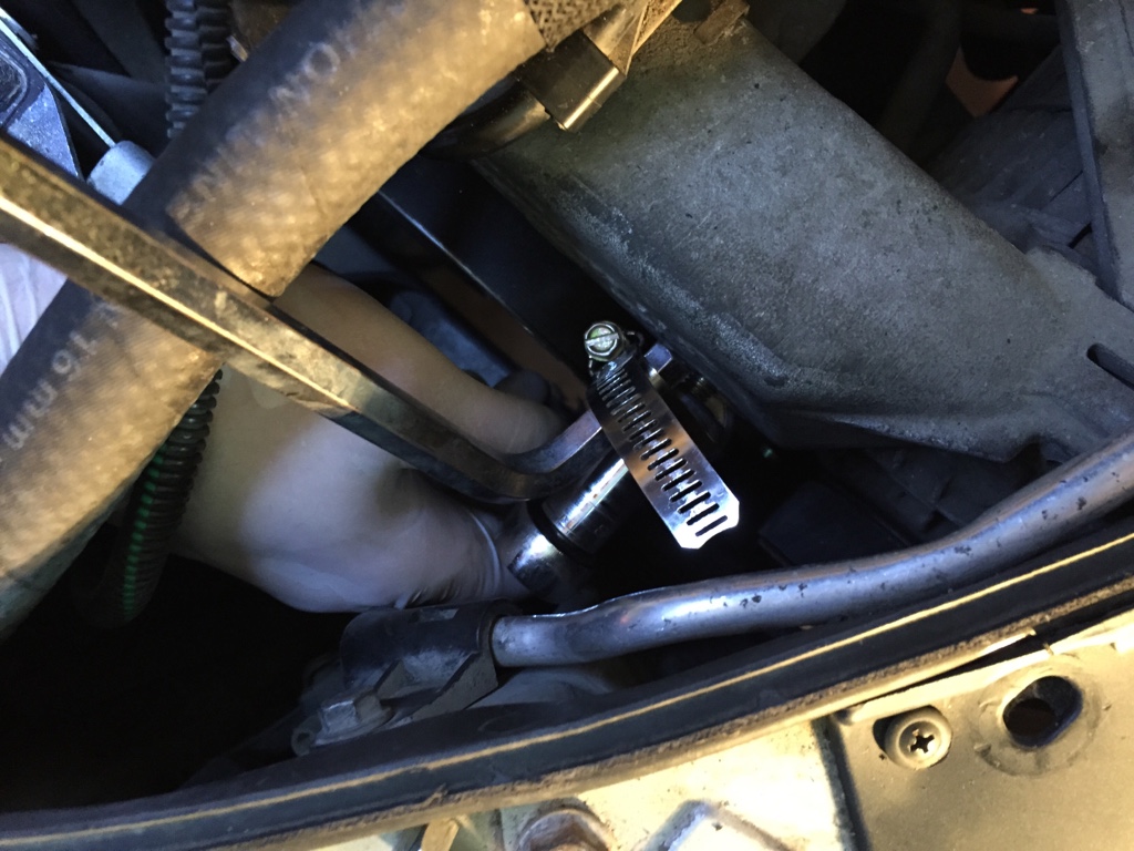

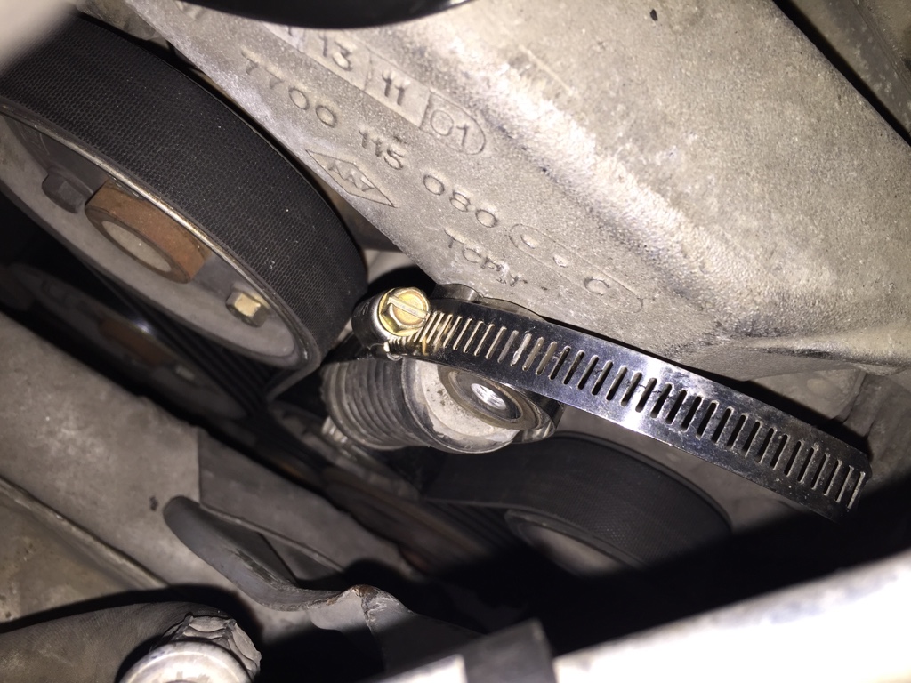

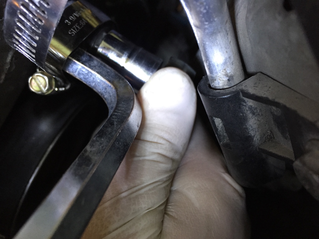

Here is the jubilee pic View attachment 119833View attachment 119834

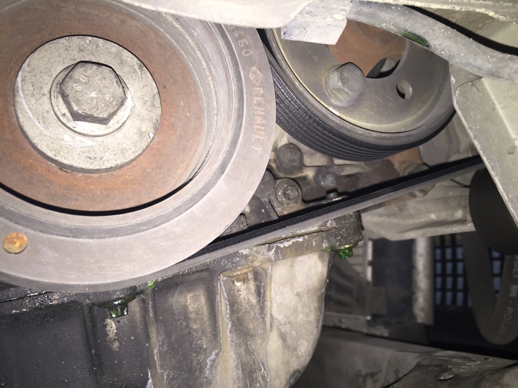

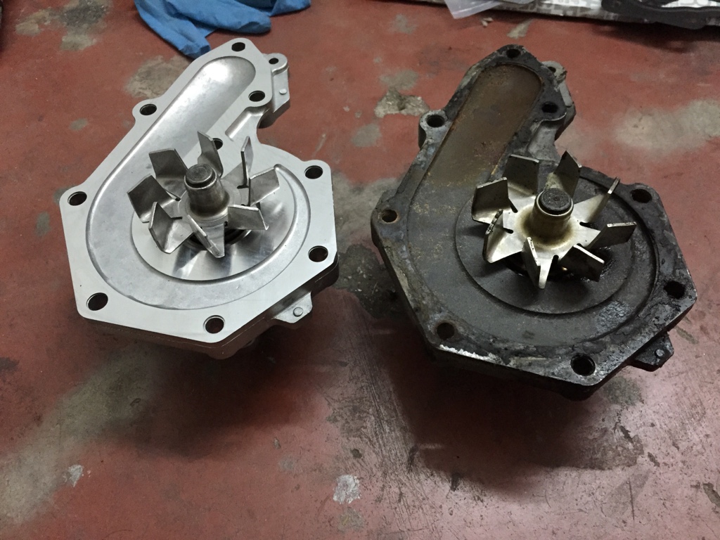

It released the tension a bit so i removed the belt, the pulley and the water pumpView attachment 119835
These are before and after photos: new vs old water pump( the leak was from the water pump was from gasket- the pump is appear ok)

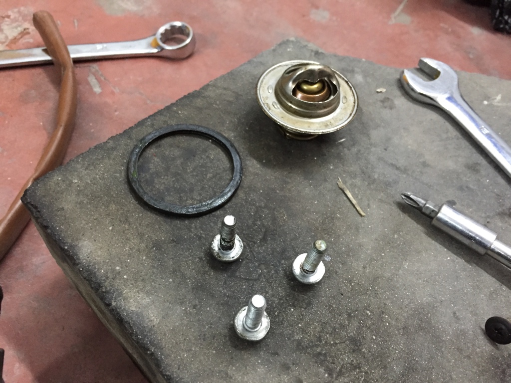

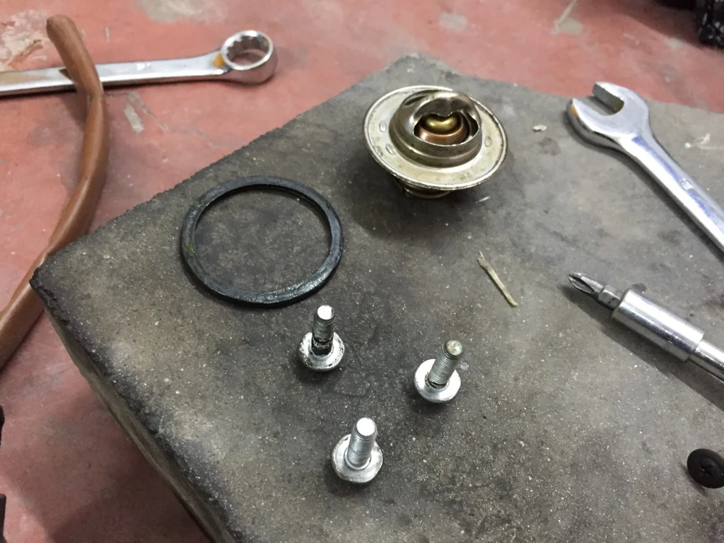

Replaced the thermostat gasket and the thermostat housing gasket :

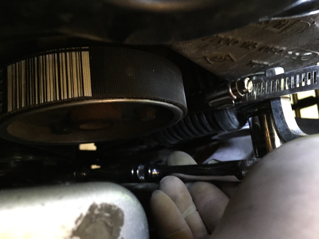

First try with jubilee, didnt went well due to rust.
The thermostat gasket

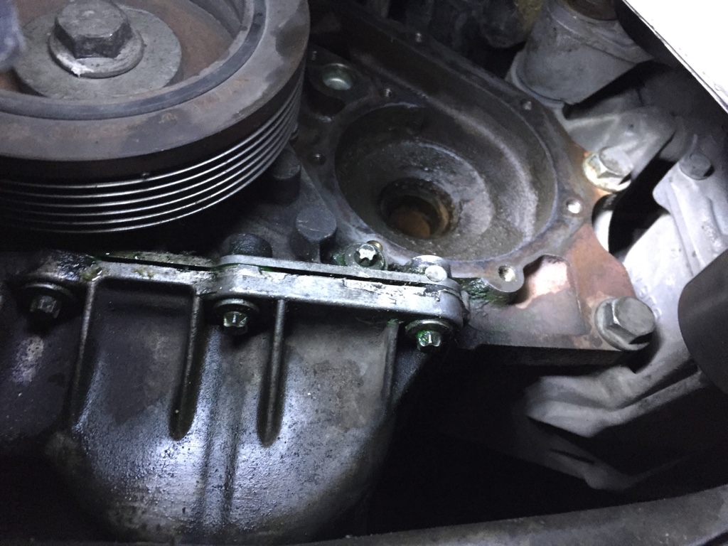

The water pump place on the engine block
Water pump: old vs. new

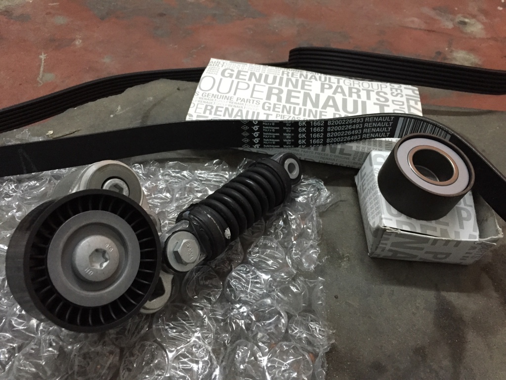

The new OEM parts
The jubilee clip on new tensioner when fitting the part:

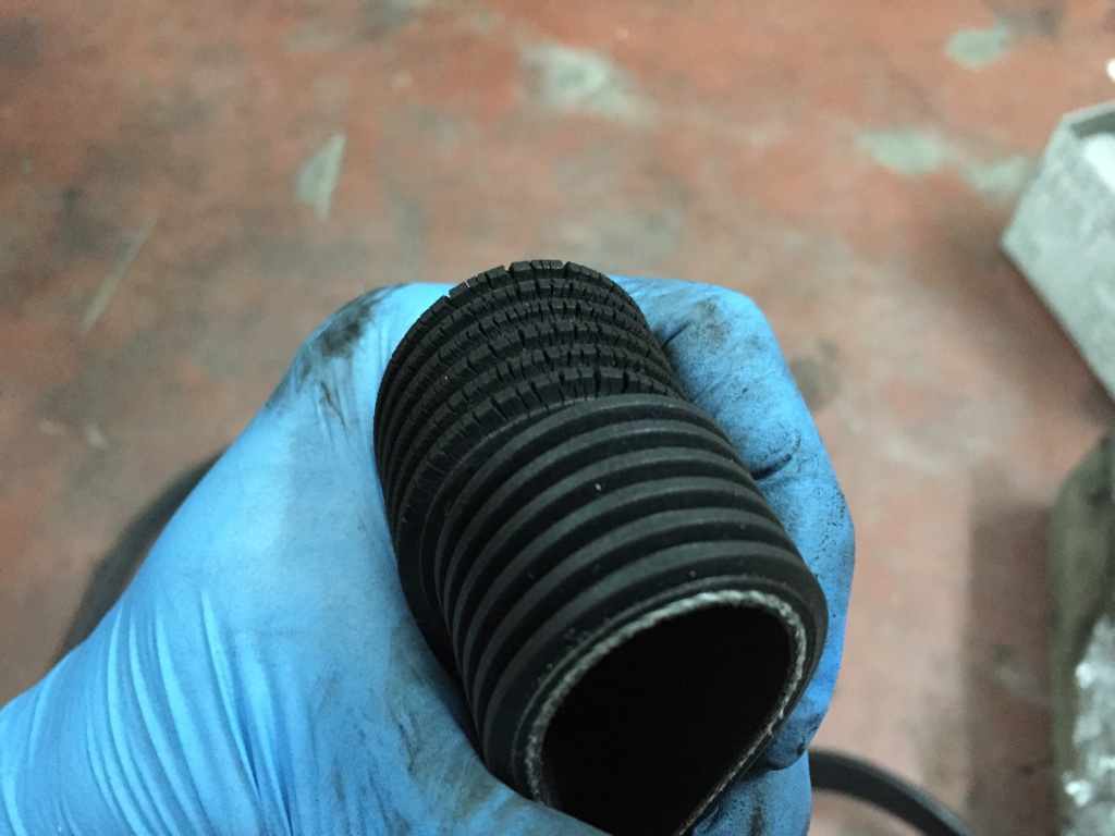

Aux belt. Old vs. new
