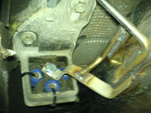

Also suggest packing the Renault mount with hoses and cable ties like this:
  Clio 182
I was using a modified bracket, and cable ties with rubber opiece in the middle, but didnt last long. By the way my box is the oval one.
But finally todays mod by powerflow looks very strong. Its got three new rubber pieces and two hangers which has made it very stable.
