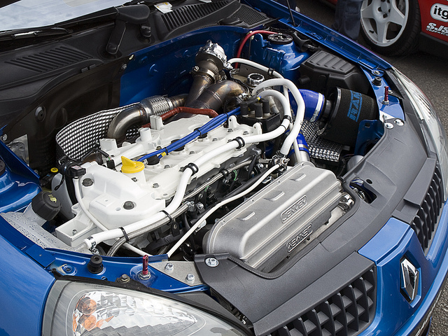

The ITB's are modified with the butterflies removed and sealed for boost pressure, and a single throttle fitted to the jenvey inlet, and defo forged bottom end ;)
  Ollie's Silver Cup
iirc, it's 'bodies with the butterflies removed.
The spec/photos/info is on k-tec's website, under projects.
The car was at FCS; looked a serious build!

That simply looks like they wanted a higher flowing plenum based intake manifold and bizzarly the jenvey plenum + TB's was possibly the best value way of doing it.
  Astra GSI, 172, Golf
i can see why they did it , based on a marketing ploy.. to show what they are capable of. but tbh search many car forums/ projects and you will see bigger and higher powered projects being taken up by unprofessional's in there garage's etc.
also why they ran itb's rather than a custom plenum boggles me.
  ITB'd MK1
they're not ITB's really, they've had the throttle plates removed, so they're just runners. The Jenvey turbo plenum is a superbly designed piece of kit thats being incresingly used on massive power builds on a lot of cars. I lost count of the engines at Autosport last year that had them on. Proper

ah right got ya, so whats it running something like a jenvey single TB ?Dont think i have seen the Jenvey plenum's but i take it there a similar design to the likes of Nortech etc ?
A mates using the Nortech one on his 700bhp (goal)c20let astra build.

I'm gonna throw it out there but I expect they'll retain the OE throttle body to show case the Gen90 ecu capabilities.

yeah good point i guess the OE TB will flow 400bhp nicely.Although if there going for a a technical showcase then a Jenvey item would show a little more of what's available, seing as people already know there GEN 90 can retain the FBW setup.
