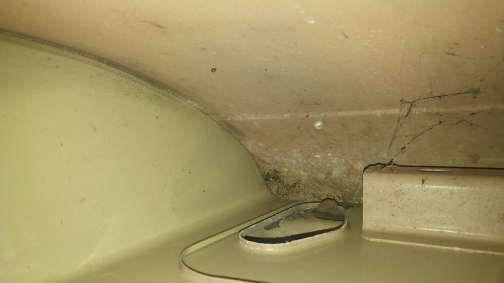

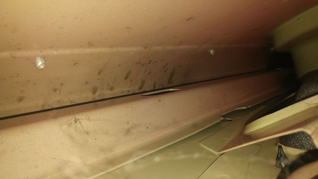

stripped the back out today, could not see any rust
