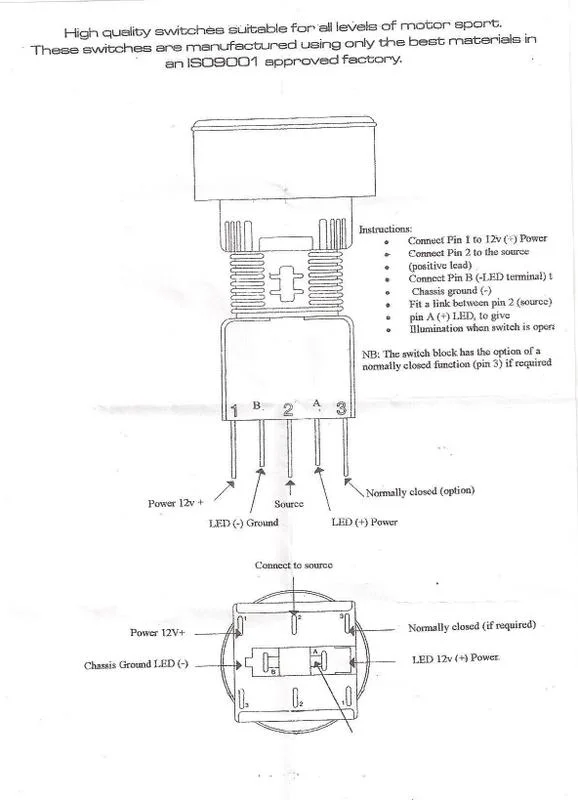

Ive just brought a savage Hazzard switch for my MK1 Clio, and was wondering if any of you guys were handy with the wiring and could point me in the right direction.
Heres the wiring diagram supplied:
