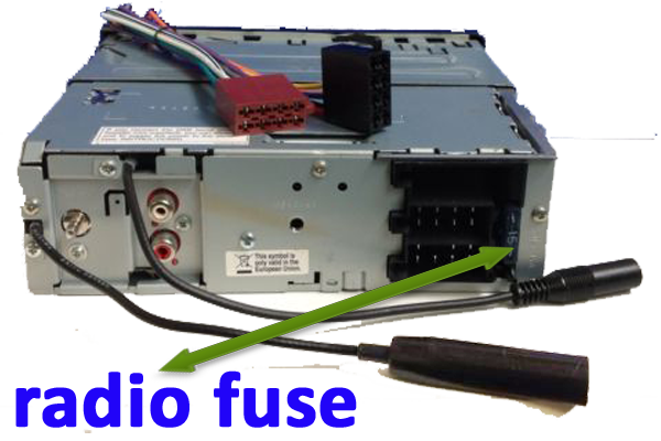

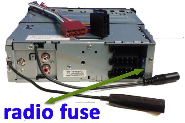

Then you might need to replace the headunit fuse , you will need to eject the headunit (im guessing you headunit is an aftermarket one) and look for the fuse.
example:
wont take you more than 20 minutes in total . Hardest bit is figuring out how to pop the headunit out.
Forgot to say with these fuses they are made of clear coloured plastic so you can see if the fuse is blown which is handy.
