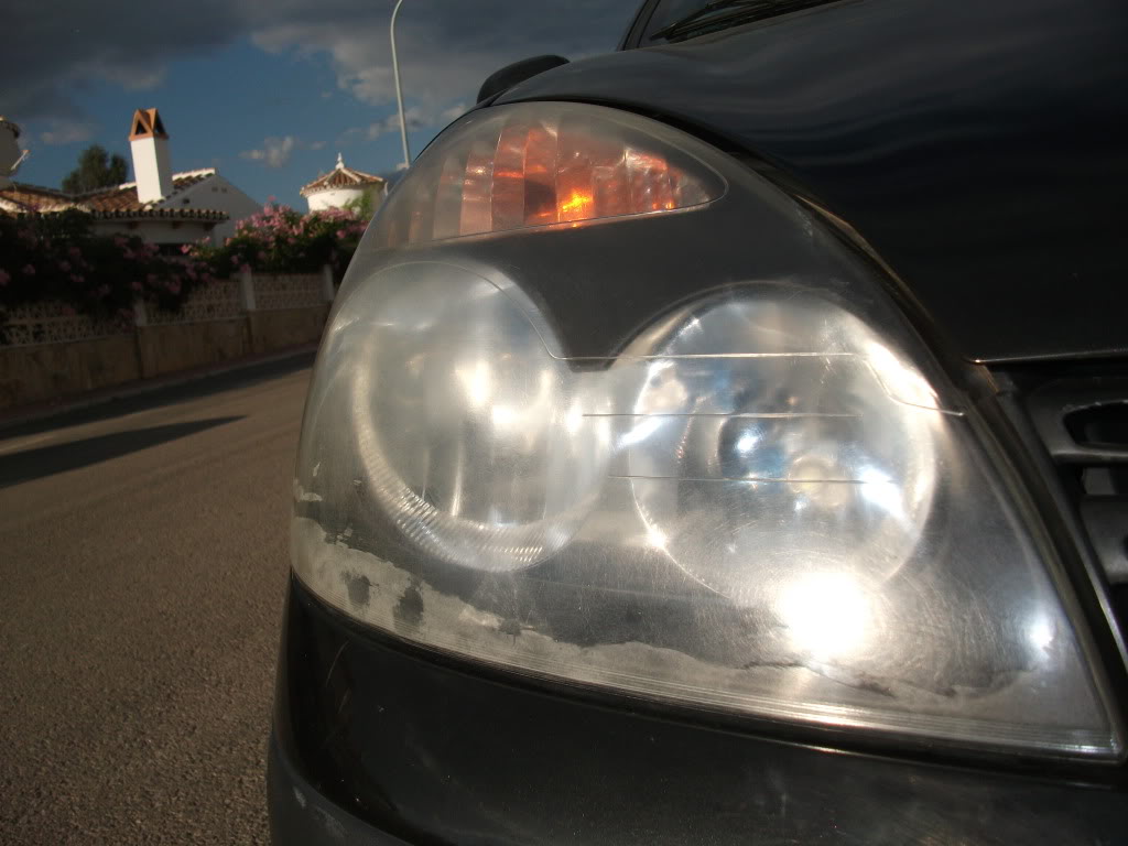

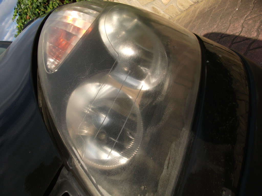

i didnt think i was gonna be able to do this they were really bad, i got my g220 the other day and thought id give it a go, never used one before, heres what i used
3M 800,1200,2500
meguiars dual action cleaner/polish 83
before

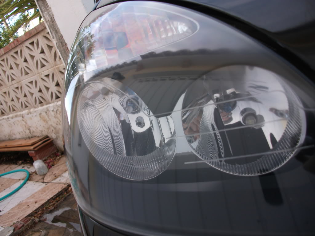

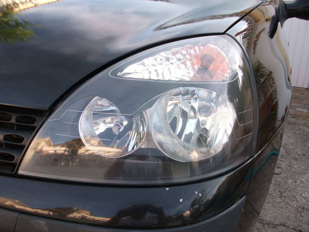

and after
not perfect but when they were that bad anythings an improvement, ill be polishing the whole car on sunday so ill go over them once more before waxing them. :)
