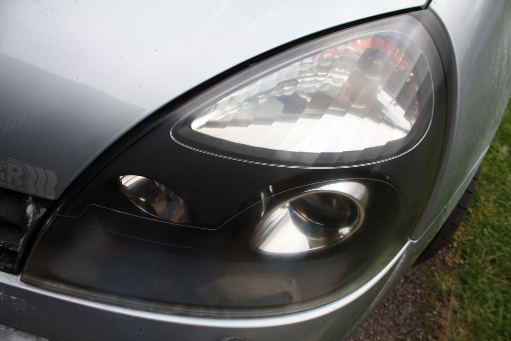

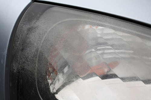

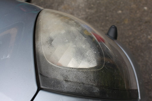

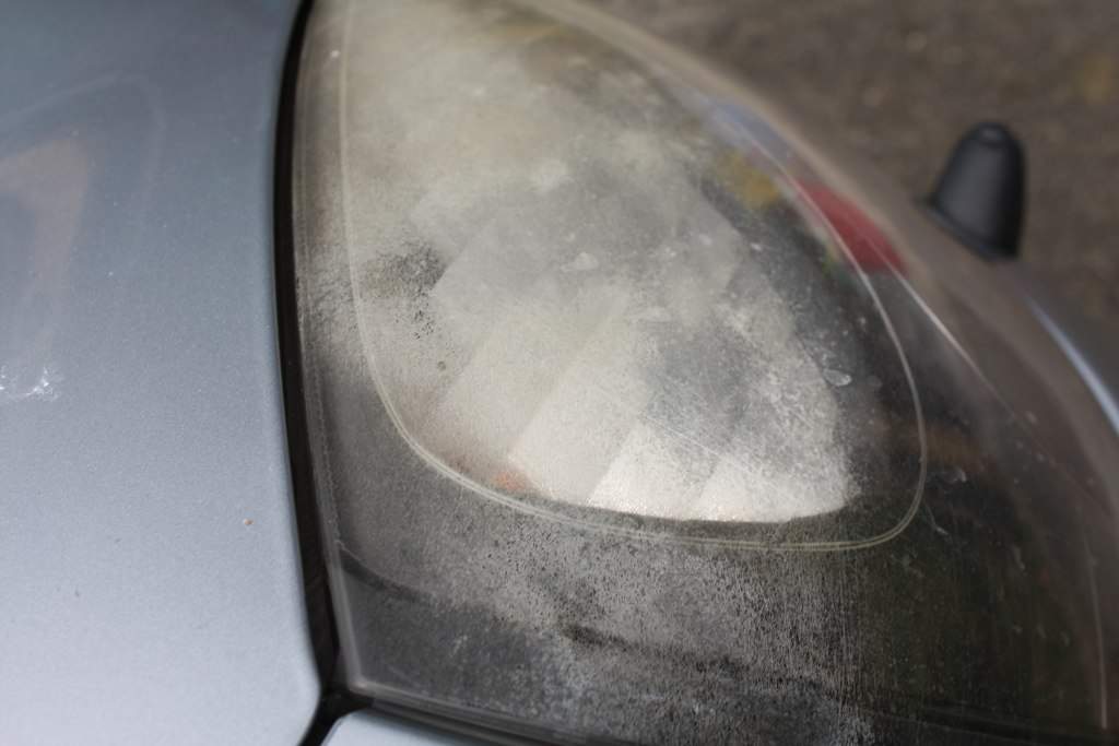

Before..

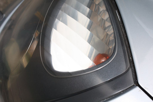

After..
Thats some improvement :)
What did you use bar the 1200-1550 grit wet and dry ?
T Cut ?
Didn't the plastic heat up with all the rubbing ?
As mine are nowhere near as bad as yours but i fancy giving mine a going over as they have a few wee bits in the corners :(
Fletcher
^^^Yes mate 1200-1500 wet and dry, and some Megs Scratch X.
The plastic didn't heat up.
I'm going to give mine another going over with some scratch x tomorrow.
Hope this helps mate.
Cheers mate.
How long did they take you to get into the condition they are in now ?
About 1.5-2 hrs on each light mate.
