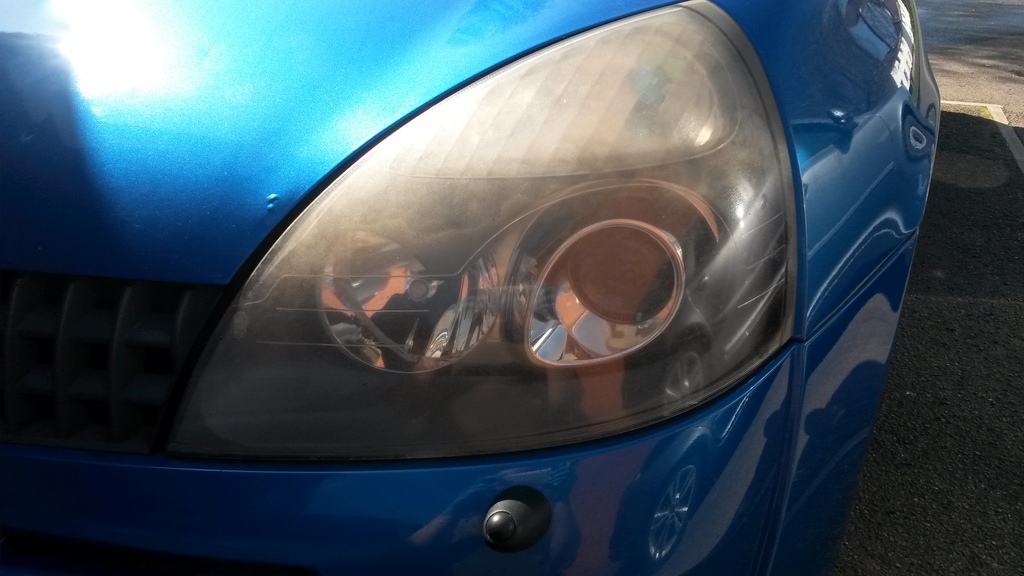

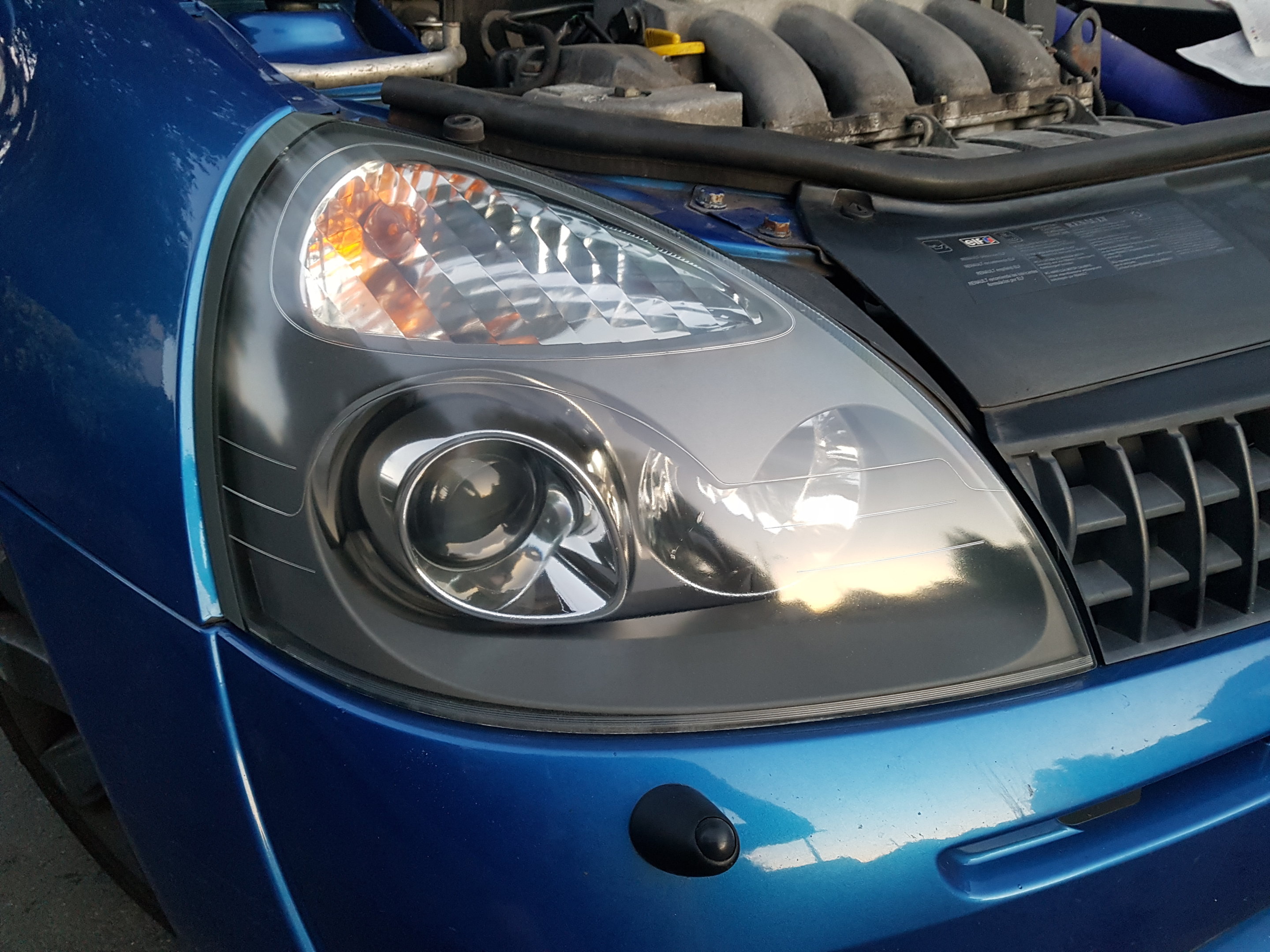

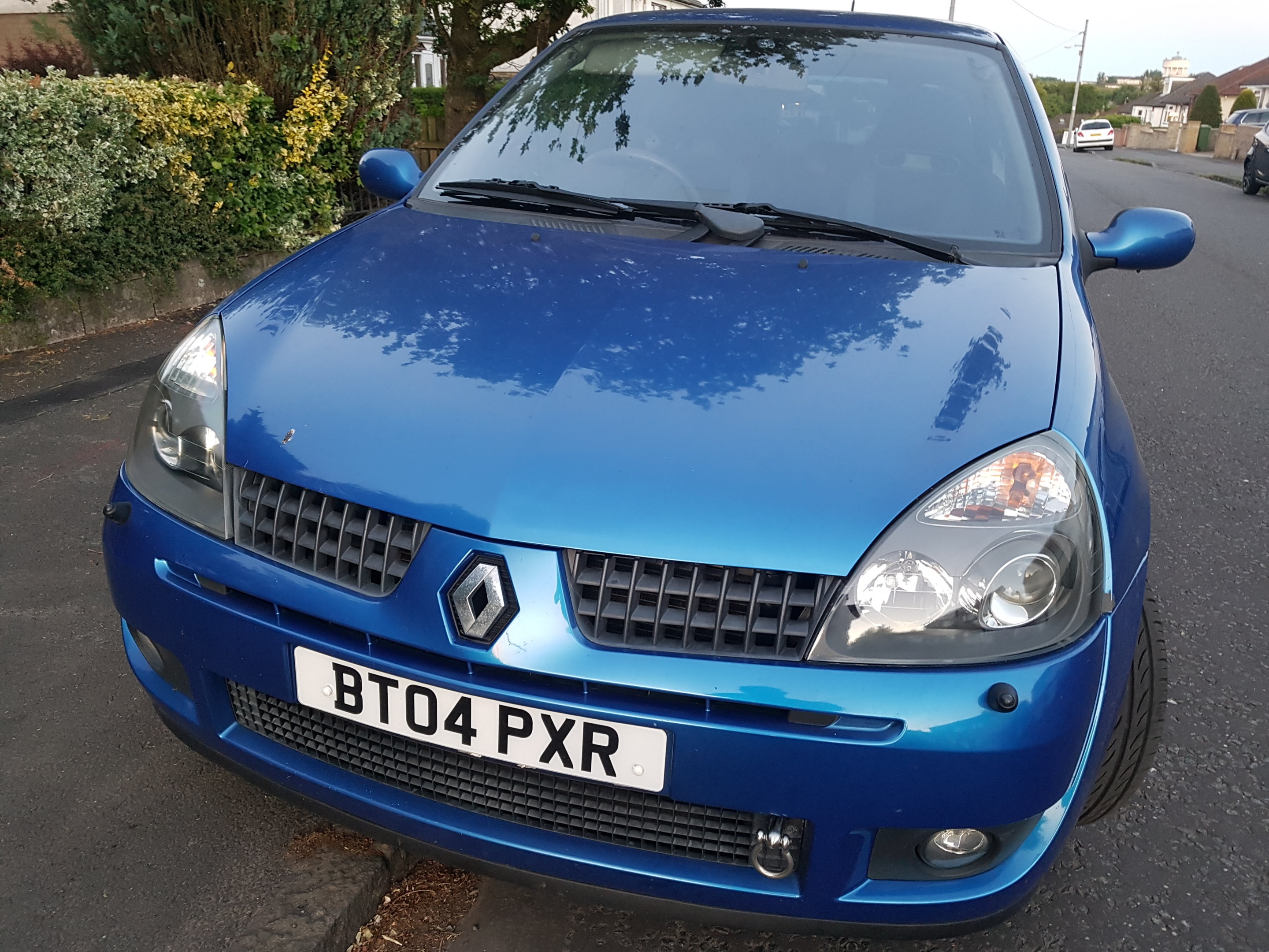

Well spent about an hour per headlight this afternoon and they've not come out very good 😧 done 600/800/1200/1500/2500/Scratch-X/Mer. They're a lot cleaner certainly, as they were going a bit green/yellow but they're hazy as f**k!
I'm guessing my mistake was starting on a too low grade... oh well, is there anything I can do now?

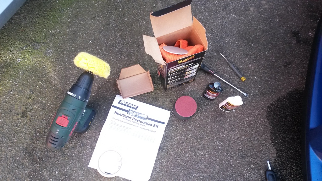

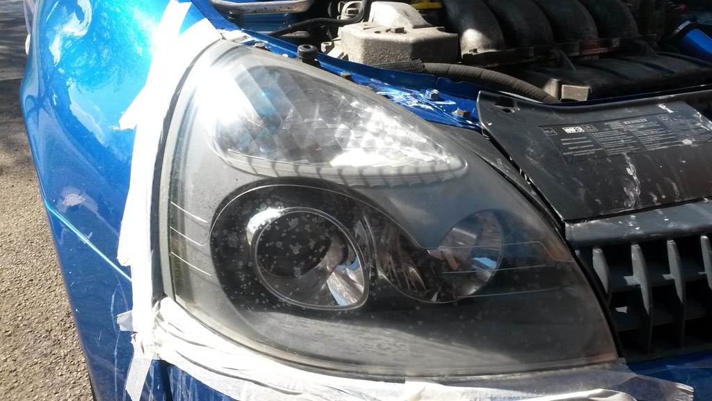

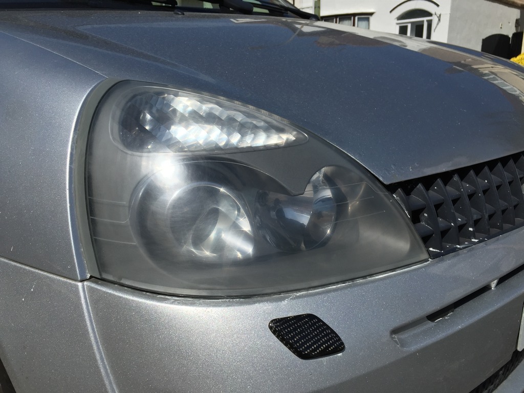

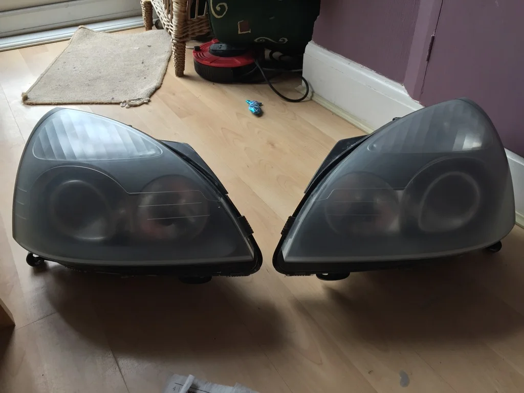

Heres mine I did using Megs heavy duty kit I picked up in the States last year.
Before:

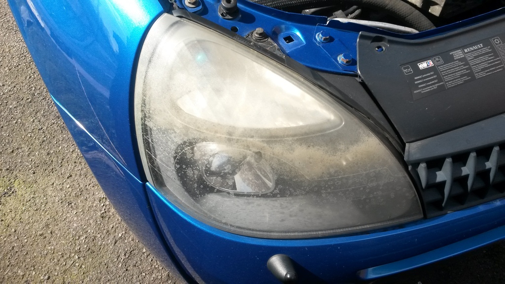

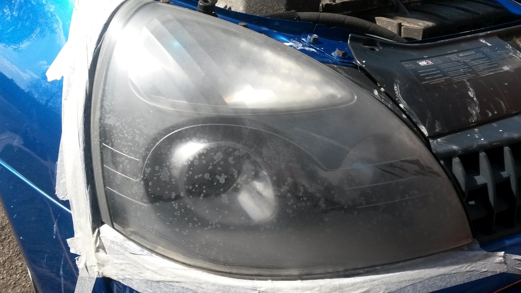

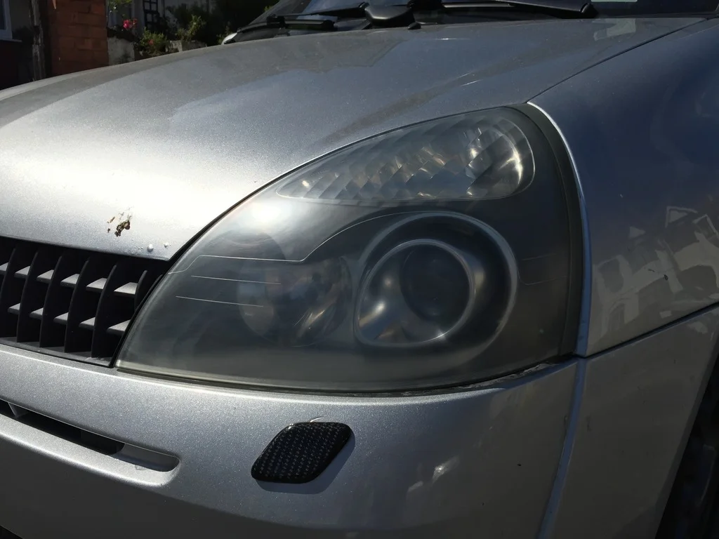

Other side was worse with lots of pitting:
The Kit:

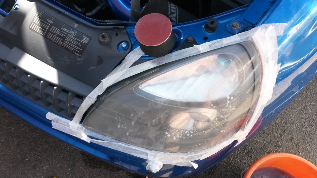

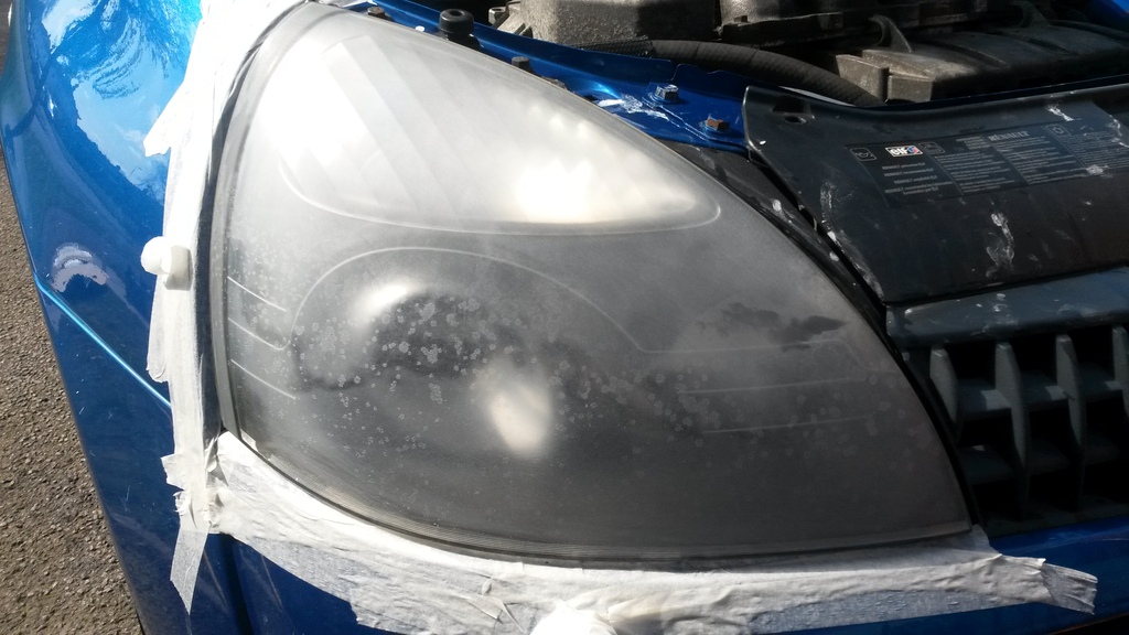

Whilst still wet
Dry after 1st abrasive (1000grit)
Dry after 2nd abrasive (3000grit)
After Polish with PlastX and UV protectant

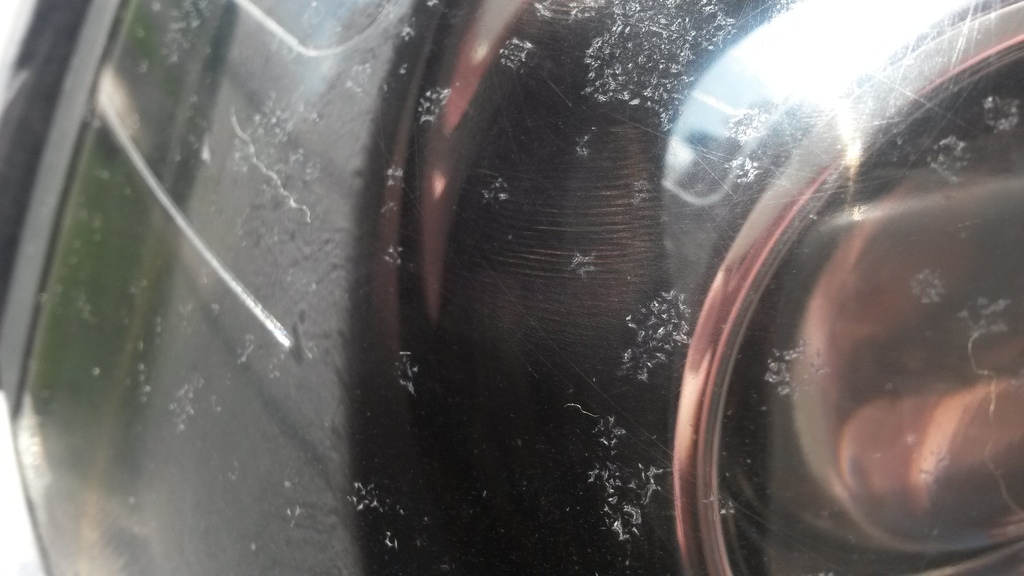

1000 grit, pitting still there but I didnt want to spend hours!
3000 grit
Polish
Close up of pitting.
Overall I was happy with the kit (only cost about £15) took less than an hour with 15 mins spent ensuring i had masked well!
There is plenty left in the kits to do lots more headlights or redo these if I have the patience to really clean up the pitting.
go back to mid grade and work up to higher grades again. Unless your running out of plastic thickness, they are recoverable
Okay mate so reckon start around 1200 again? How long do you think per grade... I was going for about 10-15 minutes...
Oh it's very smooth and yes had a bottle of water with me spaying it all over every couple of minutes.
Minutes??
You should be keeping it soaked! Bowl of water, sand few times, put in water and repeat..
I used 1500 wet n dry and then 2500 wet and dry. And had no issues
Cheers for the tips guys. Went back for another 30 minutes per headlight today... started off at 1200 then up to 1500 & 2500. Used loads more water this time, literally spraying every couple of seconds. There's definitely been an improvement, though still no where near as good as other people are managing to get.
Any other changes I can make to my method or is it just a matter of keep battling on? Can still see loads of scratches up close :(

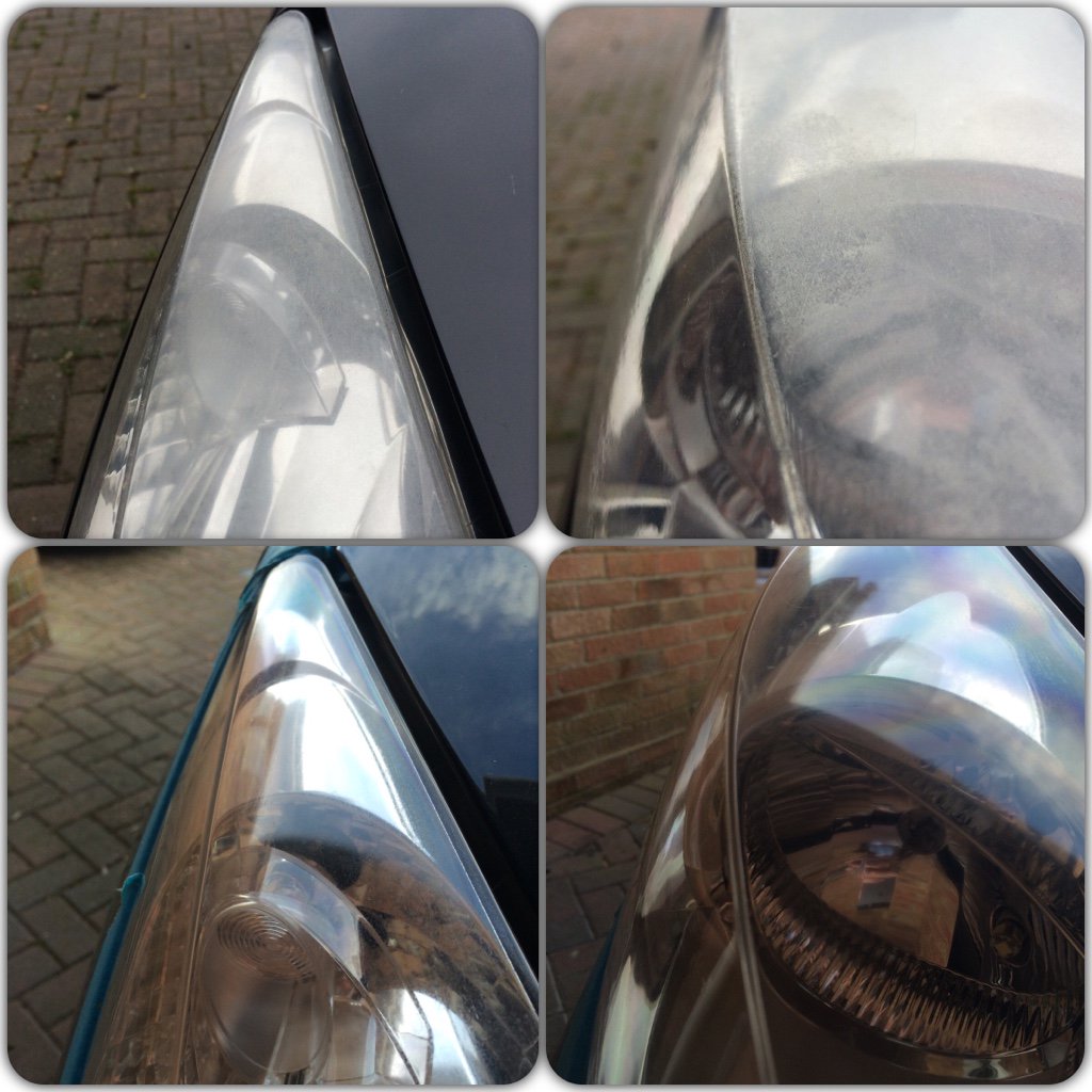

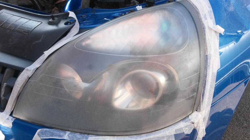

My first try, Not perfect but much improved, Will do it again once I've moved my stuff to my new house.

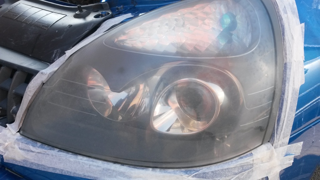

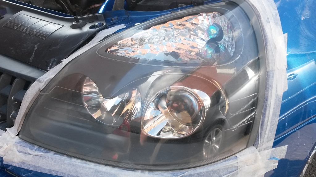

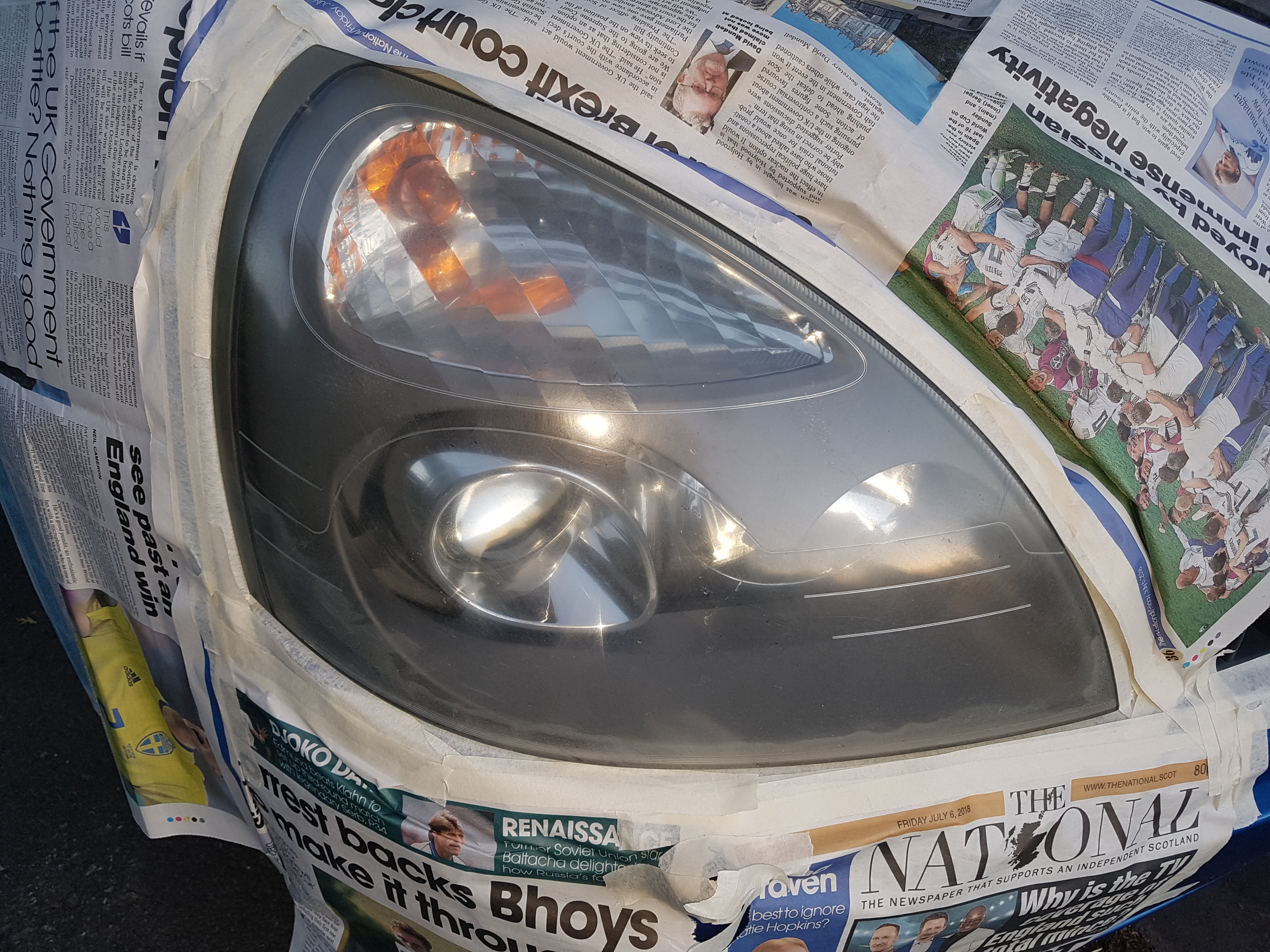

I had prev used the 3m kit and found the results to be ok- came up nice enough but that must have been over a year ago and was deffo needed done again.. Kinda already had the bits similar to the Meguiars 1step kit but saw the 2 step kit and thought I'd give that a go as it came with a uv sealant. I looked at the YouTube vids and saw a sales rep demo too and thought it looked pretty decent. I had used a drill before but just tried using the pads by hand tonight as was getting a lot of splatter from the polishing compound- went over twice with that then put on 2 coats of the sealer. About 15 min of polishing on each side and I have to say I'm very impressed at the results for the time spent on it.. have heard that the coating can come off sometimes but put on 2 reasonably thick coats so fingers crossed.
Before and after pics below..
