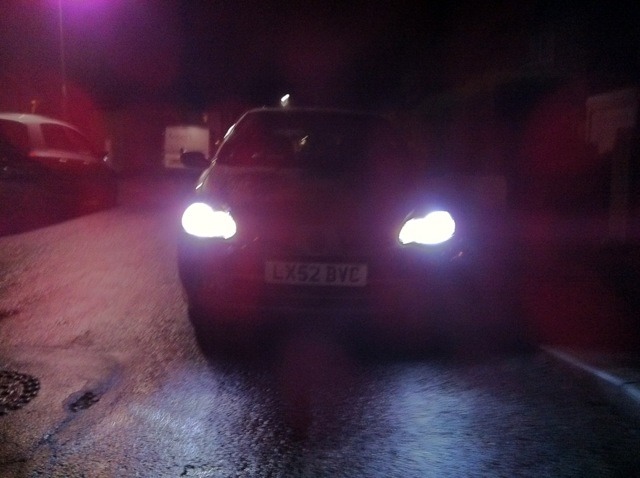

So this is the conclusion of the evenings events.
Not getting my hopes up as I did have to put the bulb into the headlight whilst it was ON for it to work. Took It for a drive down some horrible roads though and it has stayed on the whole time so I may have fixed it. Also turned it on and off alot and it hasn't turned itself off. All in all, quite happy I guess :) I have headlights again!
