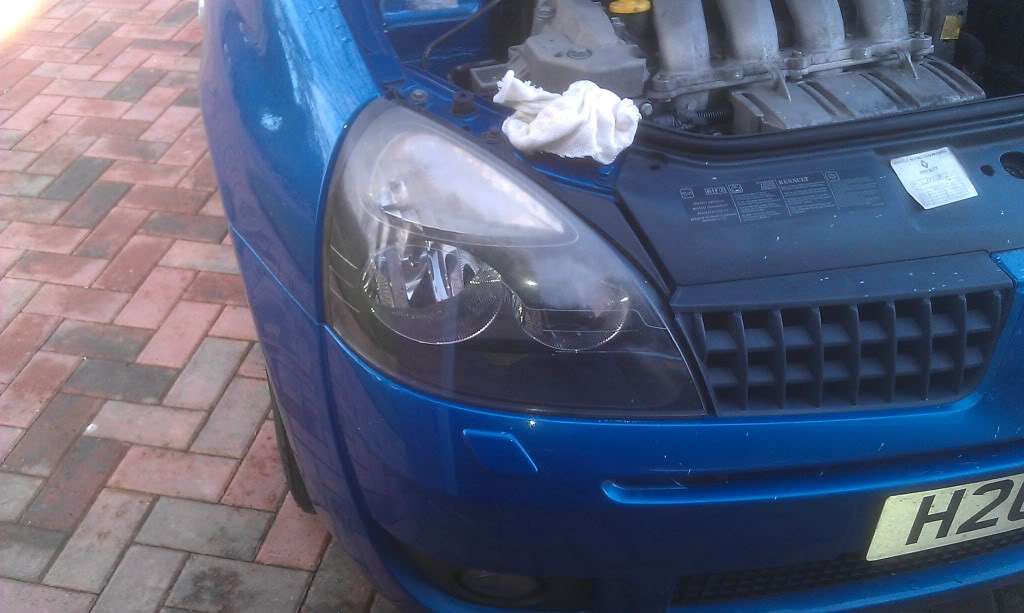

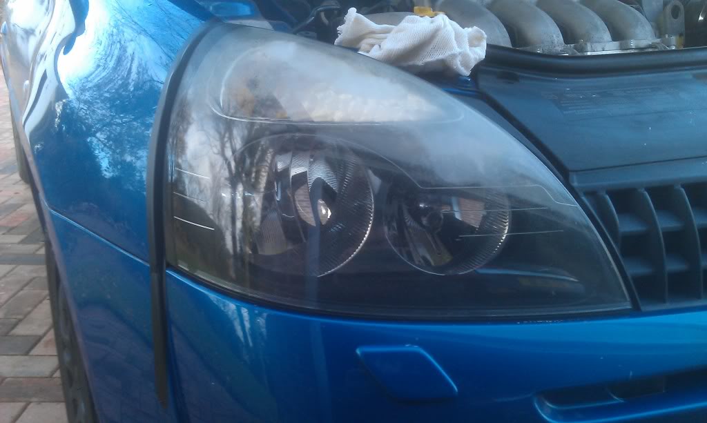

So one of the headlights before - Quite a common problem I hear?

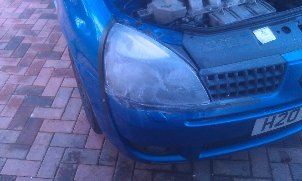

So the kit consists of a "restoration kit" more for yellowed lenses but I thought its gotta be worth a go. Within the kit - p500 grit. p800 grit and p3000 - plus a pad to use with a domestic drill and a buffer and compound.

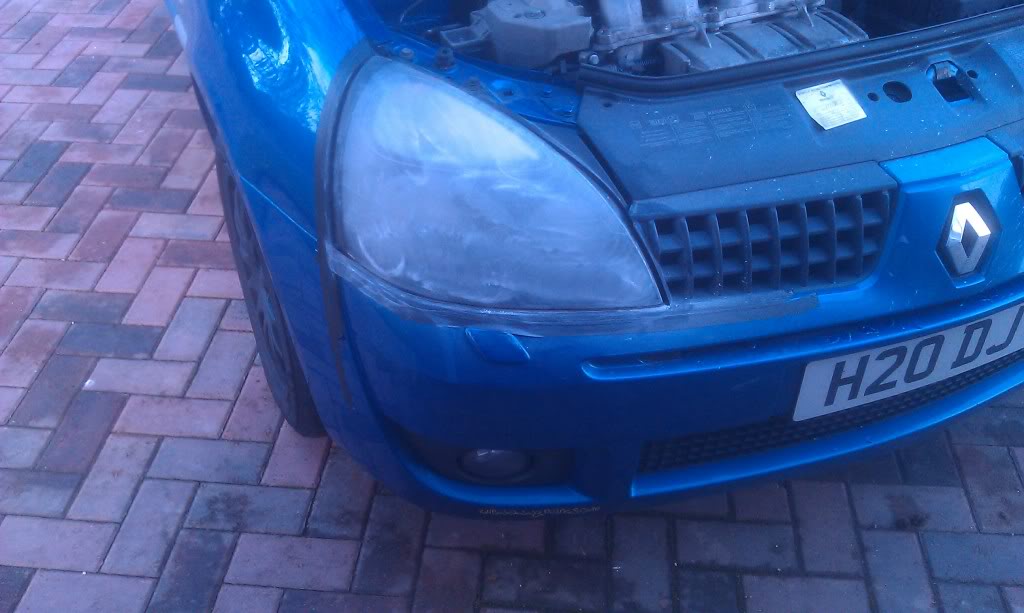

So start with the p500 -- and then promptly s**t yourself wondering how much a headlight costs on ebay...

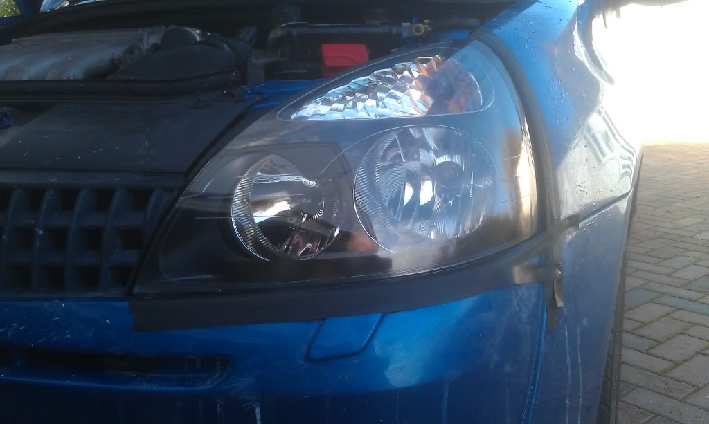

Keep the faith... Then move to the p800 grit.... a few passes of the drill over the headlight
Then use the p3000 with a spray bottle of water and your left amazed as a your left with something that's clearly still got sanding marks but is a new surface to the light.

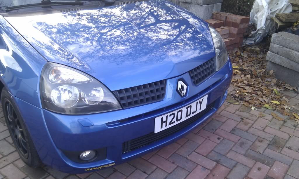

and you end up with this....
Use the compound and buff all done..
Makes the front end a lot more fresh.
