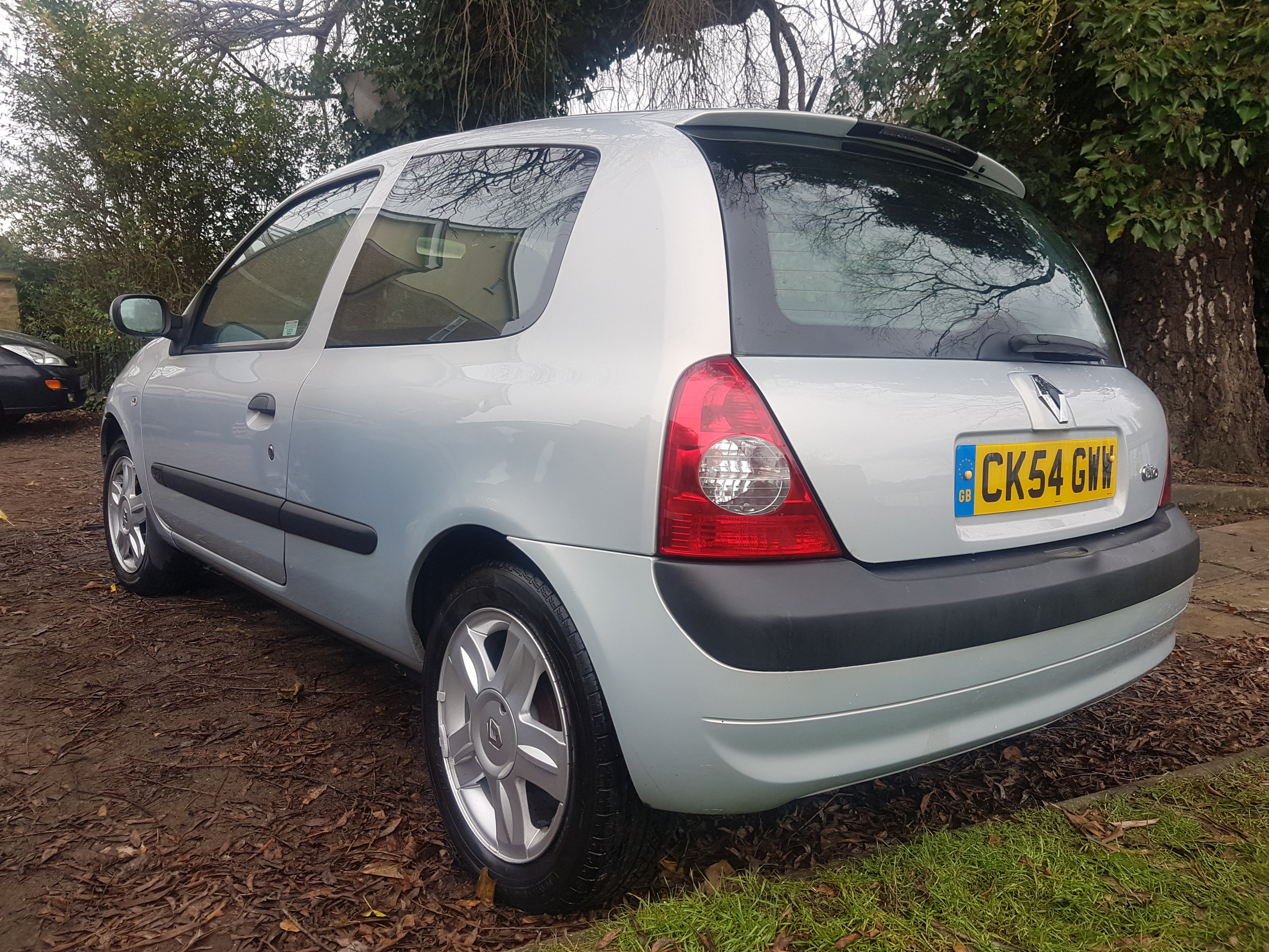

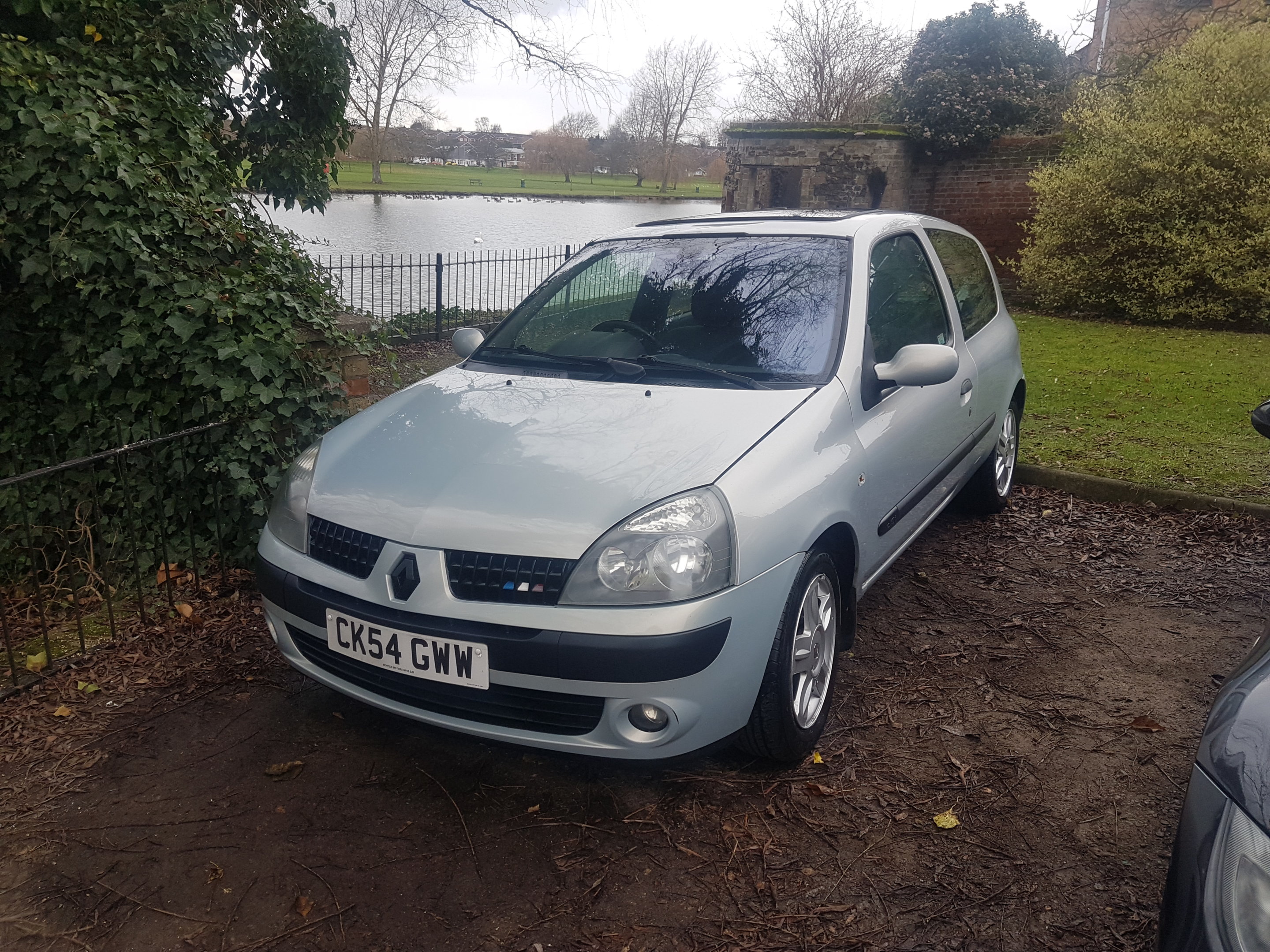

just wanted to say hi and start a thread about my daily which was saved from the scrap yard in the sky and now under "project" status.

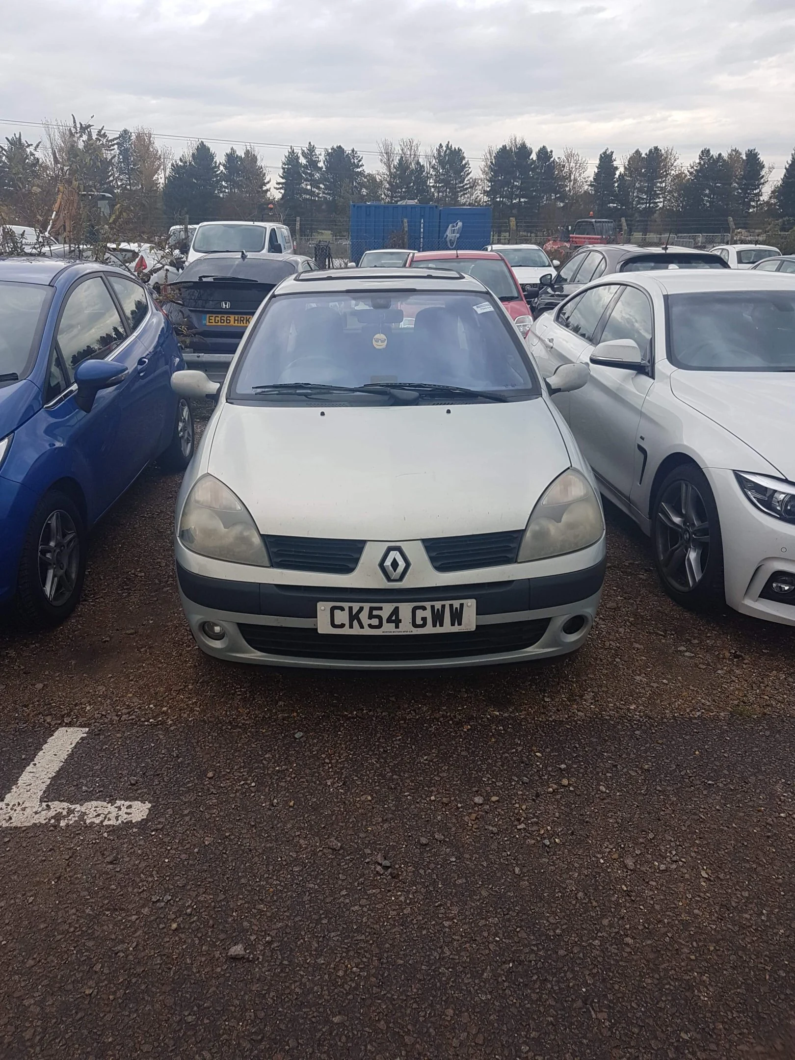

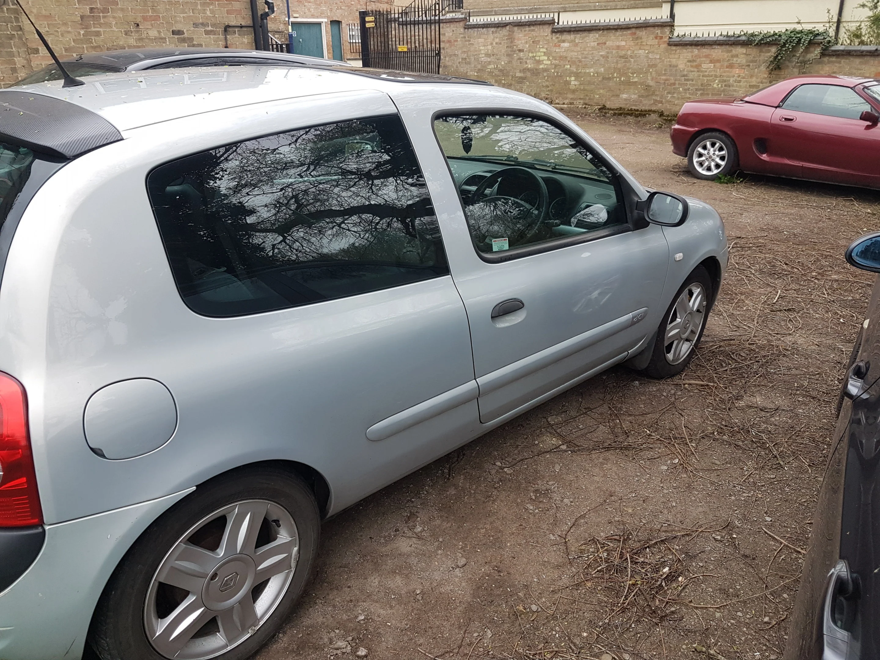

Roll the clocks back to October and my other half came home from work with tales of been given a car from someone at work... my eyes rolled and when she first sent me the photos i thought "it gonna be a pile"
1.5DCi Dynamique with 150k on it with a pretty bad oil leak so she was given it FOC.

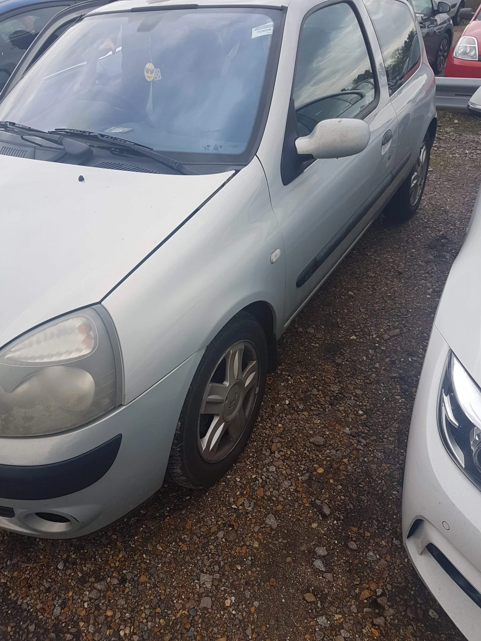

I picked it up and it was filthy inside and out, been smoked in heavily and had a list of faults such as;
Stereo - knackered
Bad oil leak
both doors clicked when opened
boot didn't lock
blower fan - knackered
brakes - warped
about 10 bulbs blown.
headlights all faded
BUT other than the leak the engine ran well.

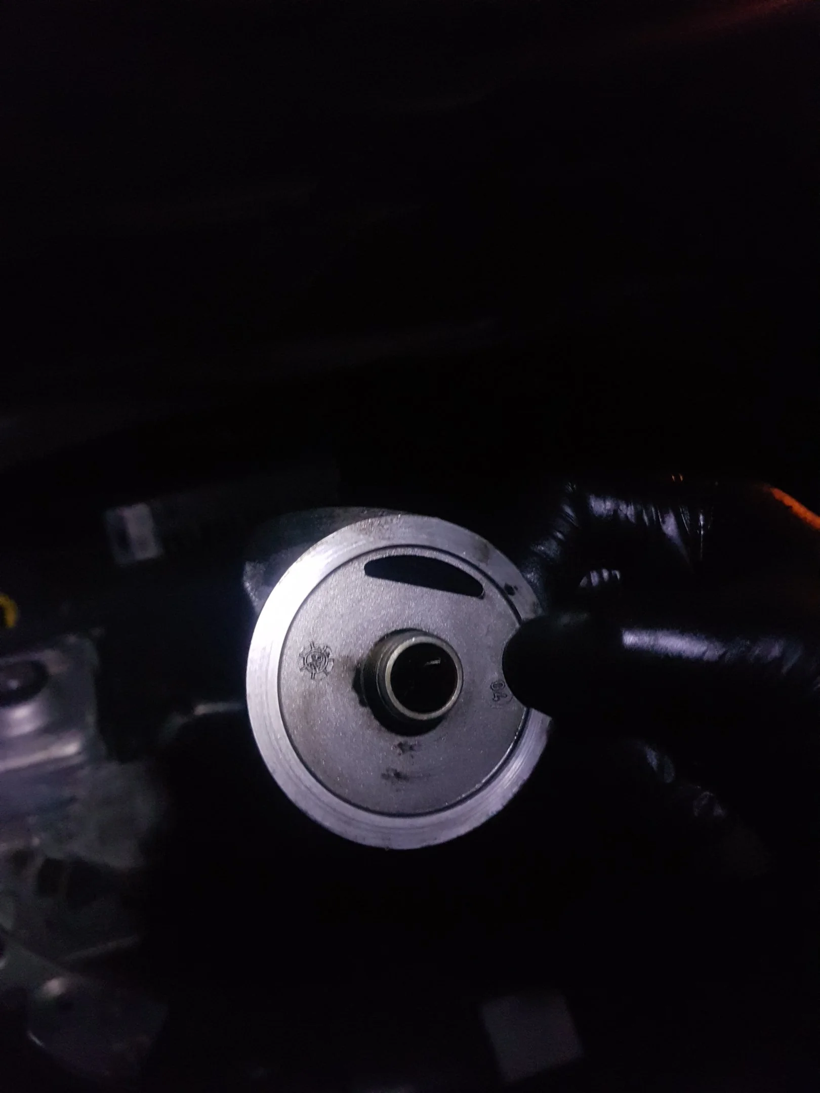

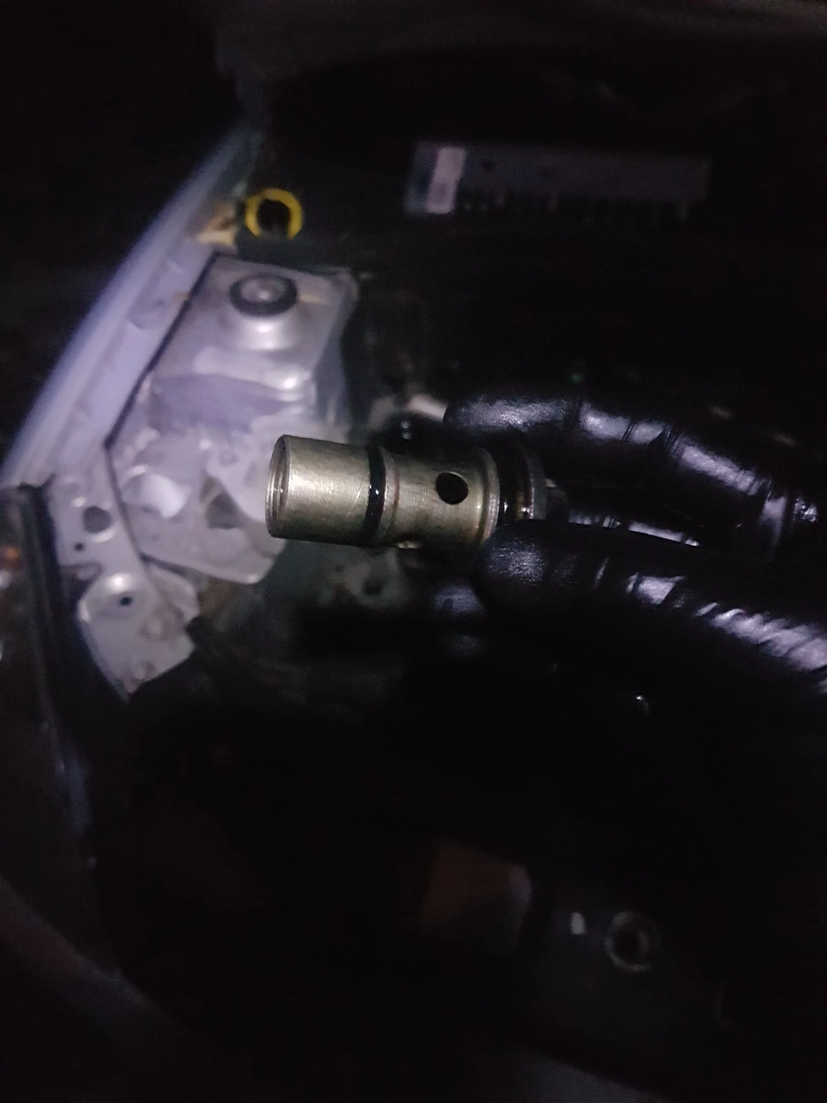

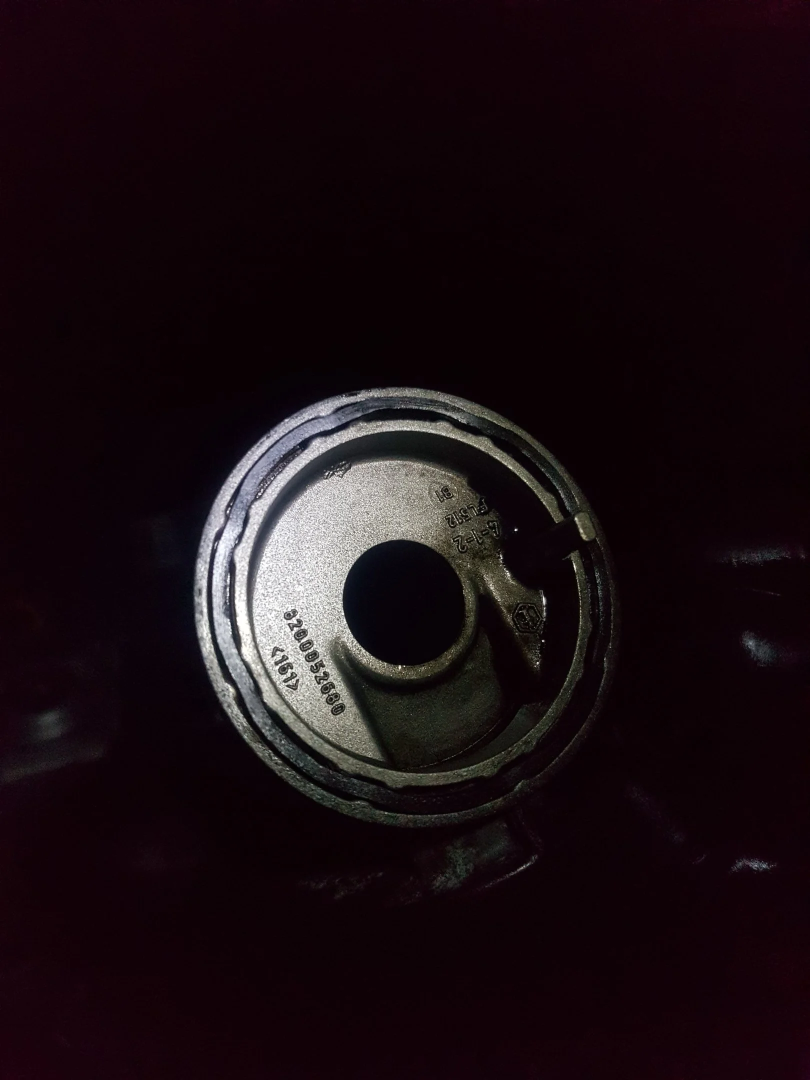

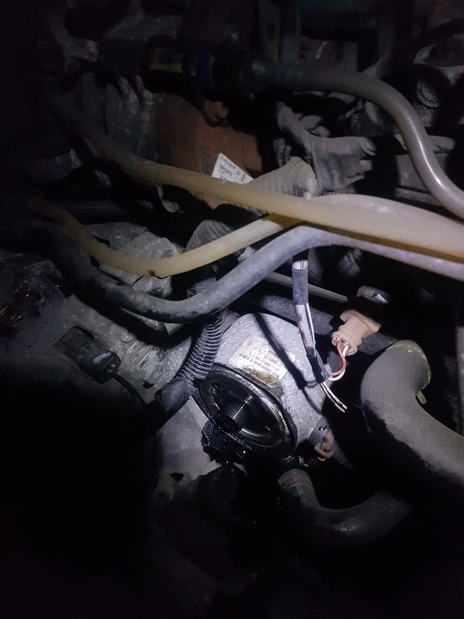

I got it home and went and bought a service kit as I love tinkering. the oil leak was coming from the oil filter housing bracket. it wasn't pissing out but it was a little dribble. I dismantled it and the seals were crumbling away. I called renault who wanted £32 plus vat for 2 o rings (I know, shocking) now the same o rings can be found on the plumbing isle in B&Q for less than £3 ??. other than the sump plug which felt as though it has been tightened with an F1 tyre gun, the service was a doddle.
oil leak fixed and engine service done ✔

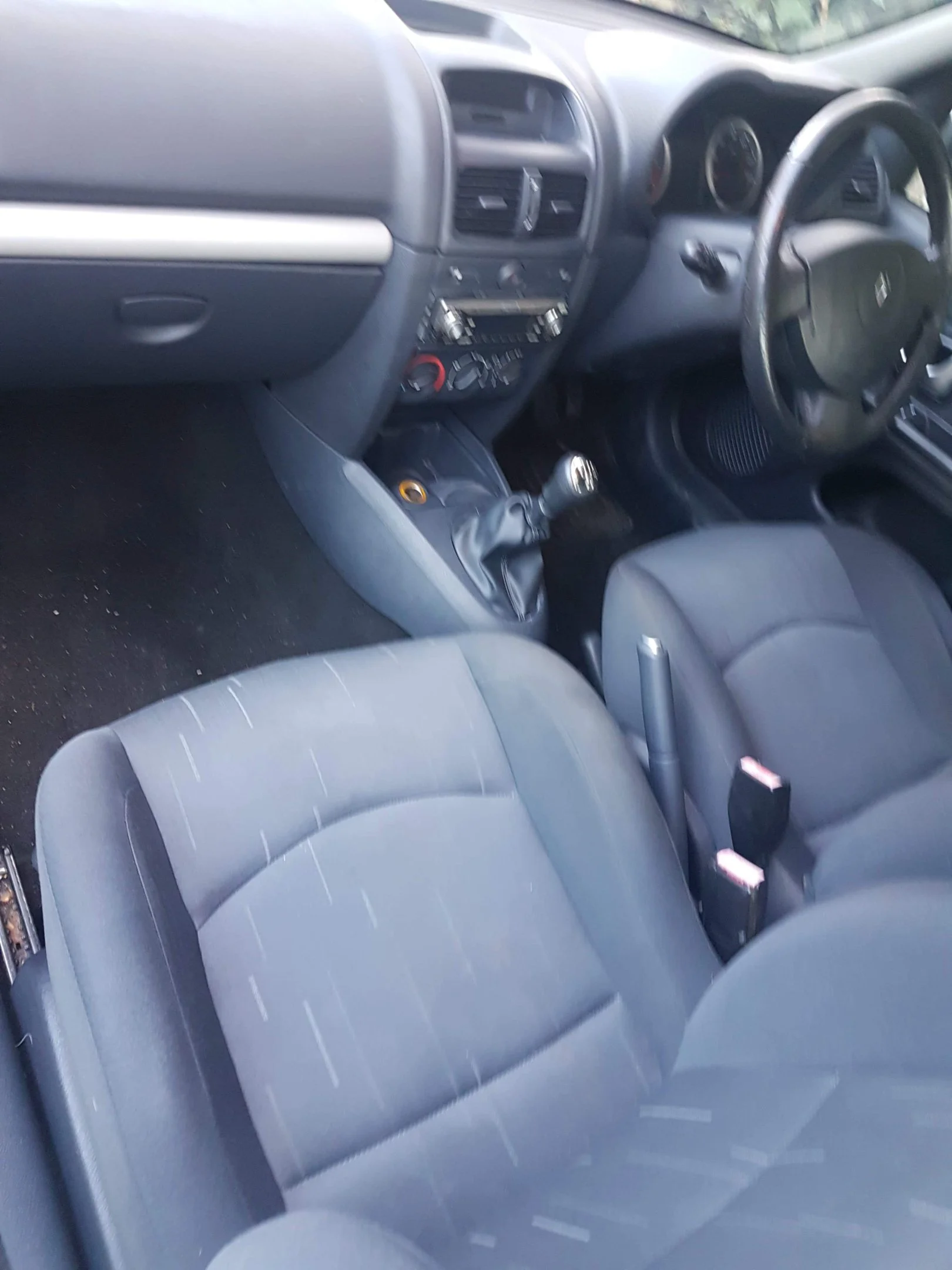

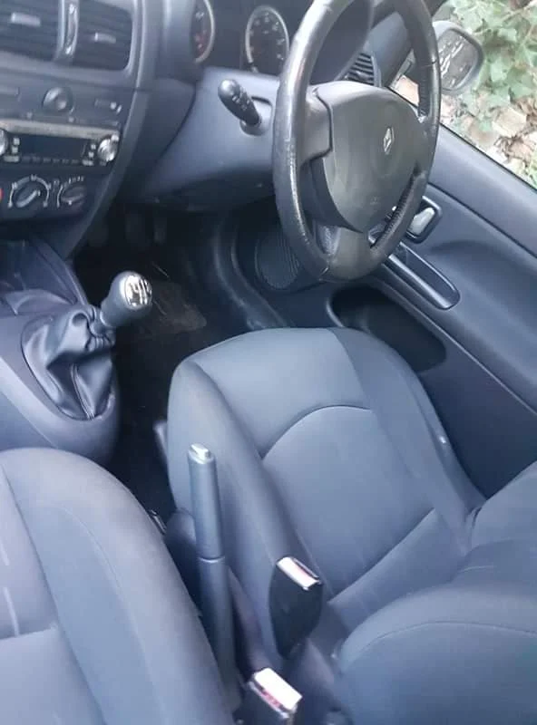

we gave her a good clean and when I say good I mean we gutted it... every interior panel which could be removed was scrubbed in the bath and the roof lining had a good scrub... the car came up MINT!!!

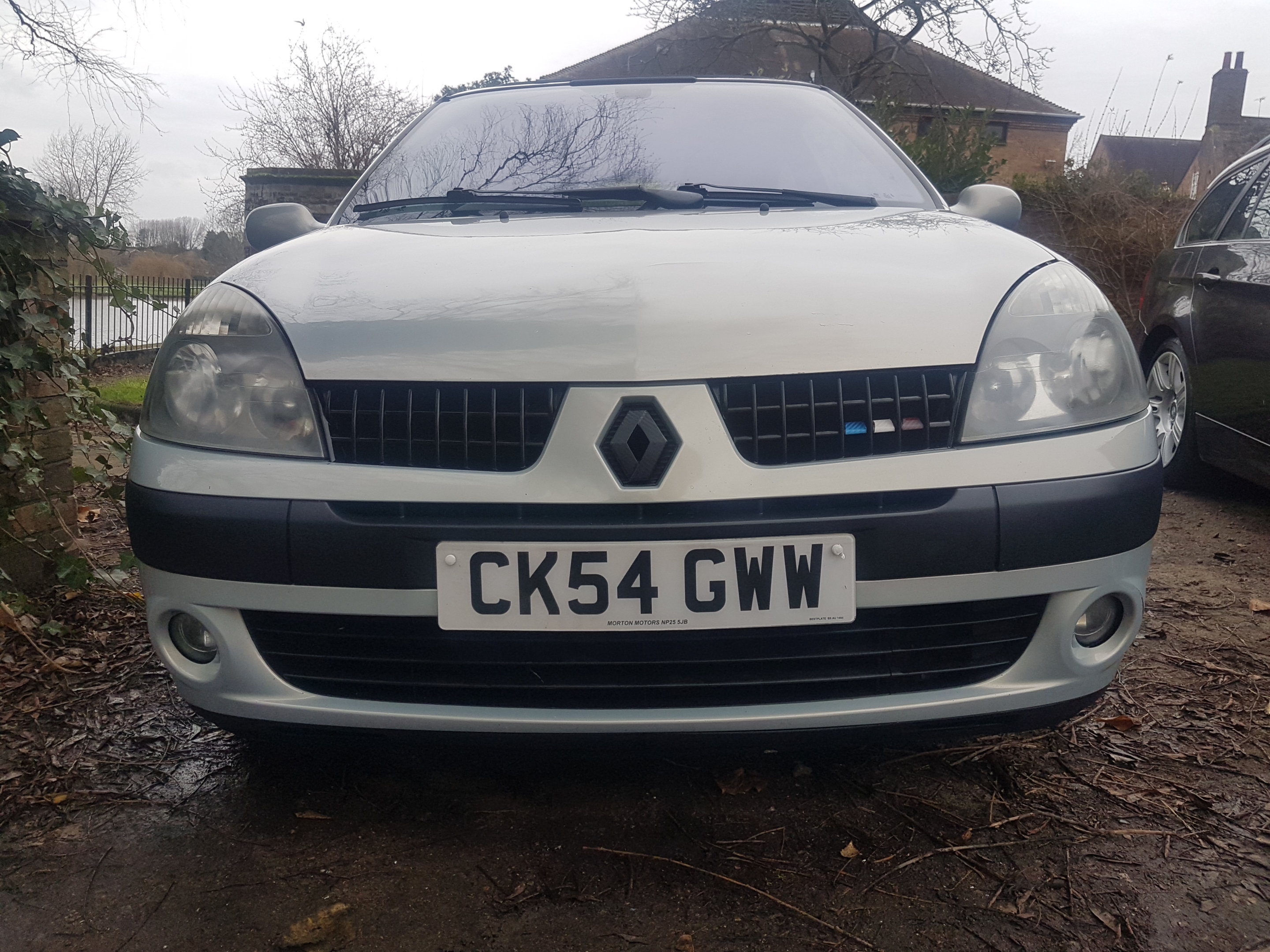

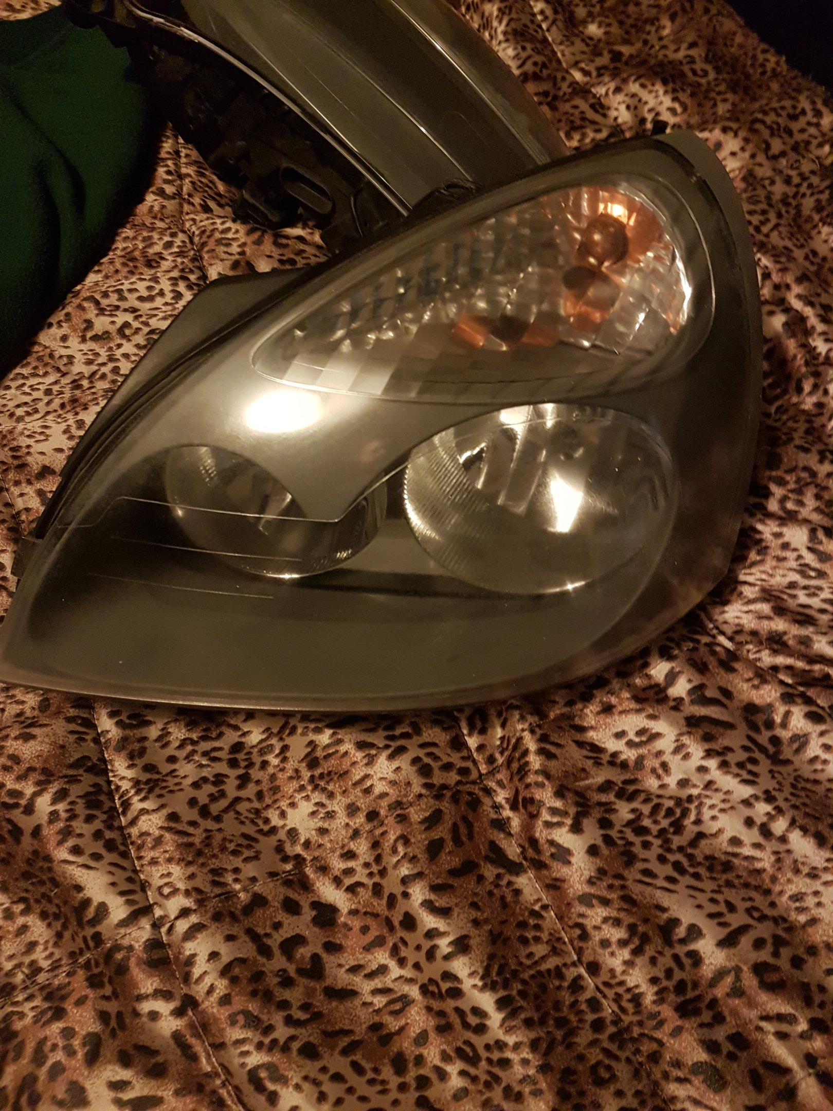

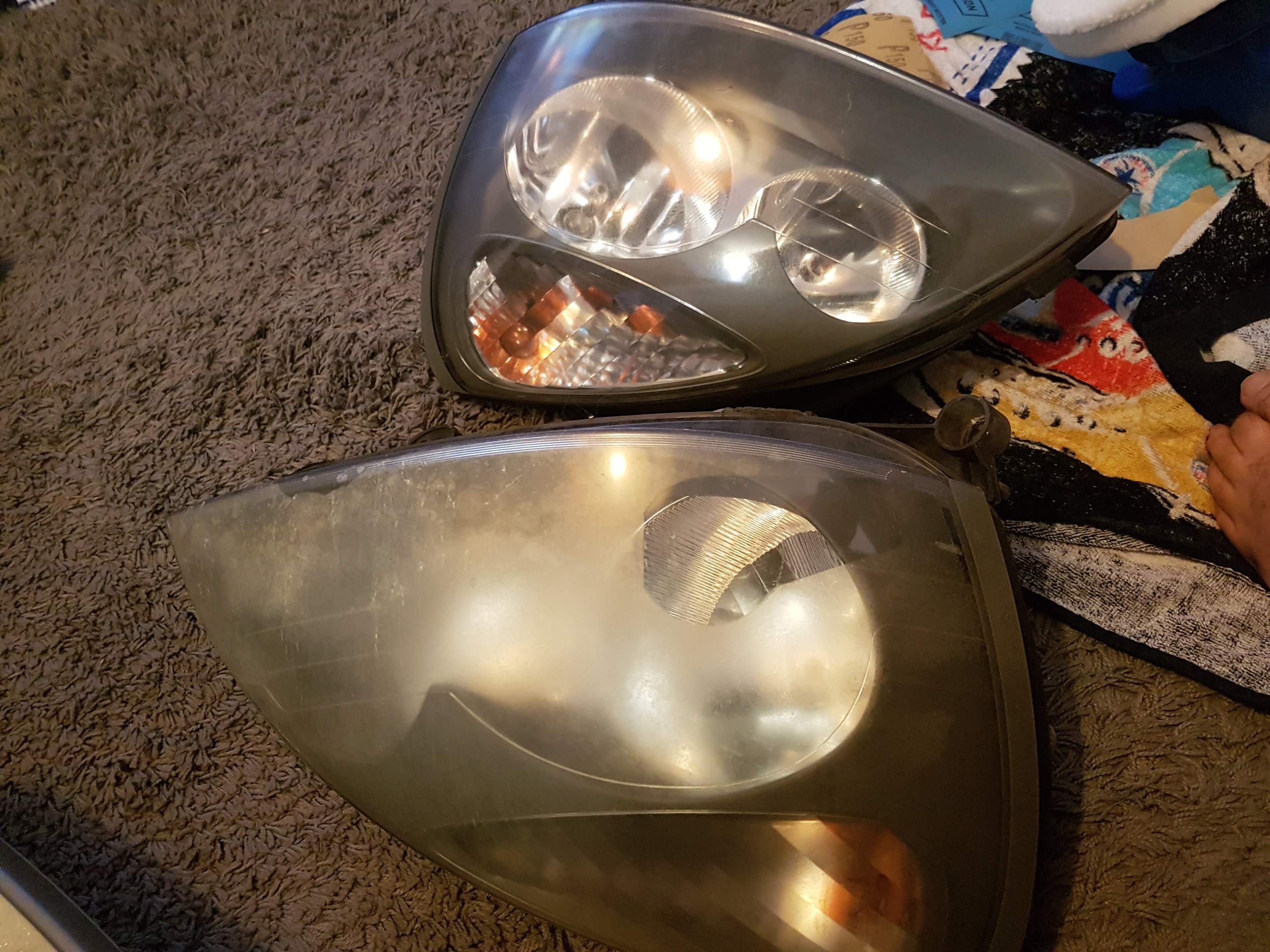

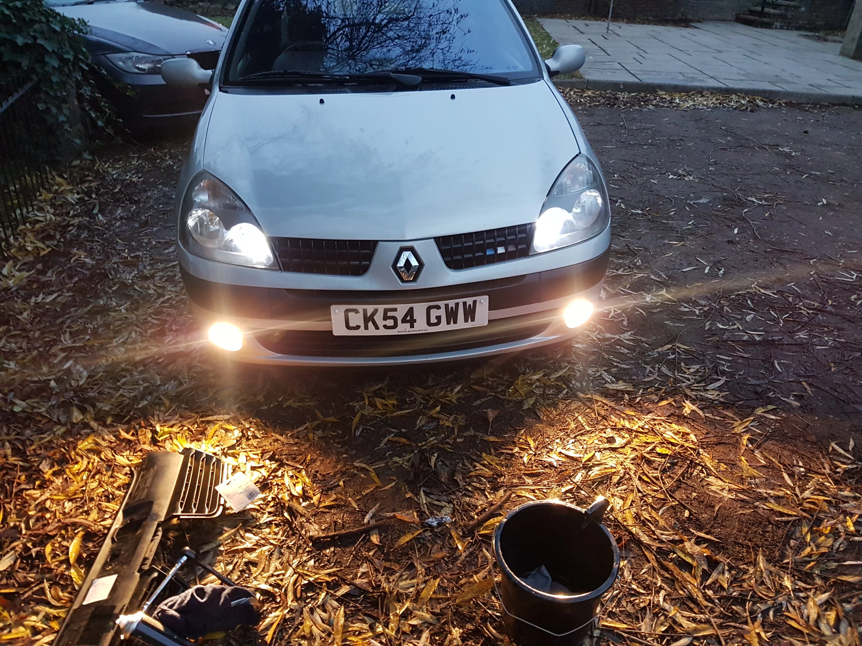

the headlights were shocking so they needed taking out and sorting too (photos below) I just used some fine grade sandpaper, a buffer and some compound... they also came up a treat.

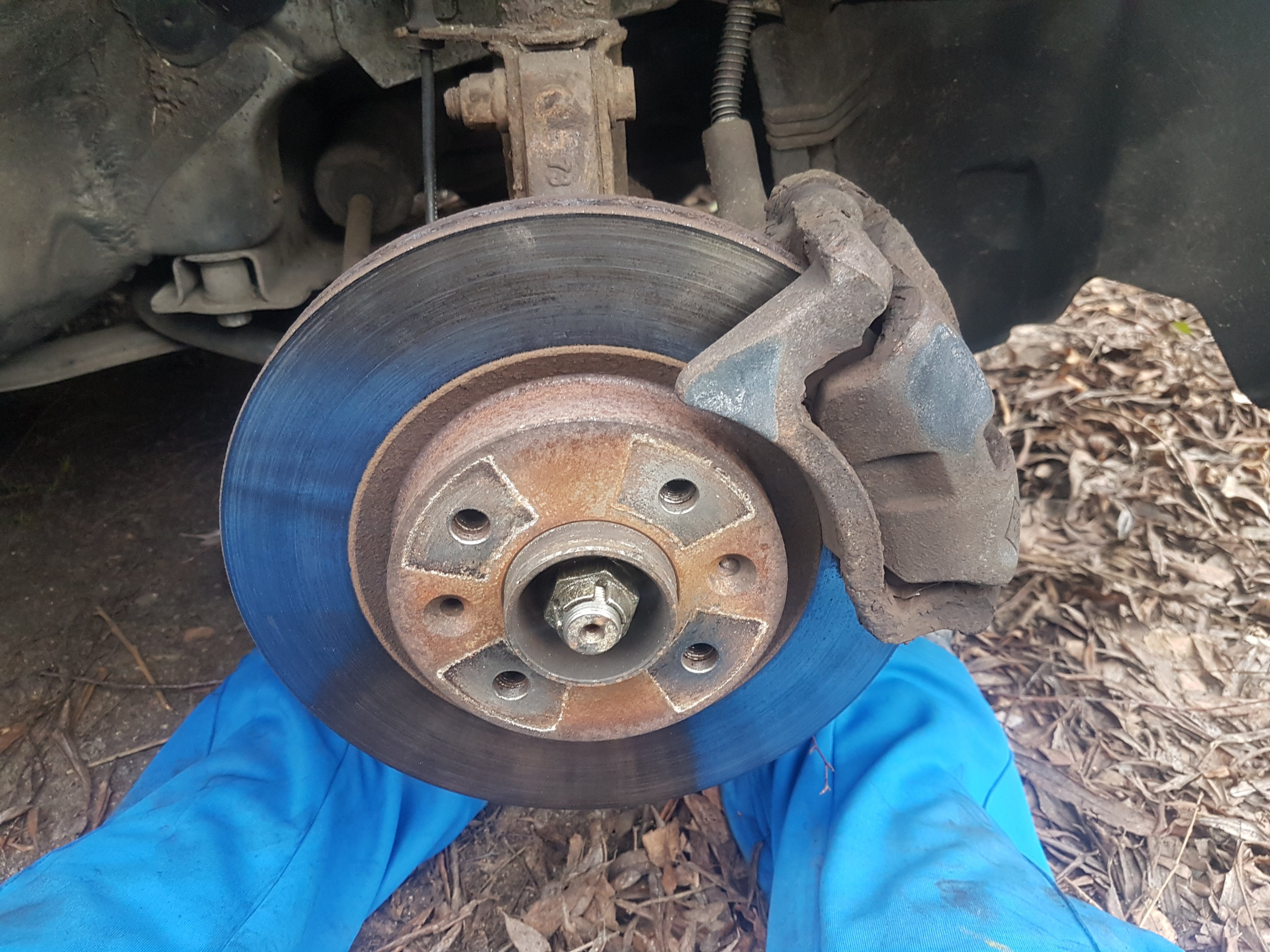

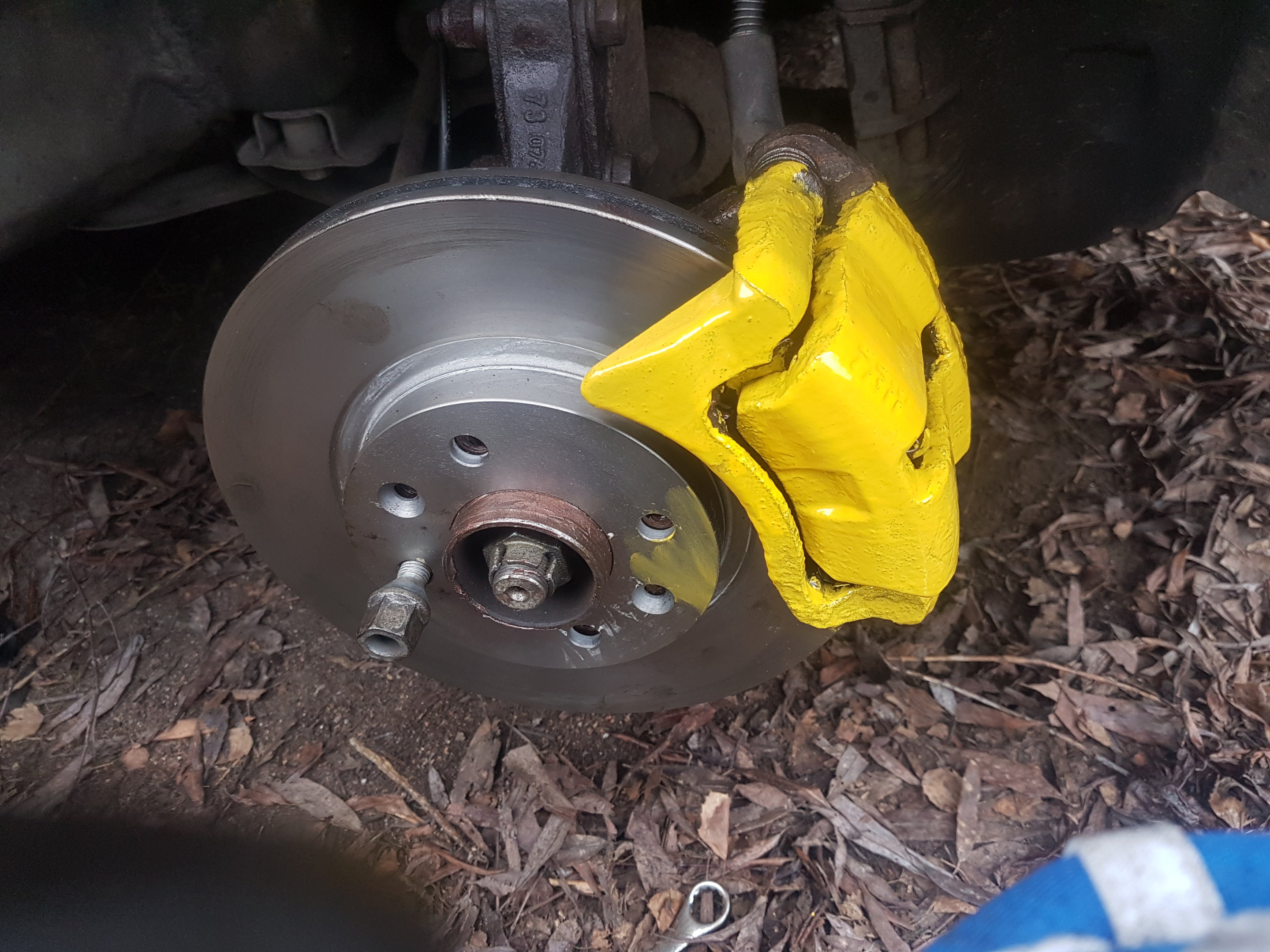

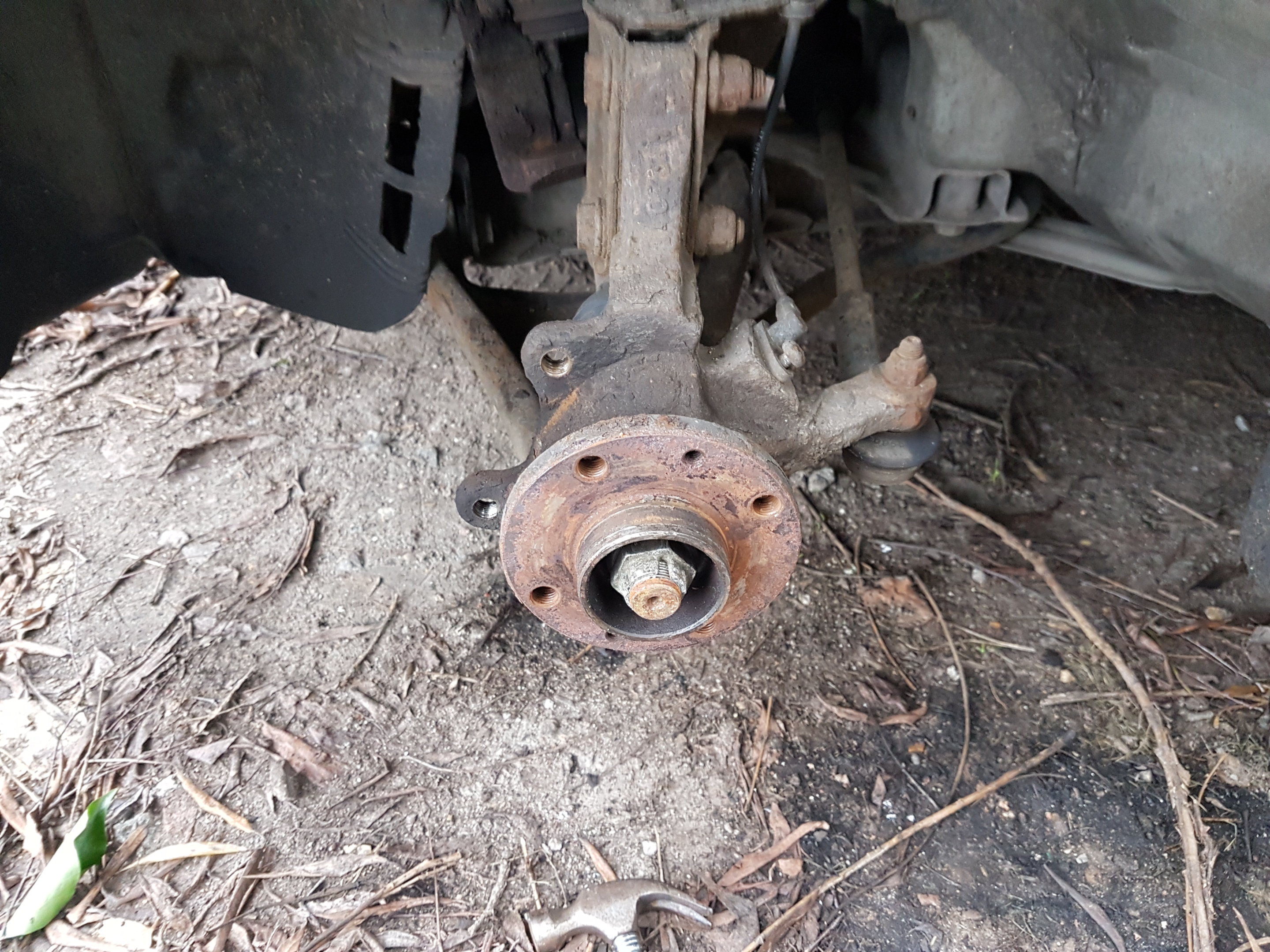

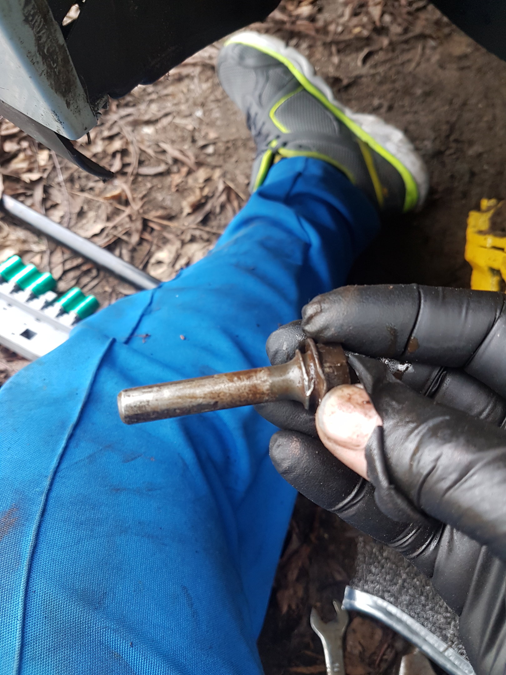

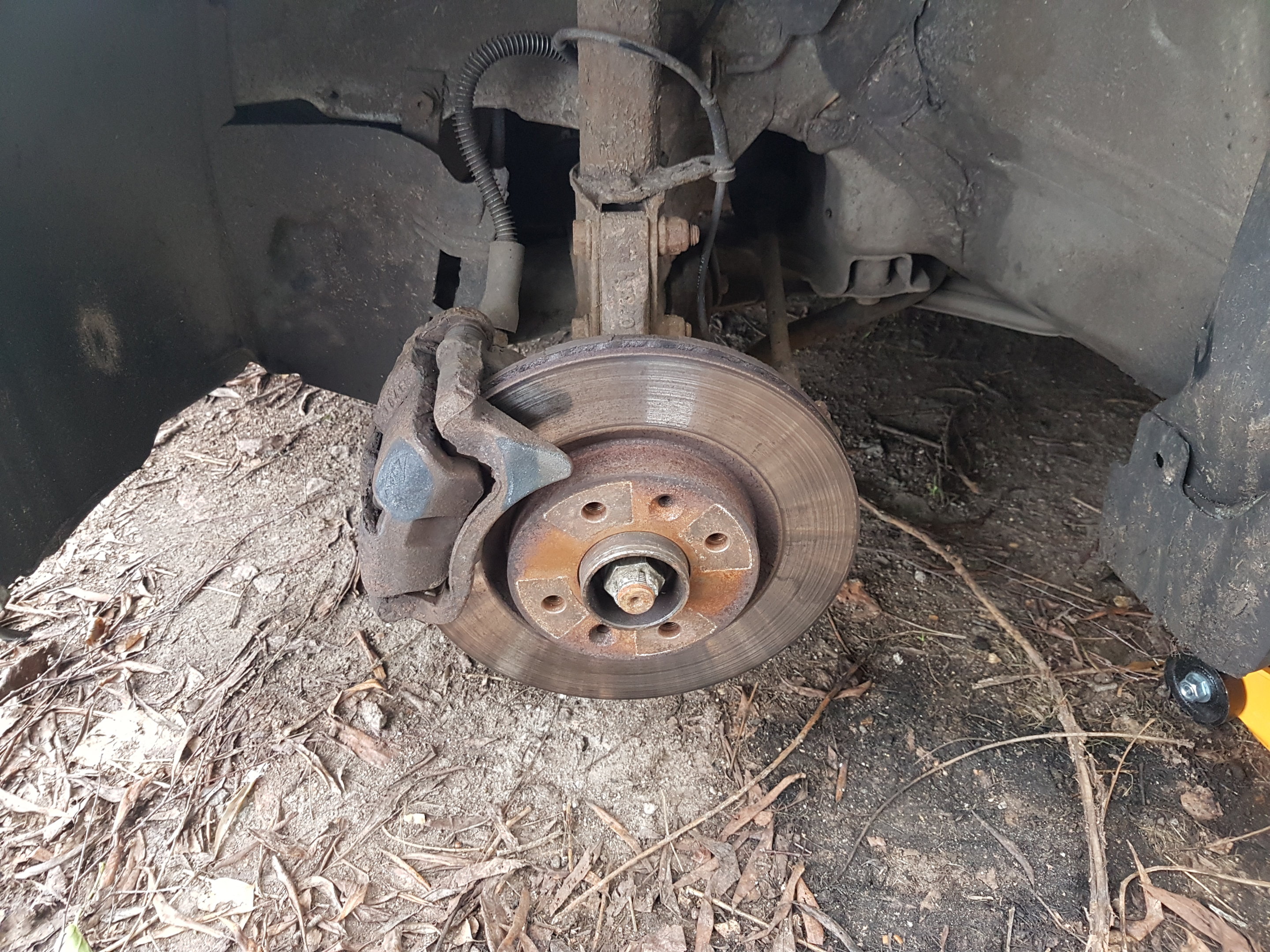

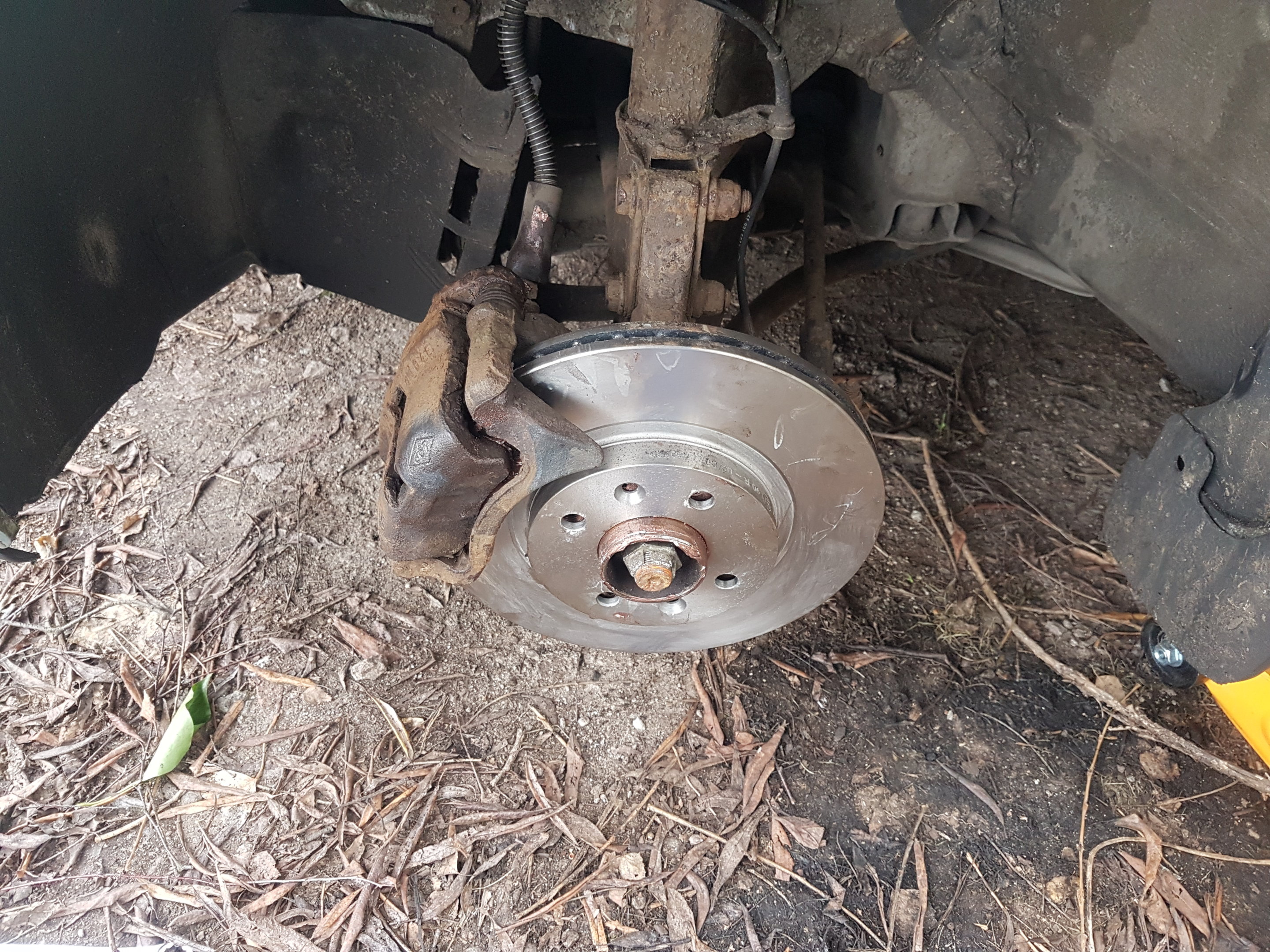

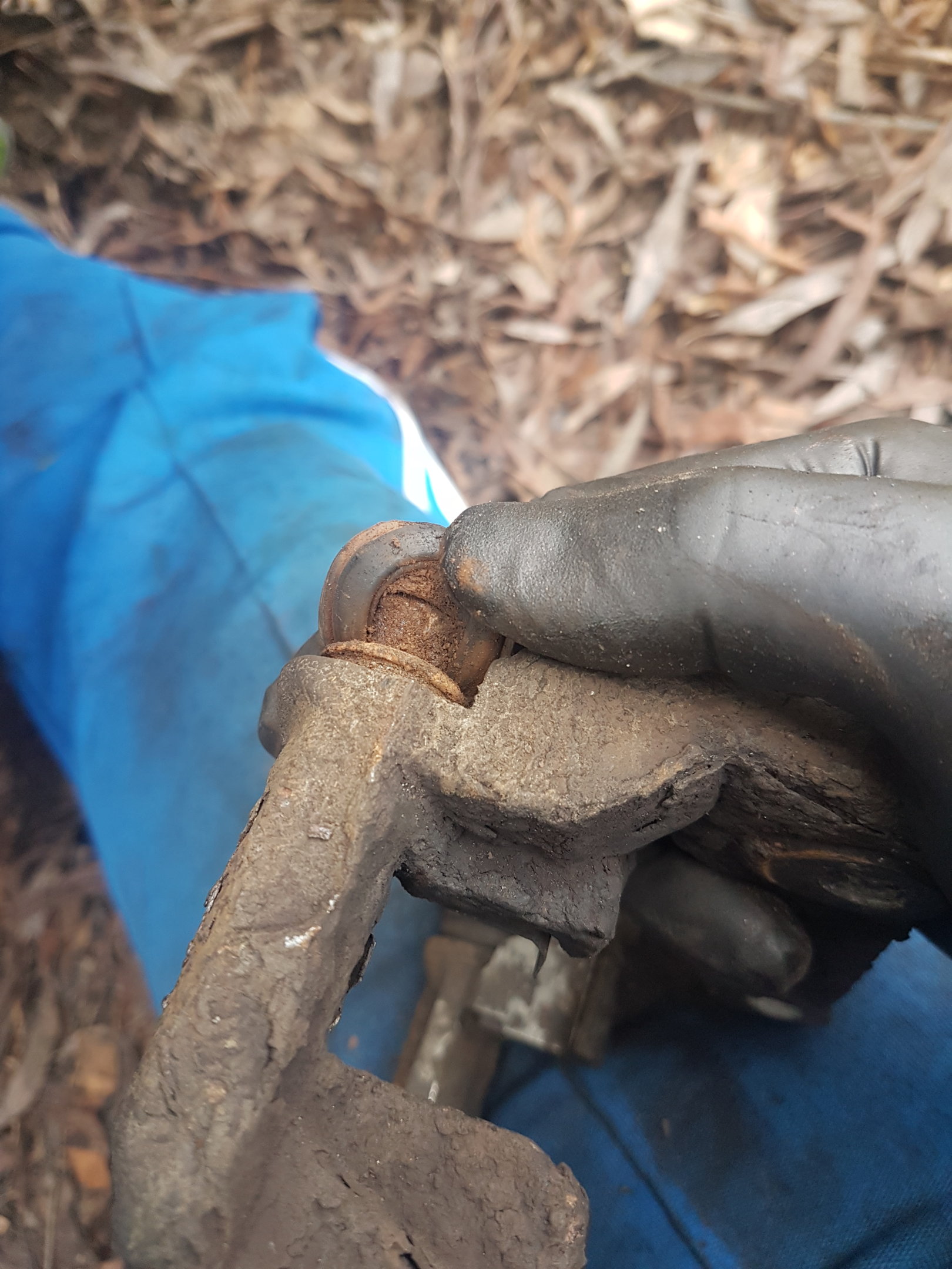

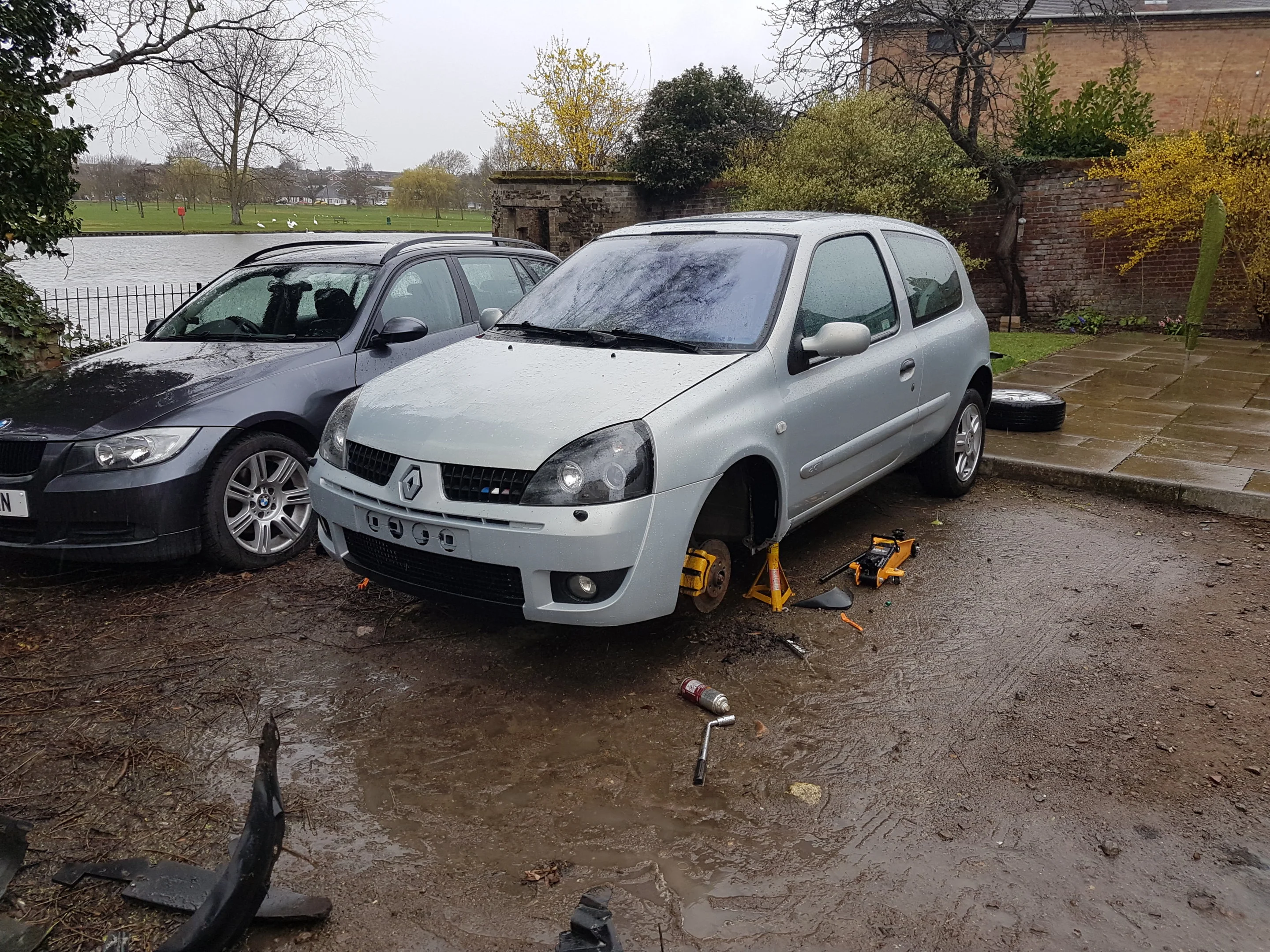

Next job was the brakes, I'll include some photos on this below but the lower slider bolts were a nightmare which I'm guessing is a common trait, it took half an hour each side to free them off but discs and pads were changed for a grand total of £33 from Euro car parts. I even gave them a paint too (sorry but I could resist and had spare time lol)

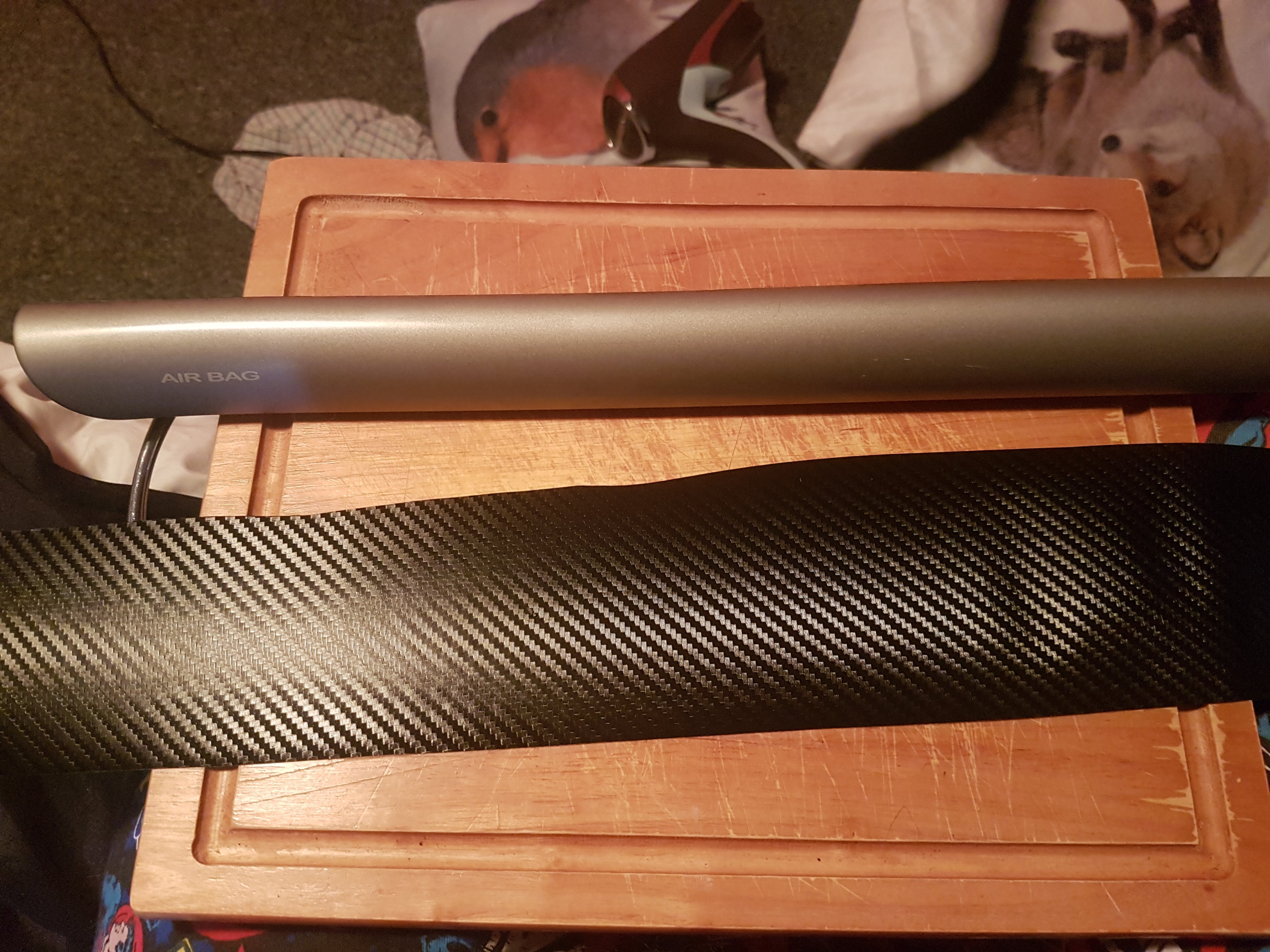

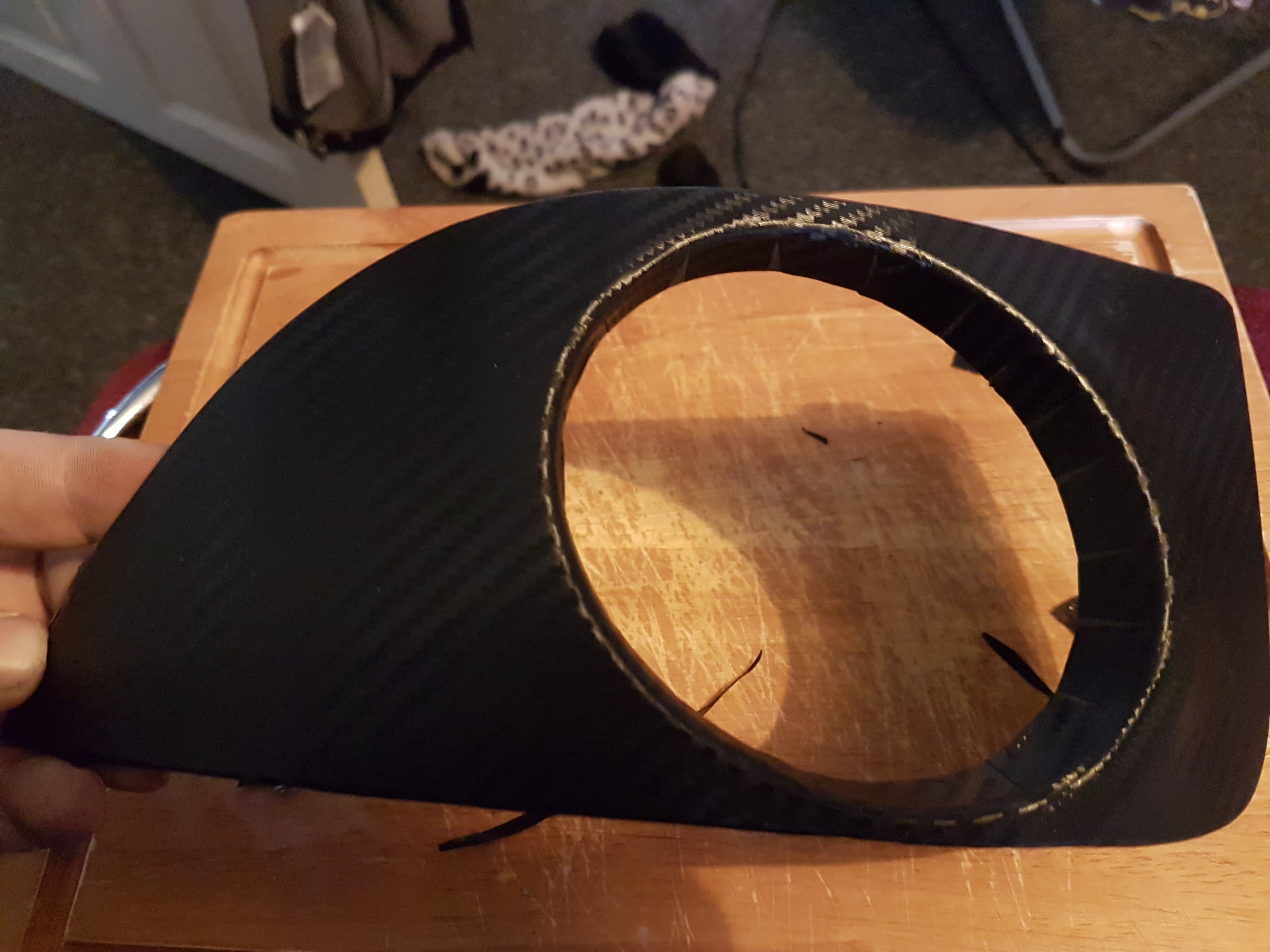

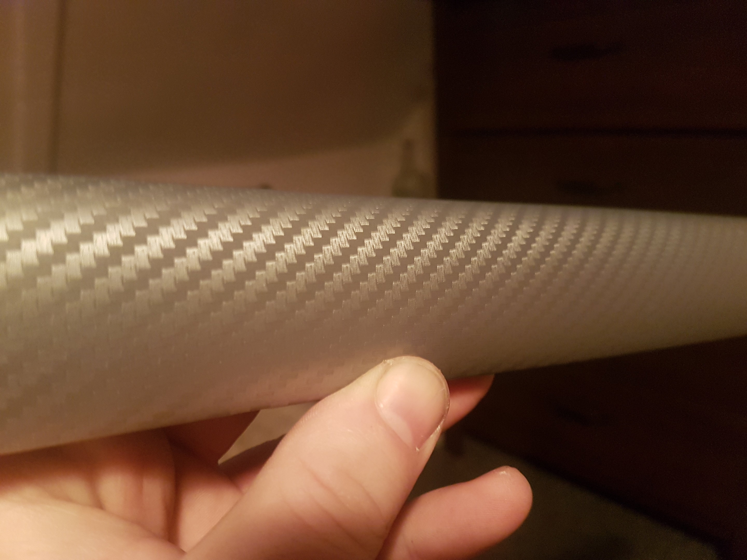

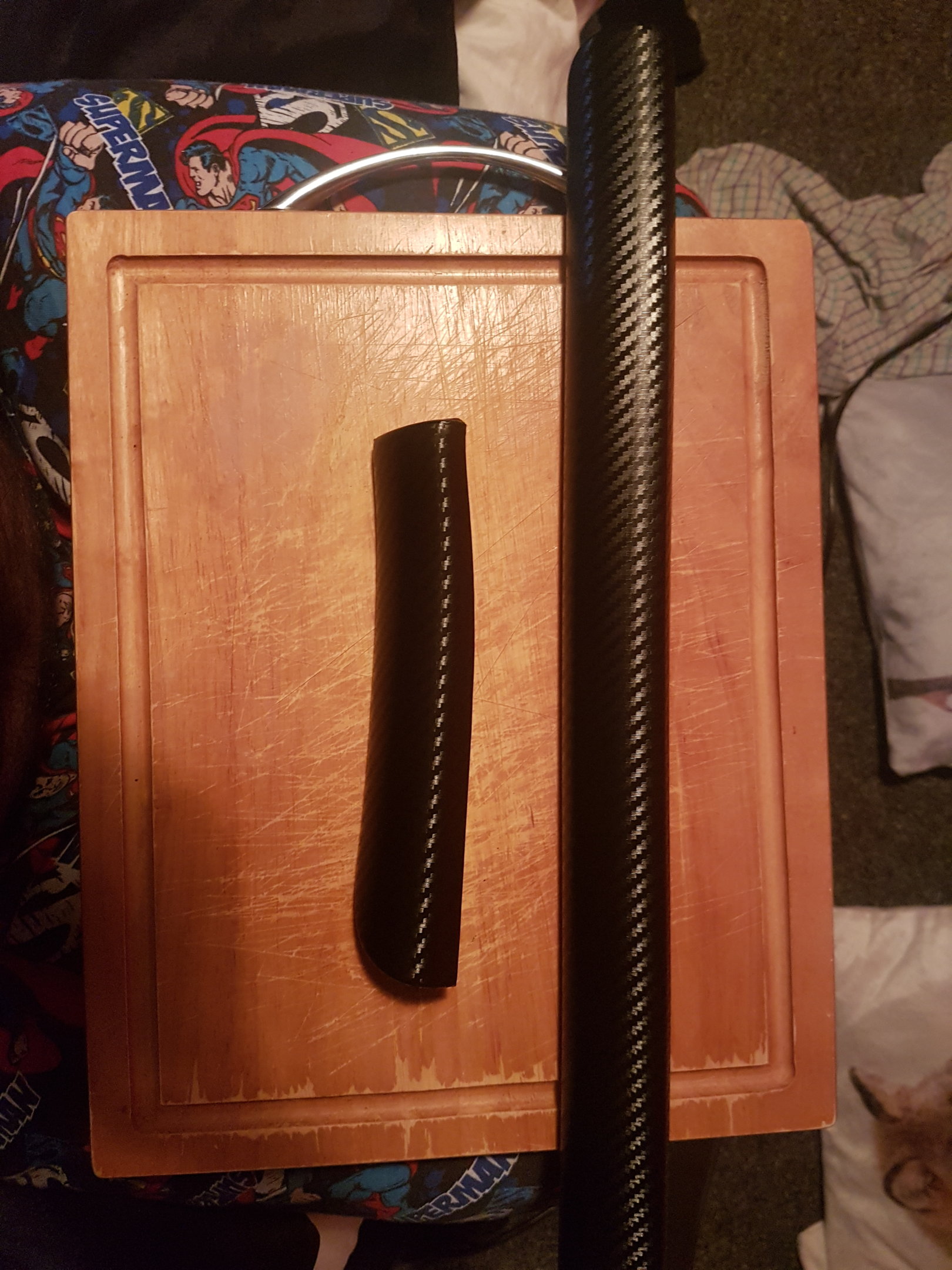

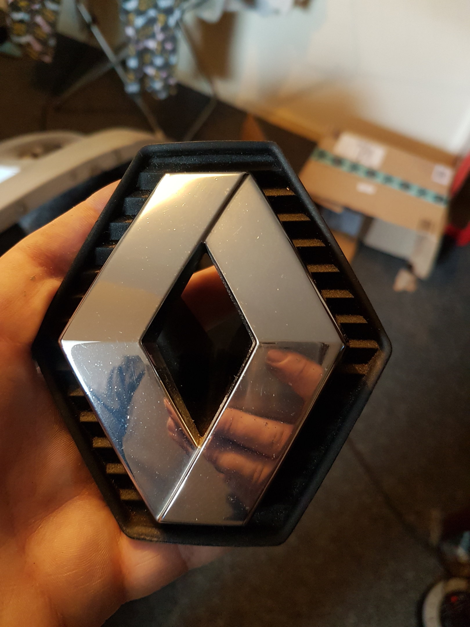

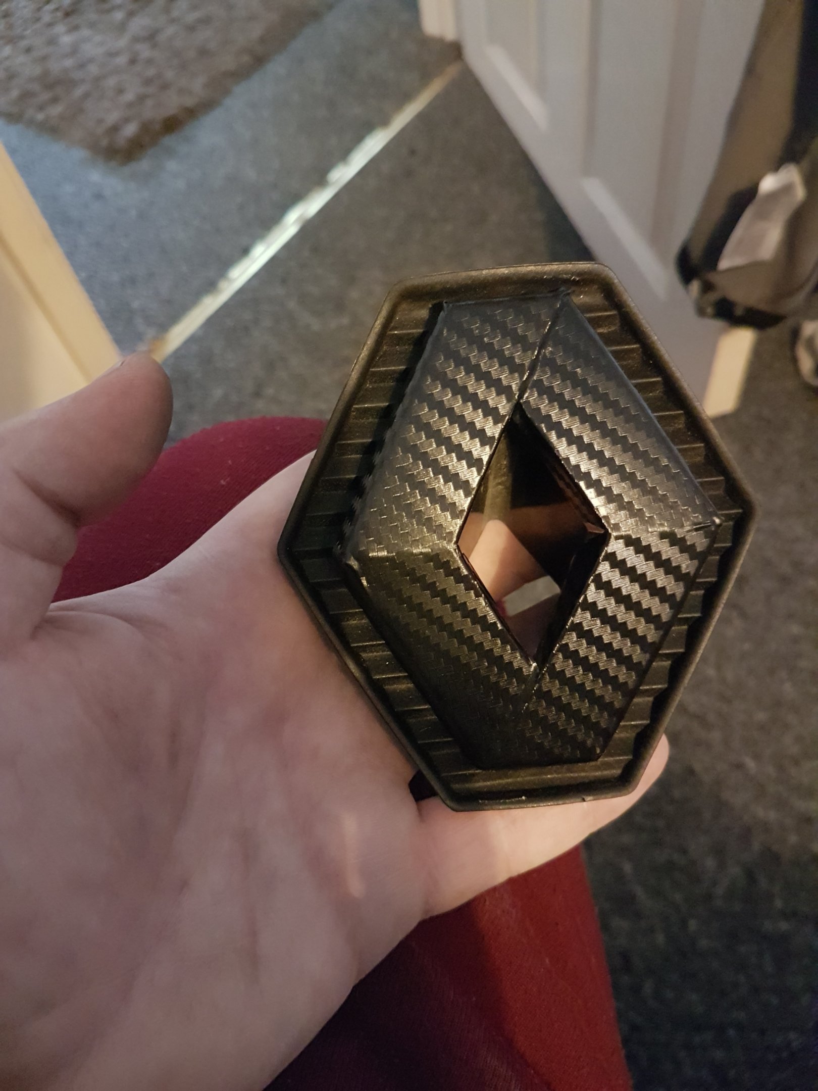

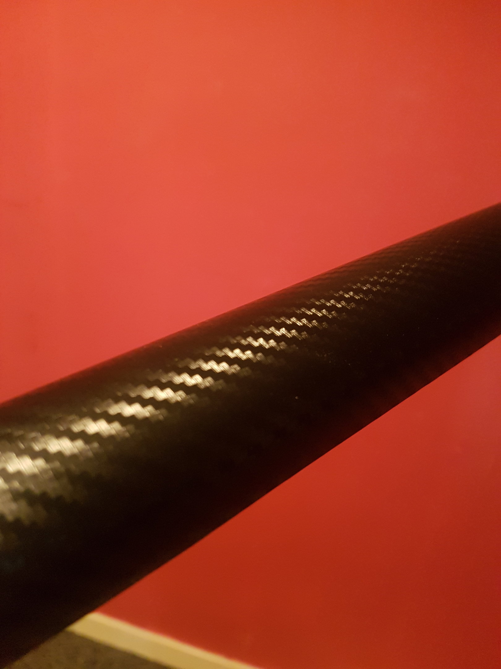

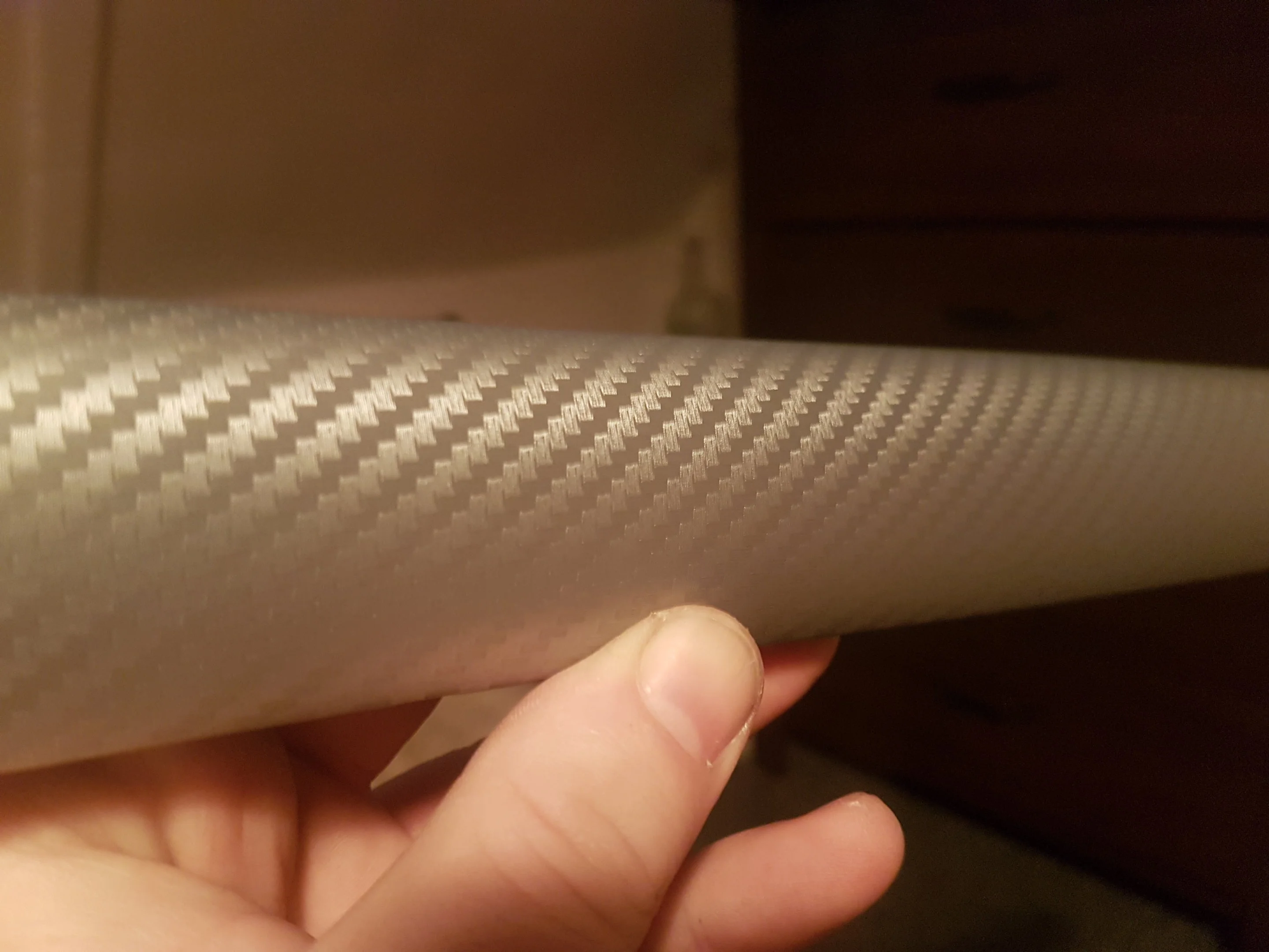

Then I decided to do a bit of carbon wrapping with the interior panels and badge (I'm gonna redo the interior ones silver carbon) at the same time I switched out all the interior bulbs for LED's and replaced all the blown bulbs and this is where I decided I'm going all the way. I got a sport front grille and sprayed it gloss black and decided the whole sport kit is going on. I pick it up tomorrow

Mine also needs discs/pads - which ones did you buy from ECP? There’s 2 options on their site! ?
I went for the Eibach ones. Mine were the vented ones which I think 90% are. make sure you check the box before leaving the shop though as twice in the past I've had to return discs as they weren't the right ones in the box.
the bottom sliders were an absolute pig to get out so you might have to be patient with them as it looks like it might be a common issue but they soon cleaned up with some wd40 and wire brush.
I would assume so, did you enter your reg number in? I know when I did it said there was a choice but when you look closer the choice was between front and rear and I didn't have rears ?
part number was 104745169 for mine so should be the same.

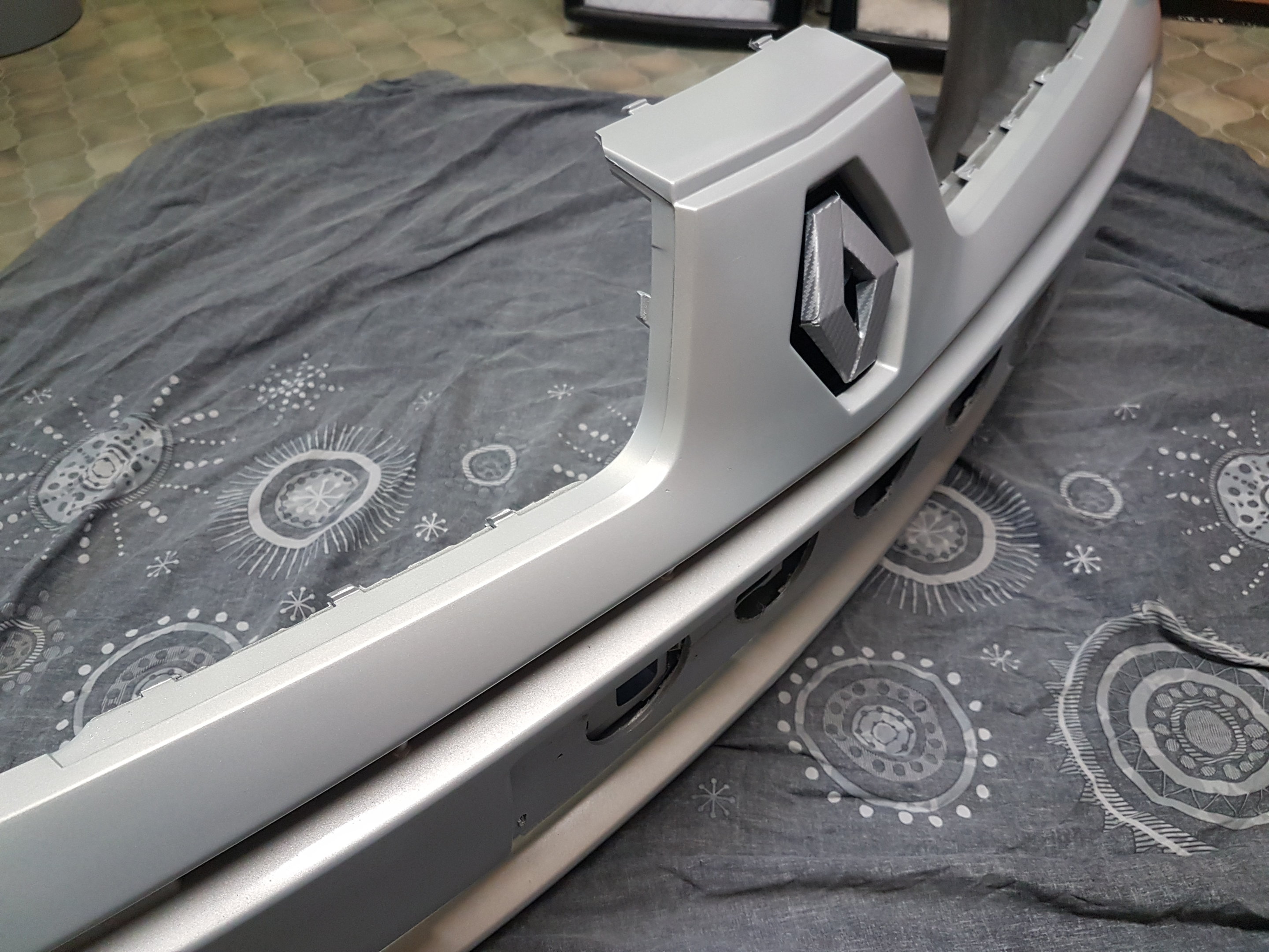

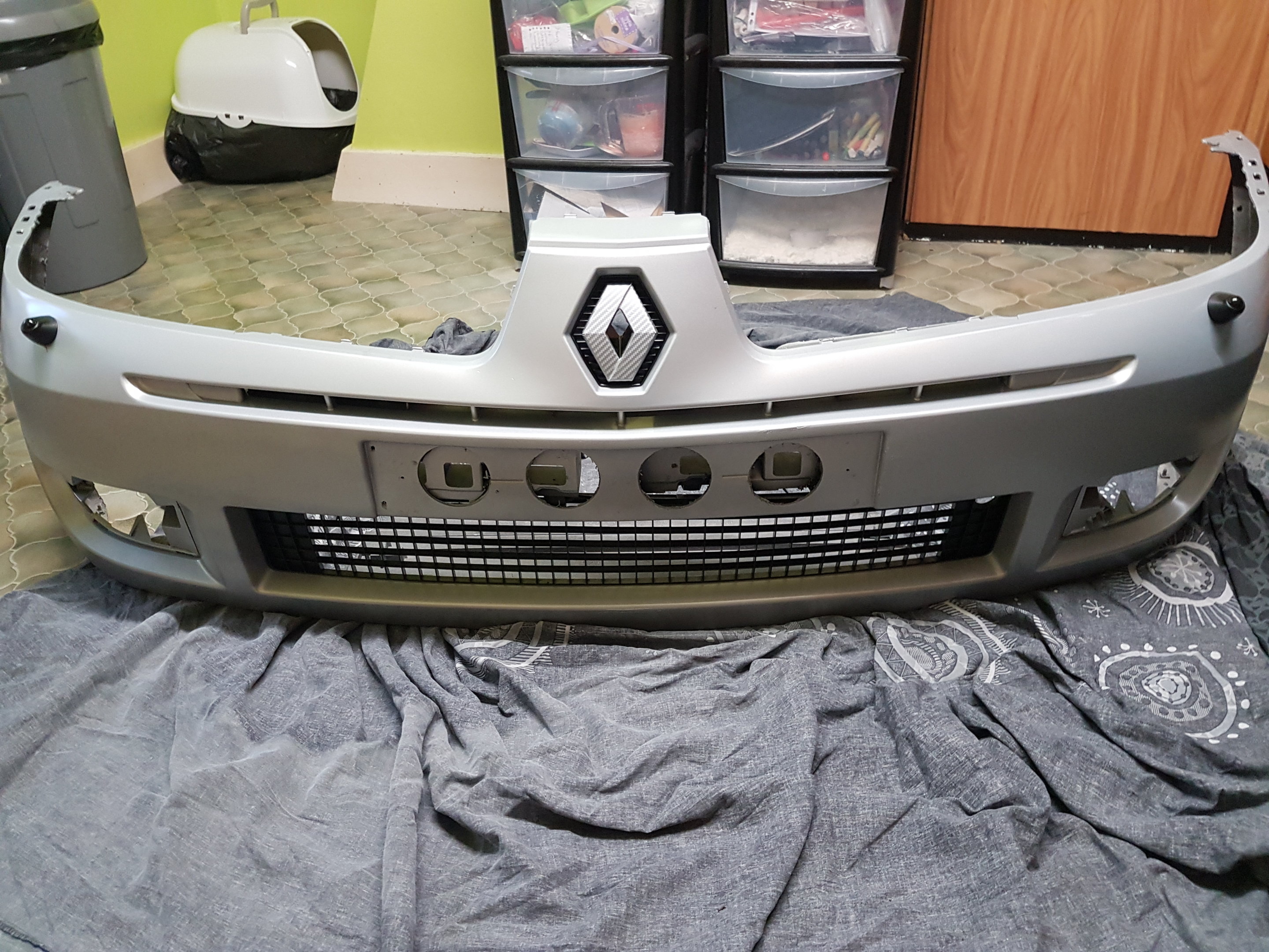

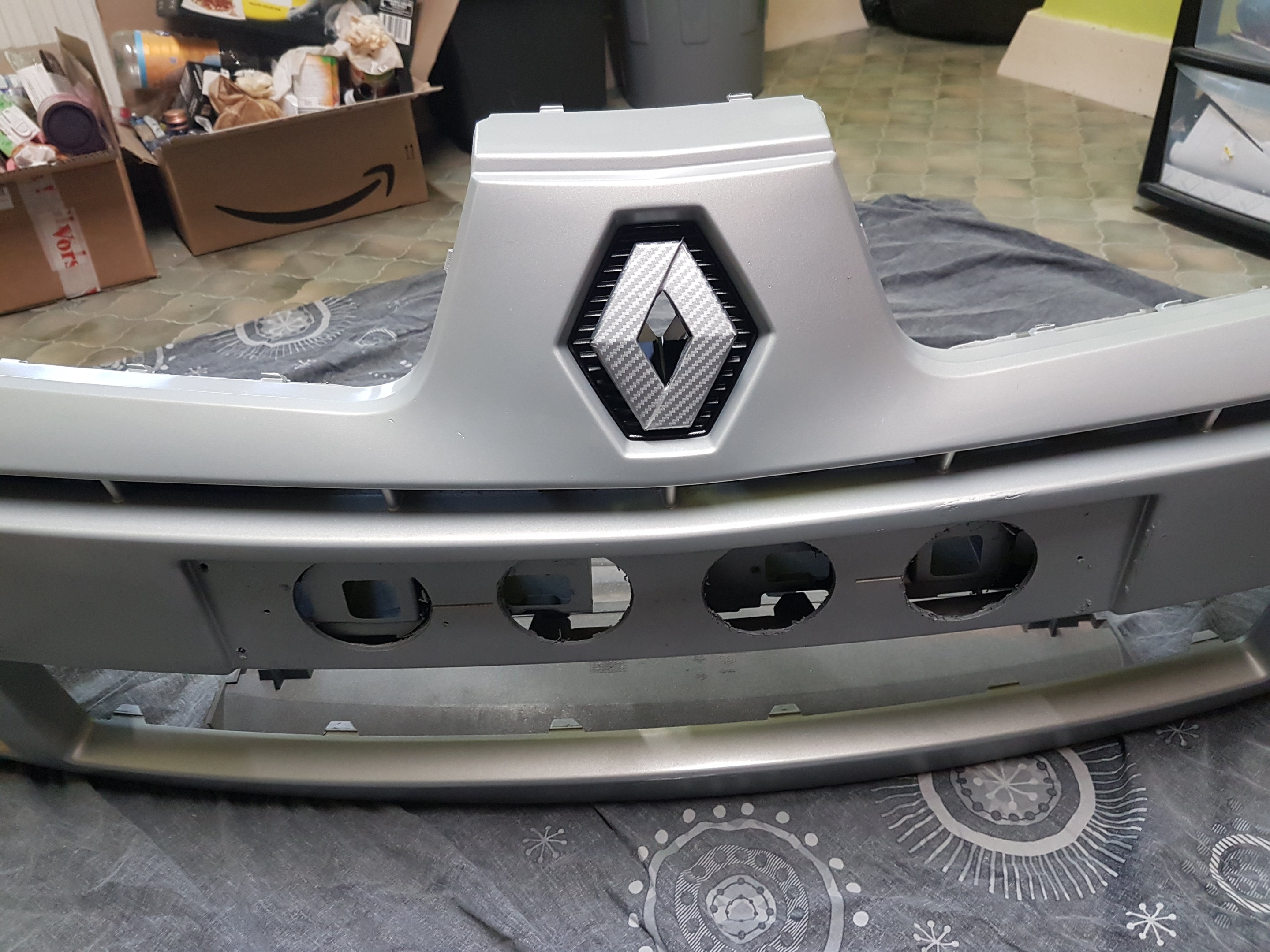

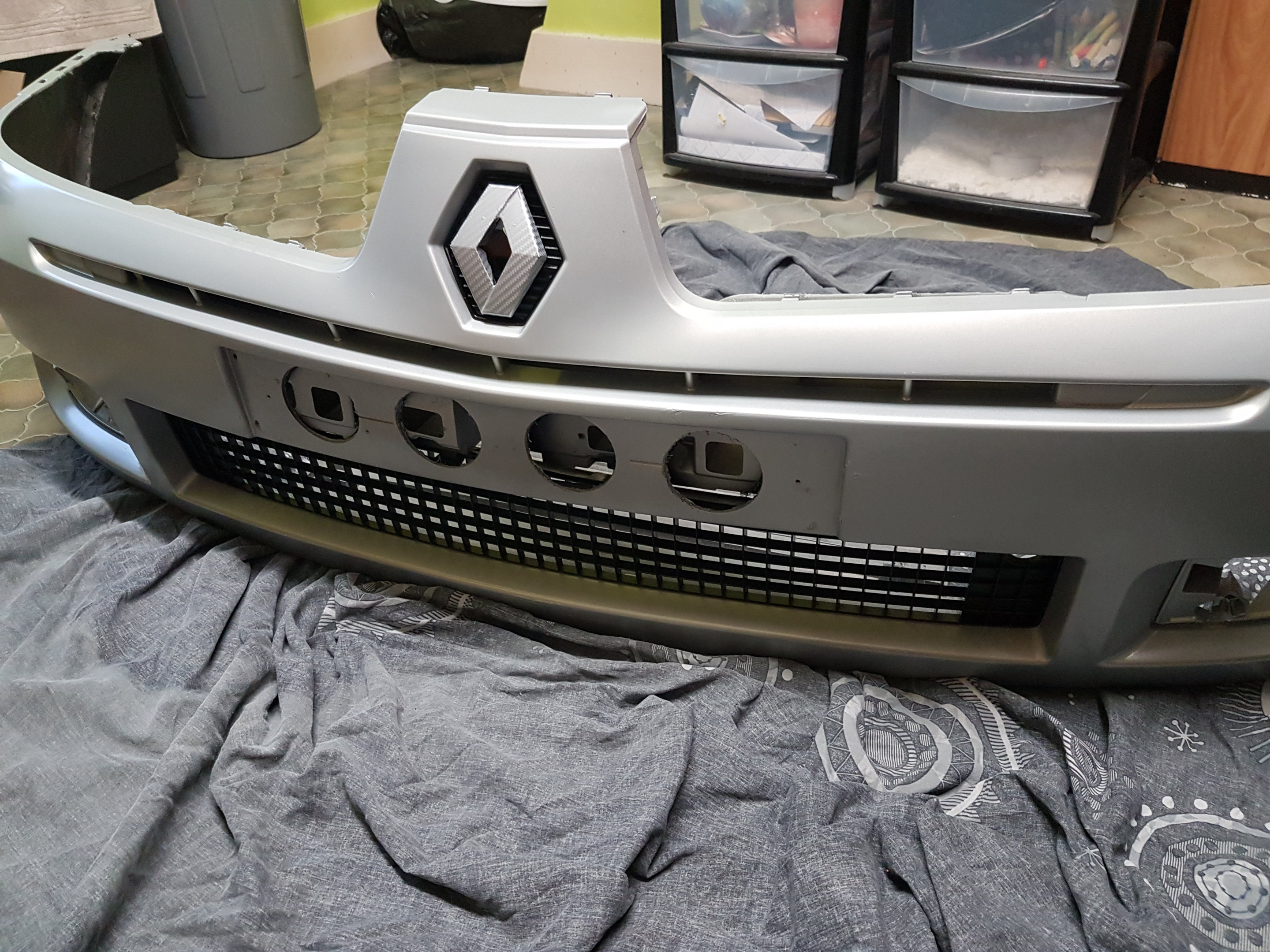

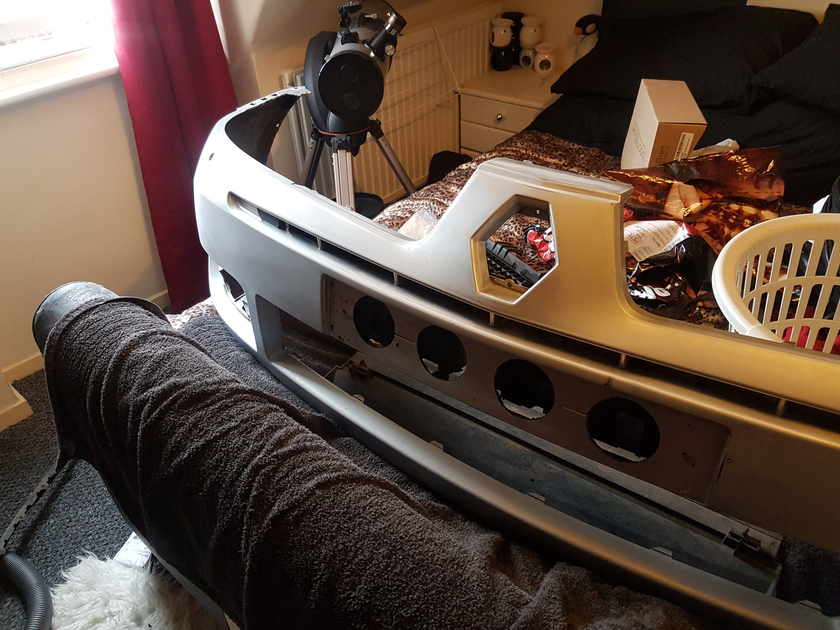

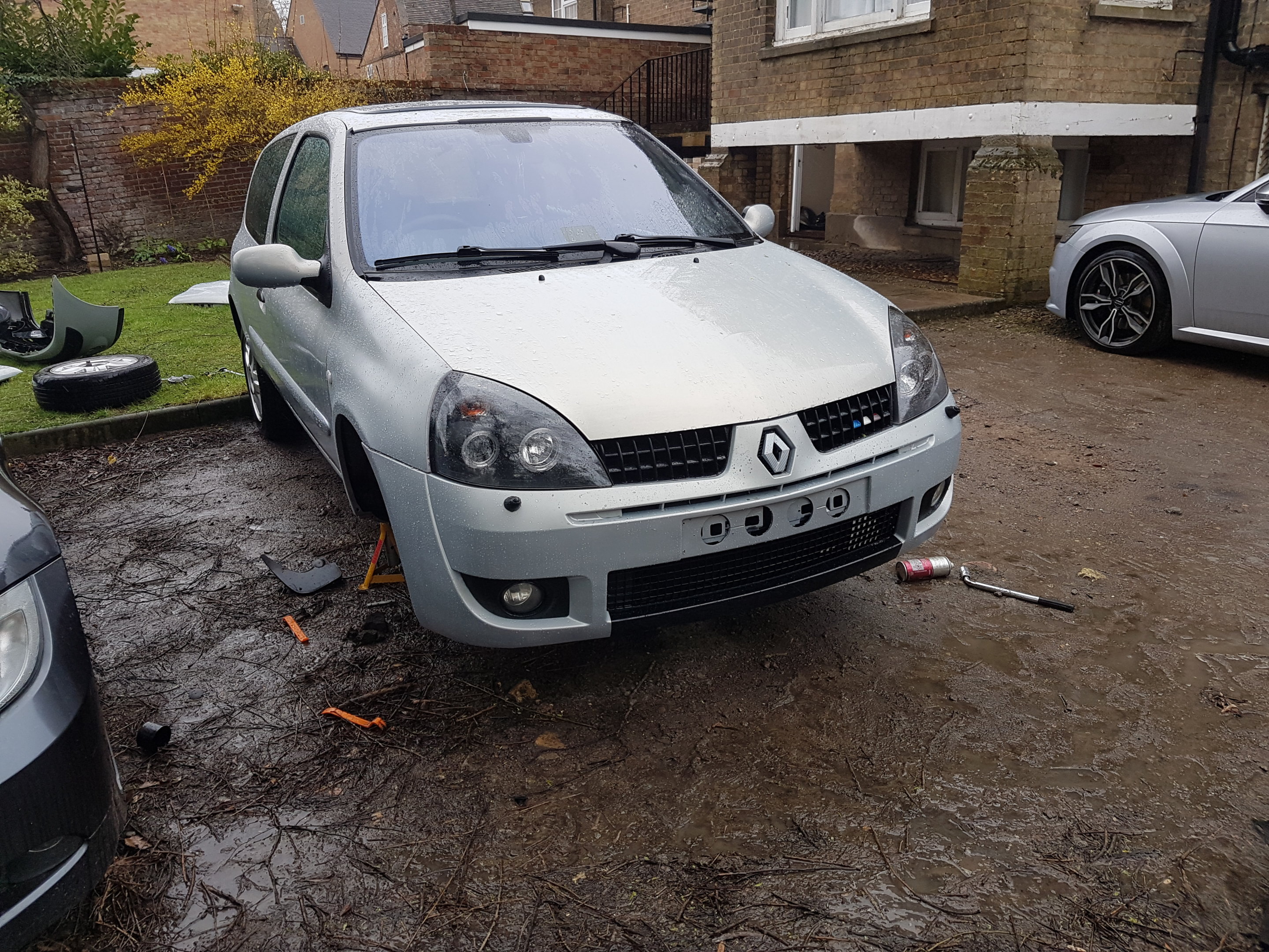

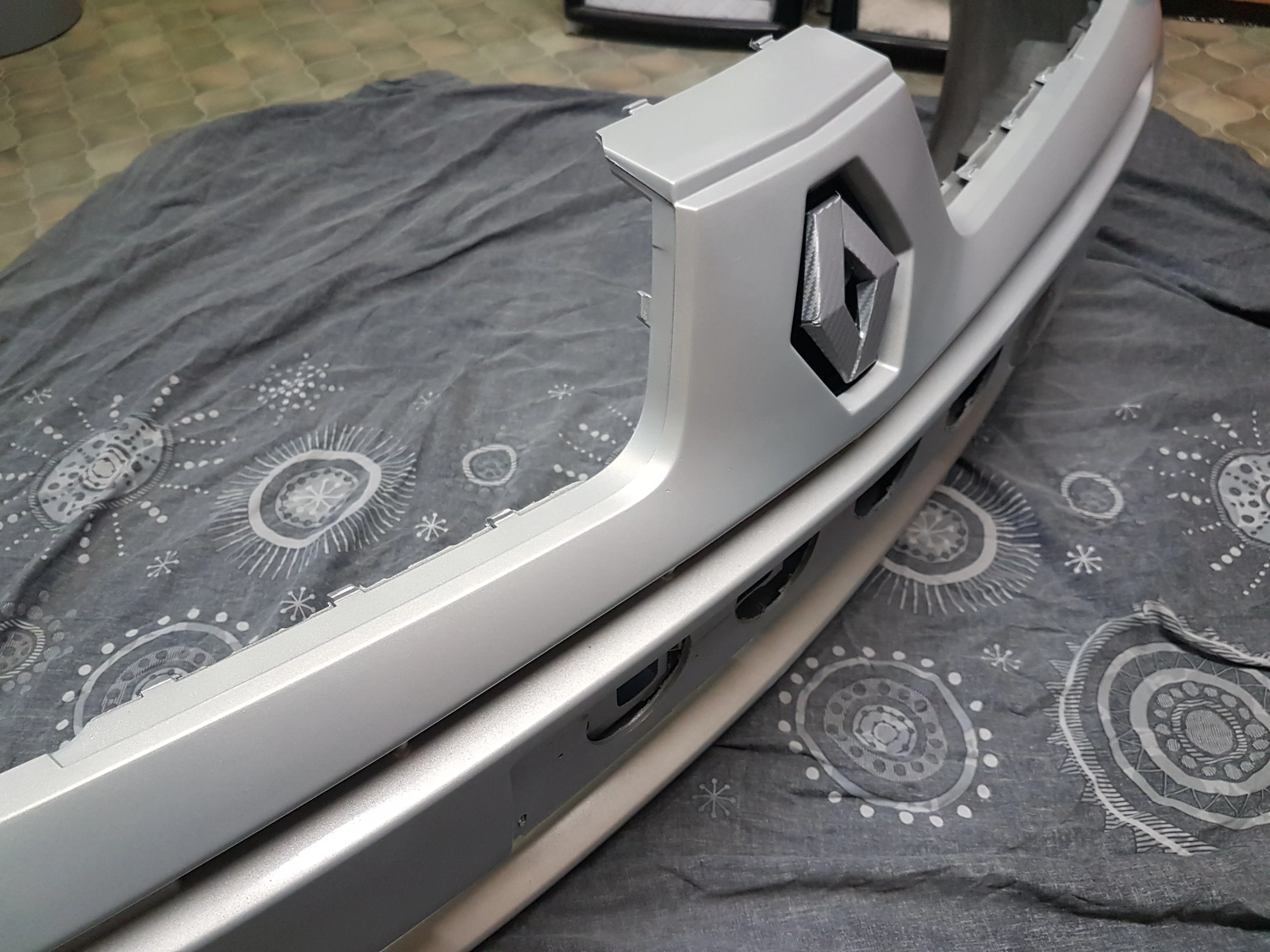

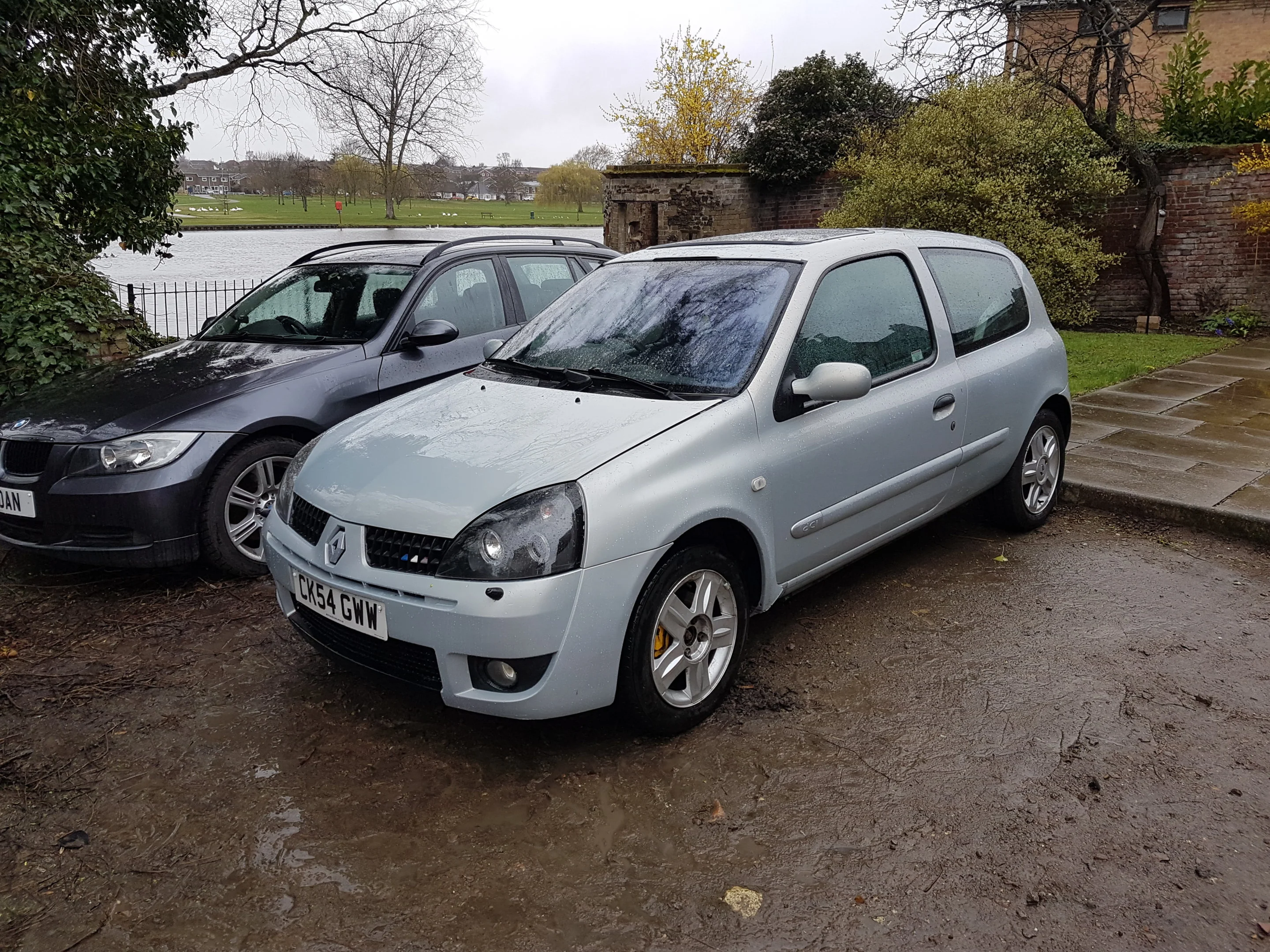

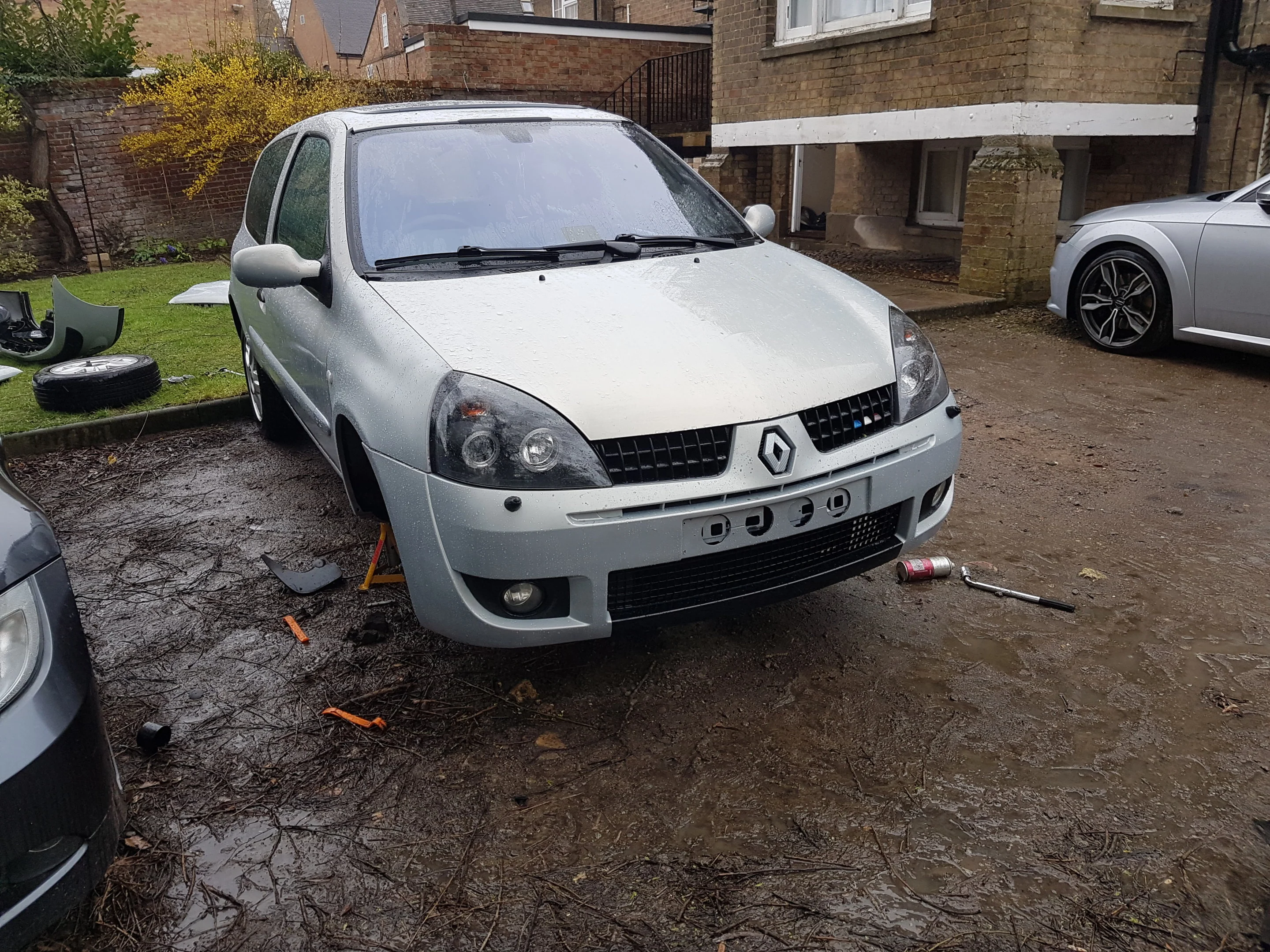

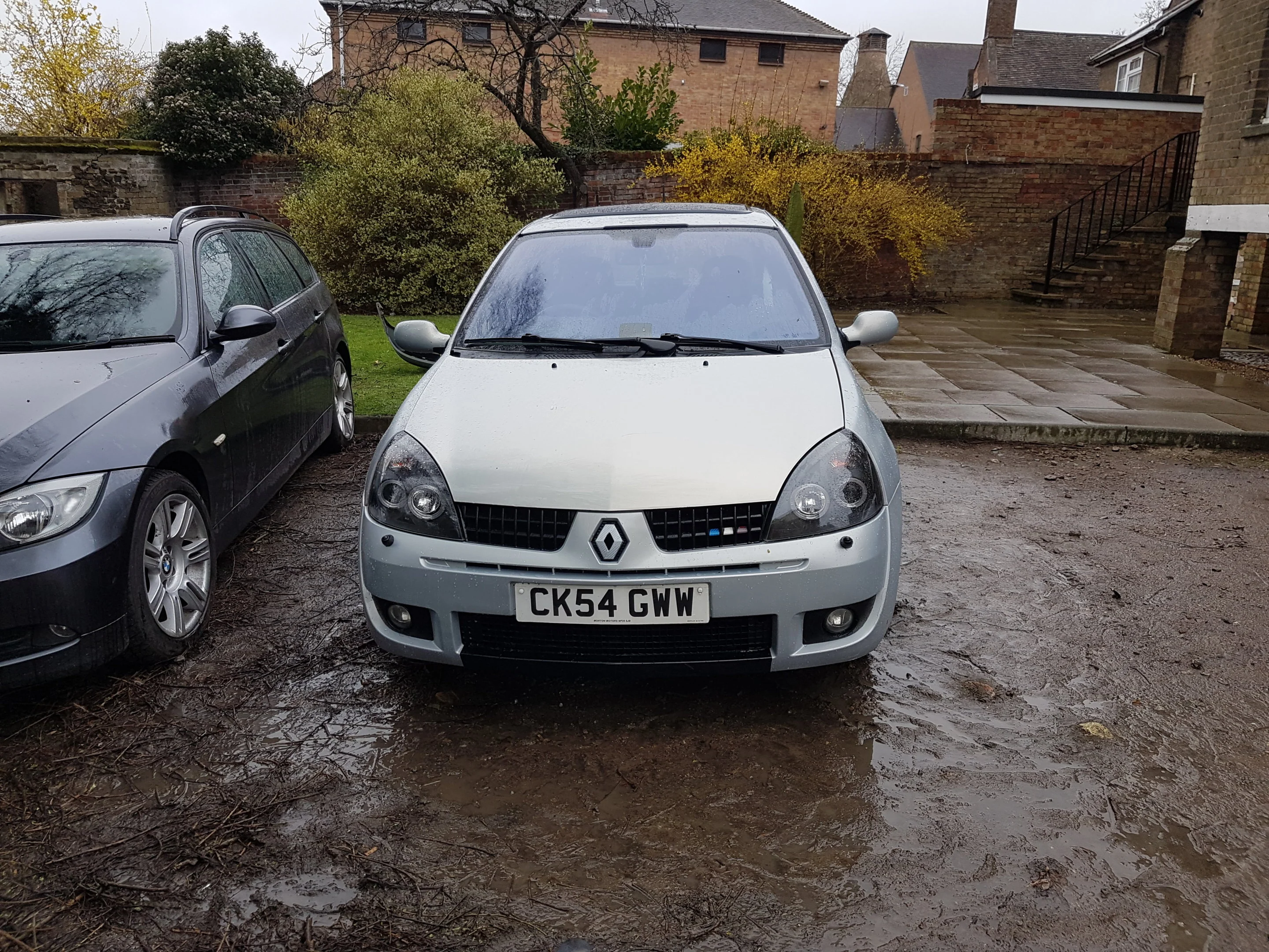

So today I got round to spraying up the front bumper (I figured I'd start at the hardest point) really happy with the colour match too it's poor light . sprayed up the grill and jets gloss black too. the carbon badge was just a spare I had to experiment with, it'll be between that and a black one I think. excuse the mess ?
I'm trying to decide whether to wrap the bottom part of the bumper under the grill in black too or not..... thoughts?
Fair play to you, the bumper looks like a tidy job too!
I’d leave the bottom bit silver, personally.
Keep the pictures coming :)

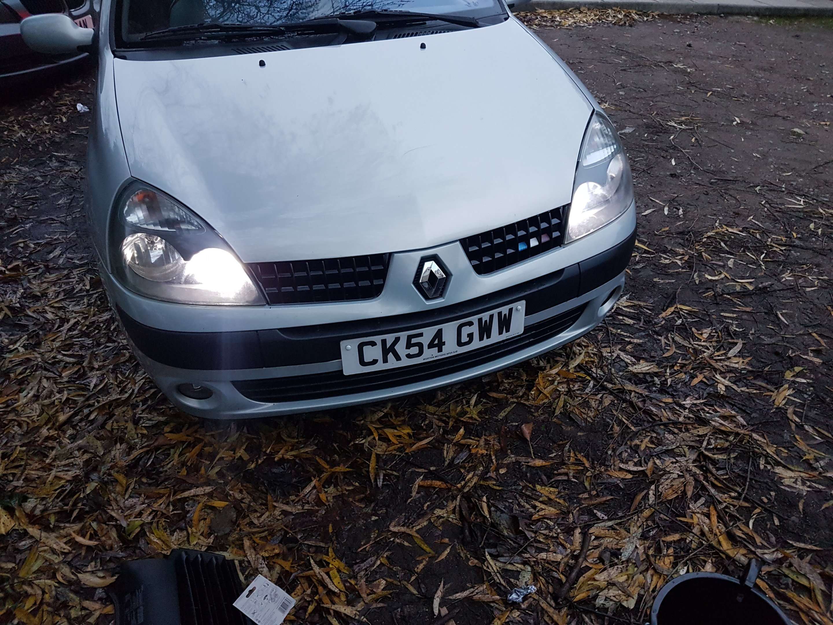

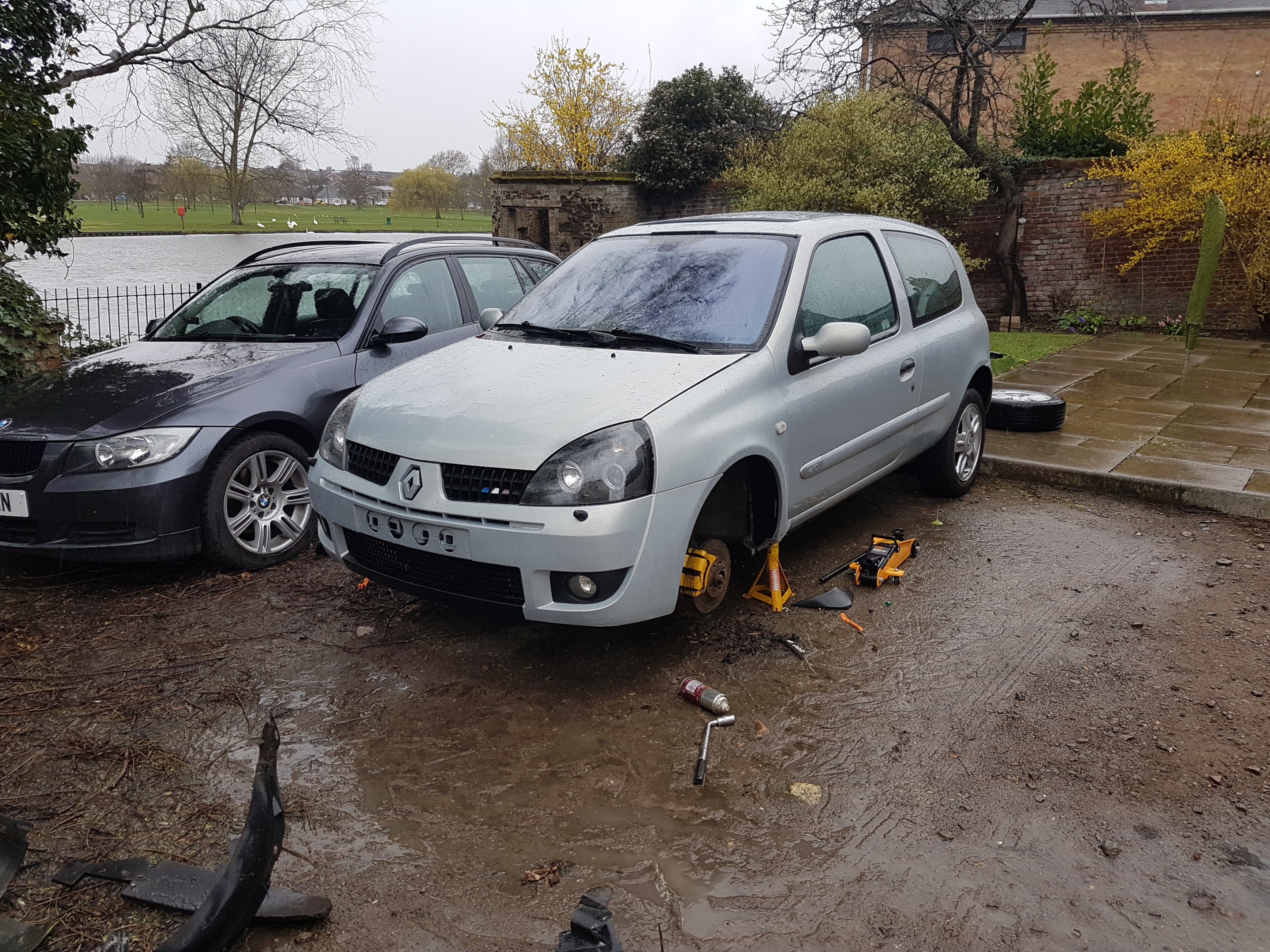

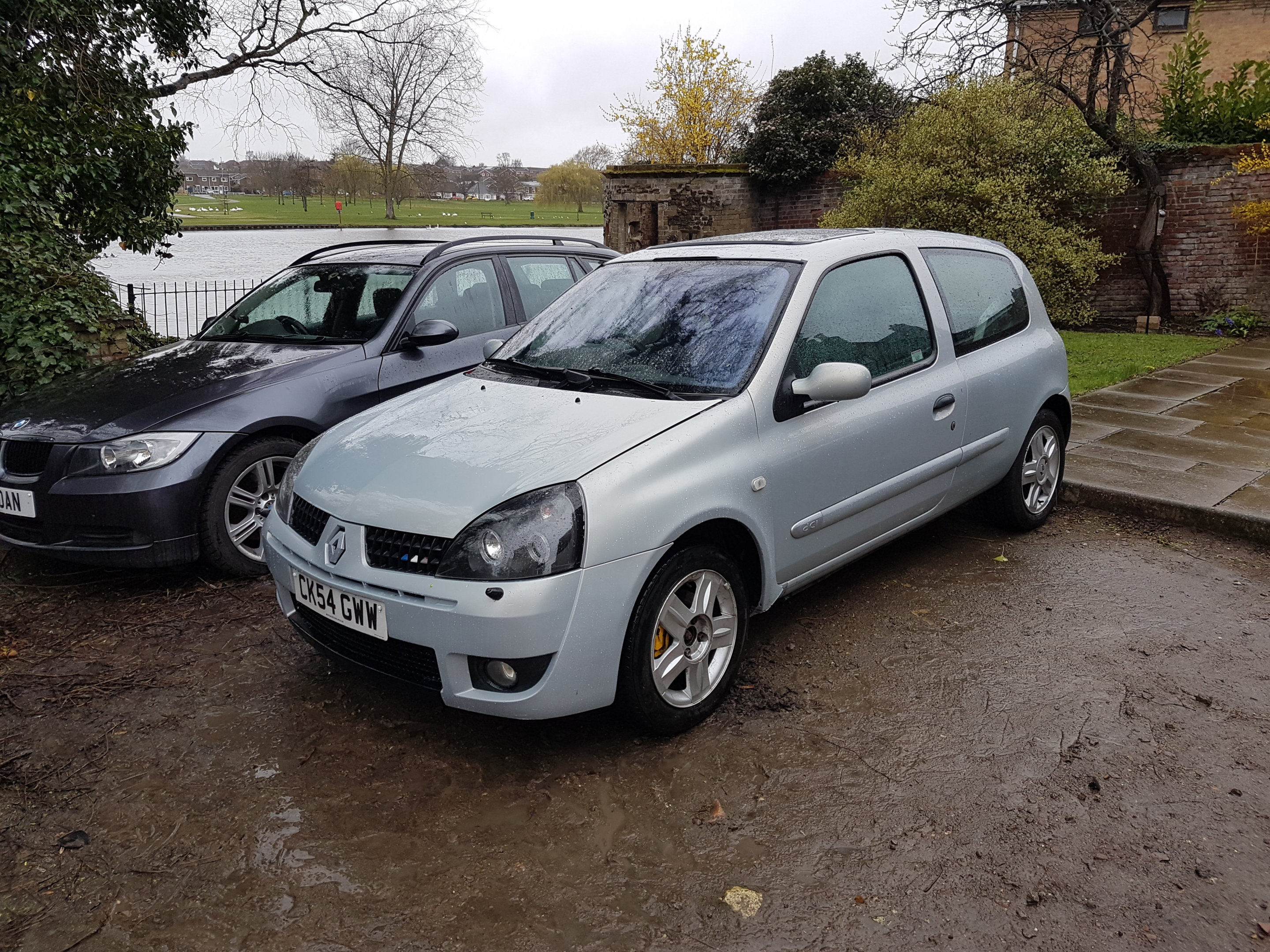

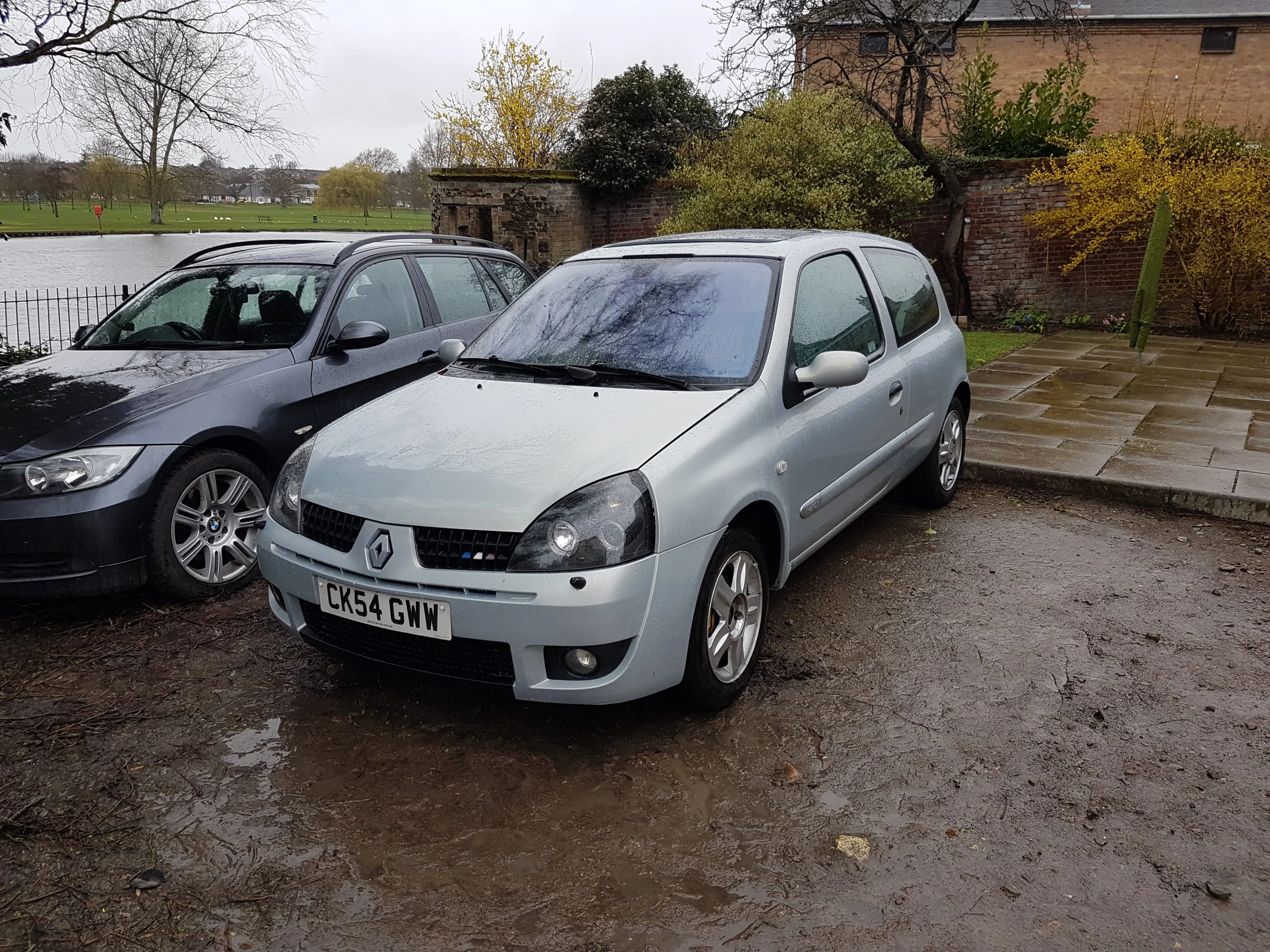

After a few months cluttering up the spare room I finally got the time to fit the front bumper, wings and lights I'd picked up today. I also got the bump strips sprayed up while I was spraying other bits. literally an hour in and the heavens opened so the pics don't look too great but I'm over the moon with the paint match. now laid in a red hot bath trying to feel my limbs again ?

I have just bought into the 1.5 DCI world too! £20 a year tax and 65mpg! Good updates. The sport stuff is a real good addition. See you went with the black lower bumper center.
