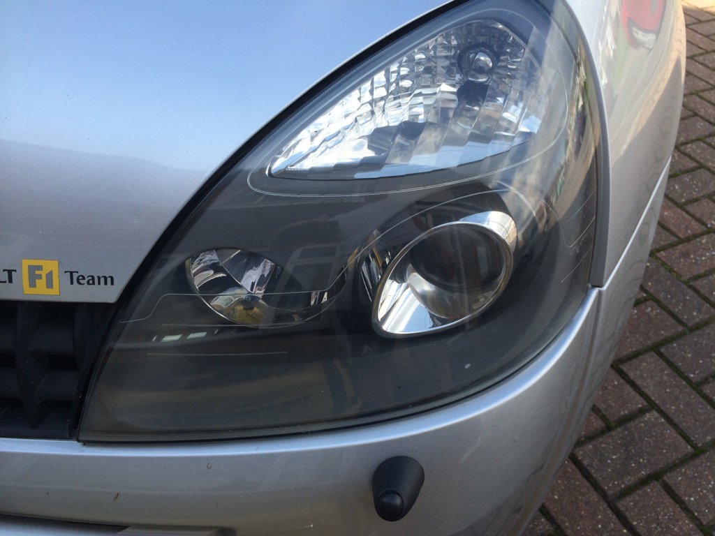

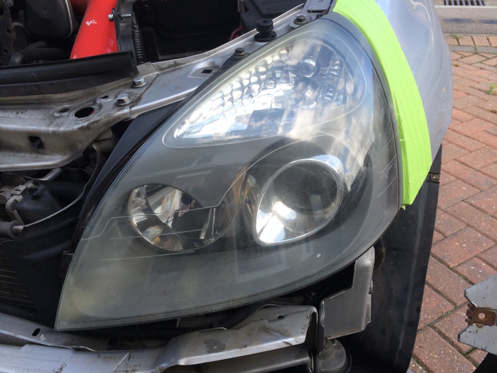

Had my MOT today and the state of my lights came up as an advisory. So i'm looking into getting them done, any recommendations on kits and is it straightforward for a complete novice like myself??
