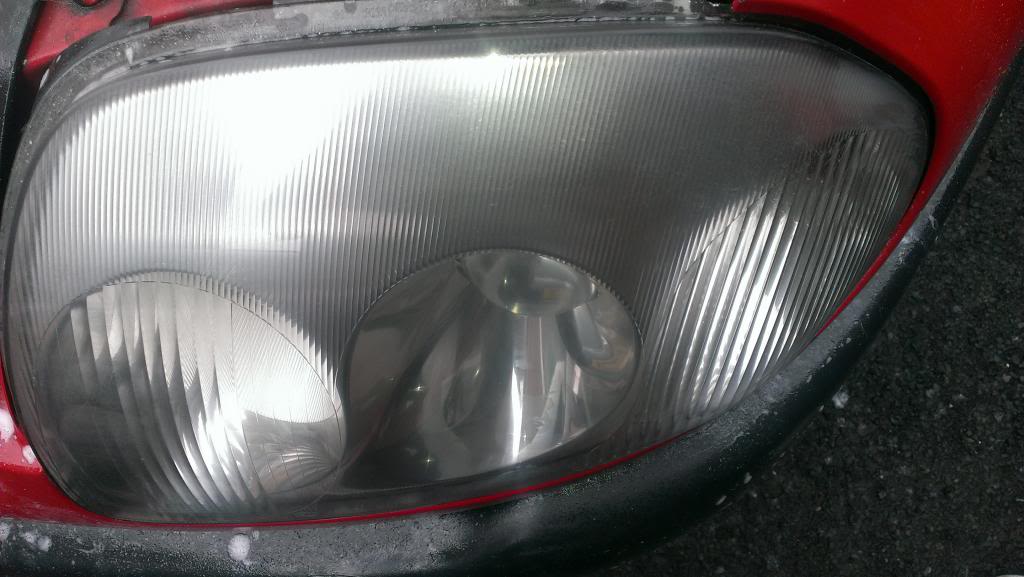

so instead of sitting around today scratching my nuts I decided to restore my headlights as they realy let the car down,
things needed were as follows
900 1000 and 3000 grit wet and dry sandpaper
some plastic polish I used Maguire's plastx
and some plastic sealer
[/URL][/IMG]
about 15 mins later and a dead arm
looking good, I used the 3M kit for my last mr2 which was the dogs, but its hard to get hold of in the uk, plastic-x looks like it does the trick tho :)
