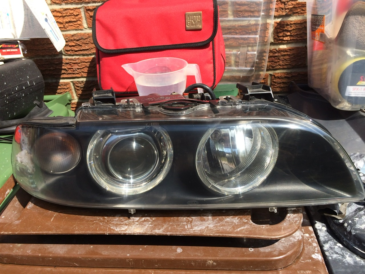

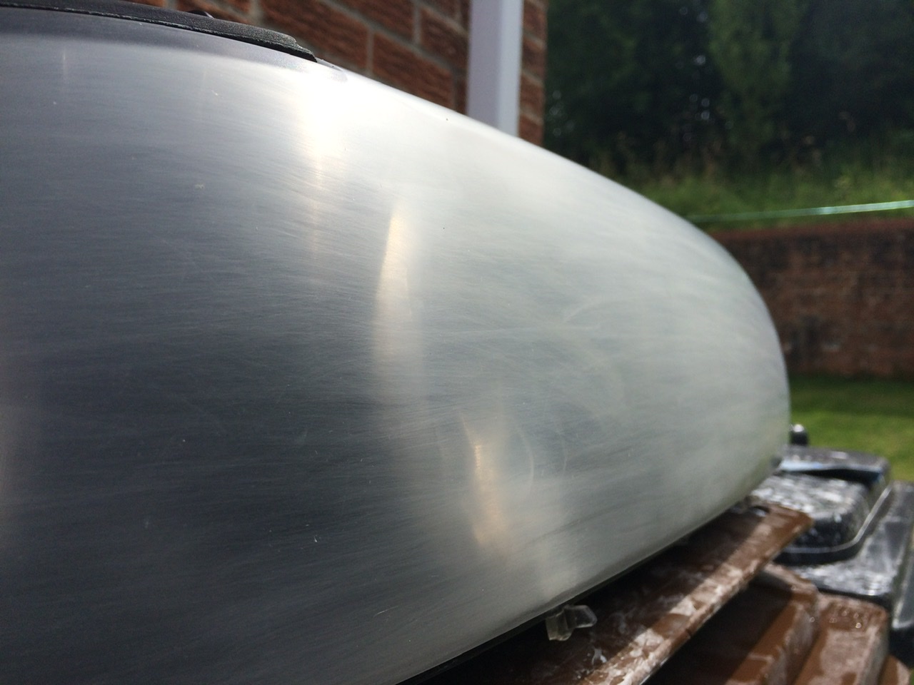

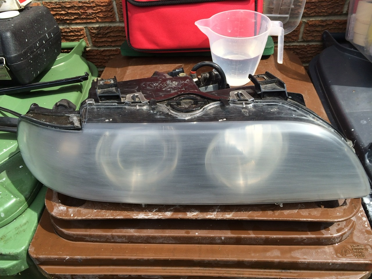

I didn't use a kit as such, I followed a couple of guides online, which just used progressively finer grades of wet & dry, followed by polishing with a DA to get that final finish. Will see if I can find what I followed.
When you start at first and the lenses are all hazed up from sanding, you think "fcuk I've ruined this" but as you keep going things improve and suddenly they're crystal clear, just a bit dauting at first.
The difference was massive though, they were a right mess before, looked almost new after, will upload some pics.

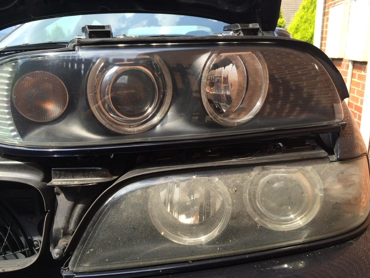

Rich-D
  E90 LCI 330d
Here you go…
Before & after for comparison:
Mid grade stage, when I thought they were never going to be recoverable:
But ended up looking like this:
Just take your time, it's not difficult and that was my first attempt.

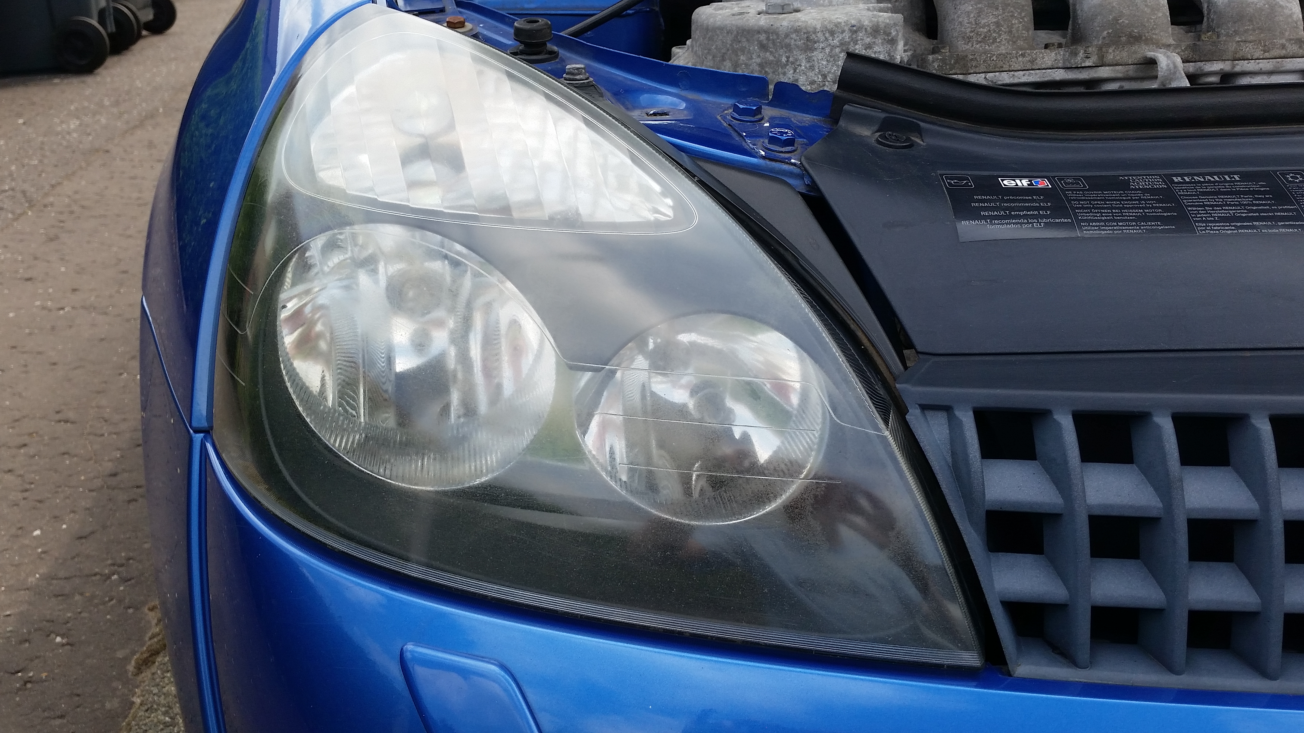

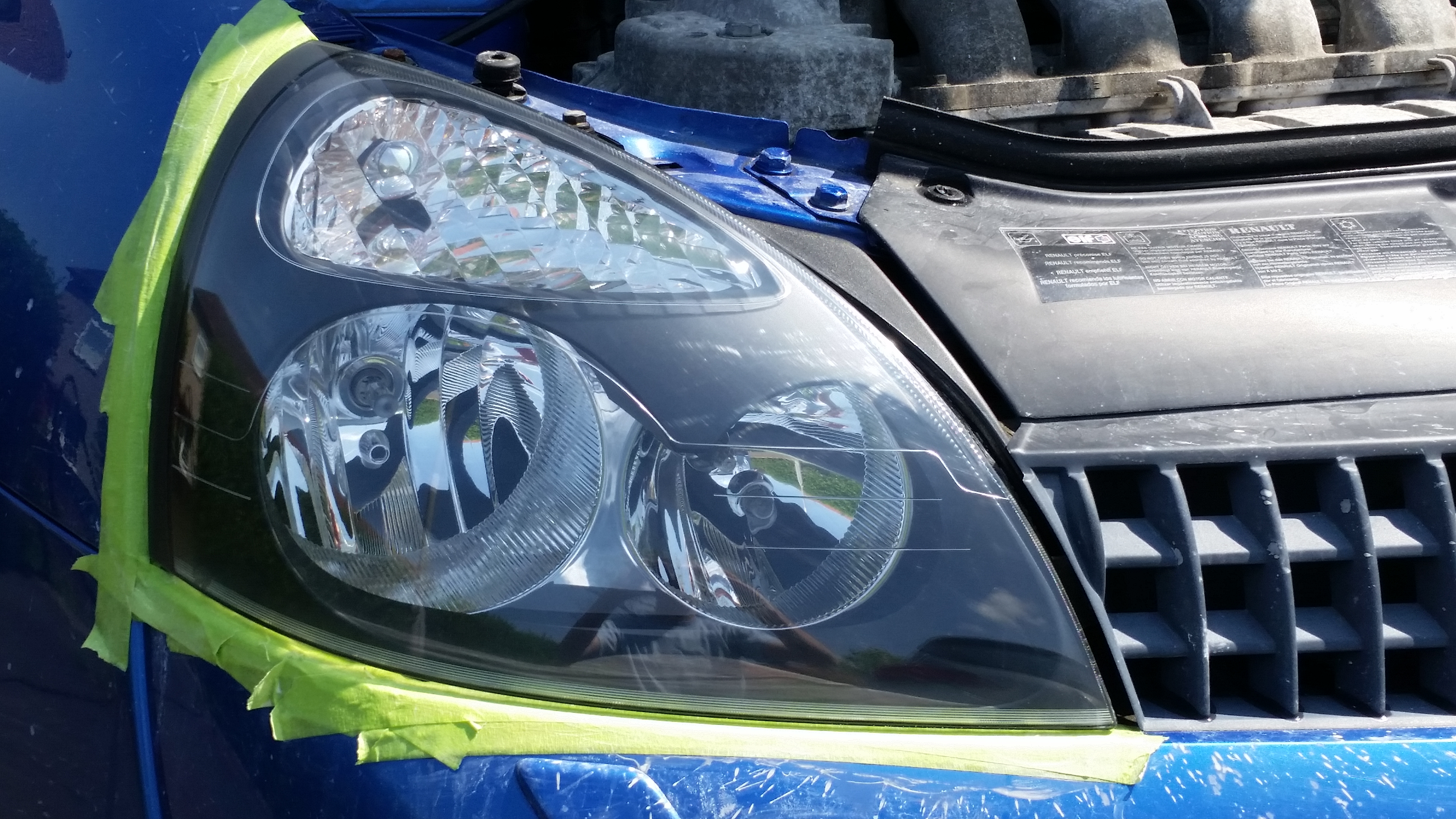

Steering Colin
  172 Cup
I used the 3M™ Headlight Lens Restoration Kit. Think it was around £20 a few years ago.
I did regret not closing the bonet before polishing as it went everywhere...lolol

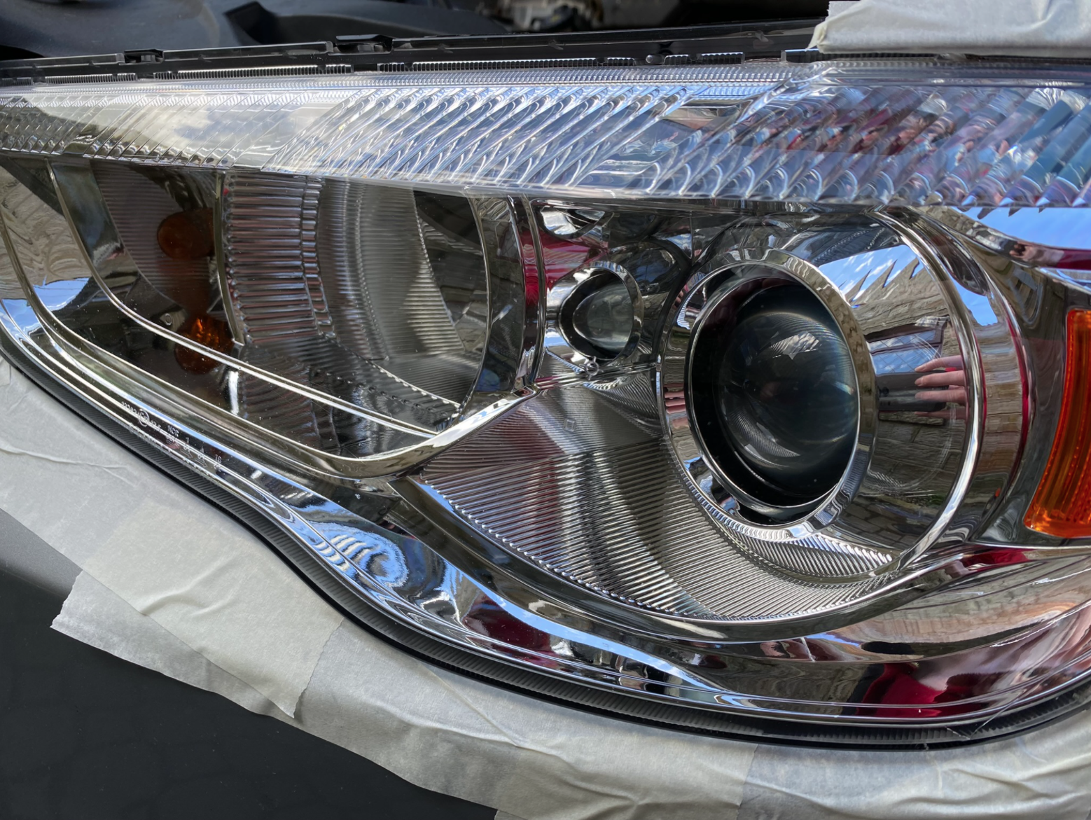

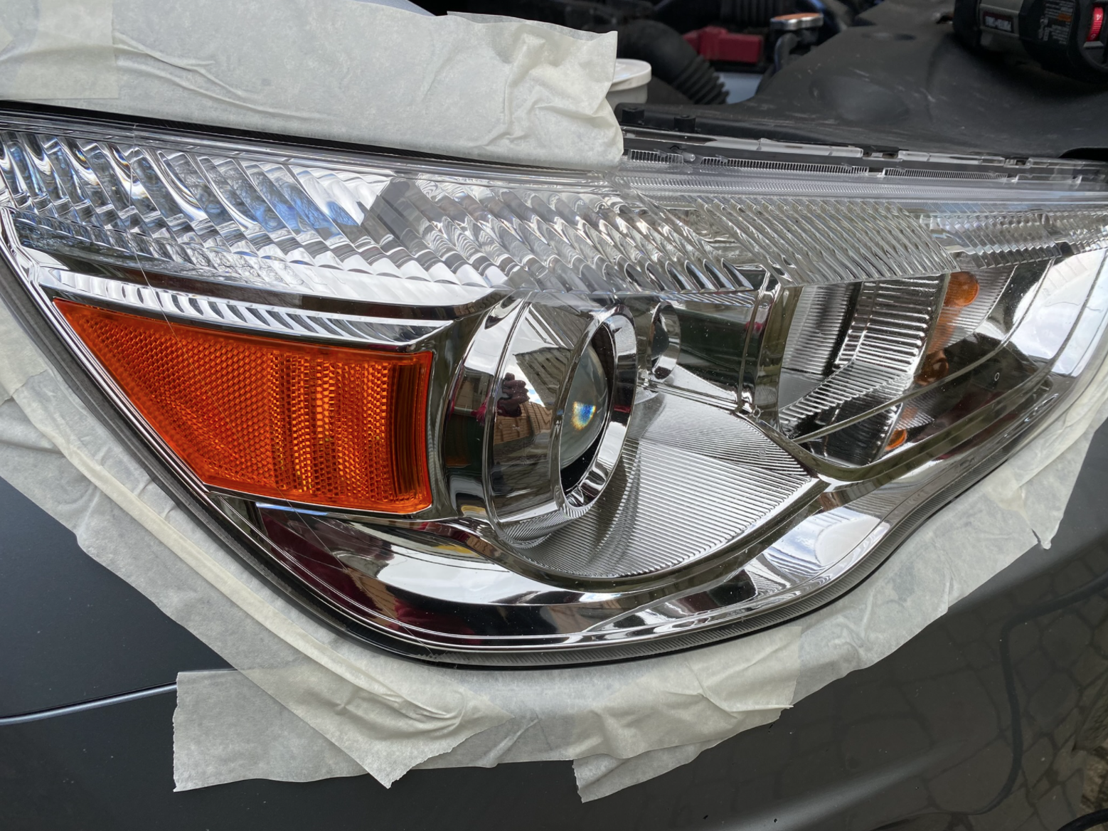

Darren S

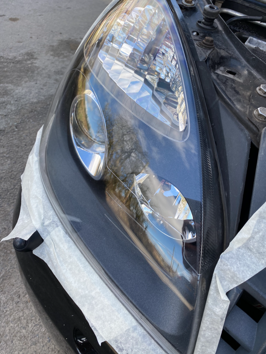

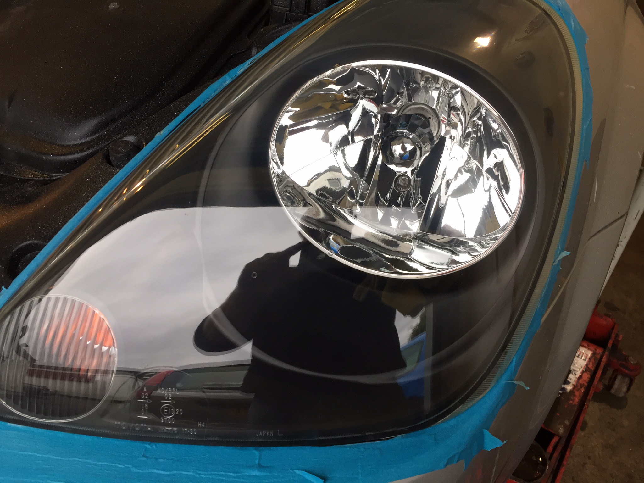

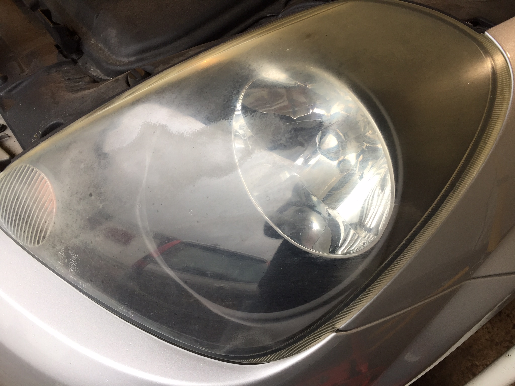

Went out this afternoon and did the headlights on both cars. No idea where my 3M tape ended up, so just used standard masking tape - better than nothing I guess. Just used the combination of Chemical Guys headlight restorer that I mentioned previously and the Porter Cable set to mid-speed.
The 182 ones came up well, but those on the ASX were much more impressive.
