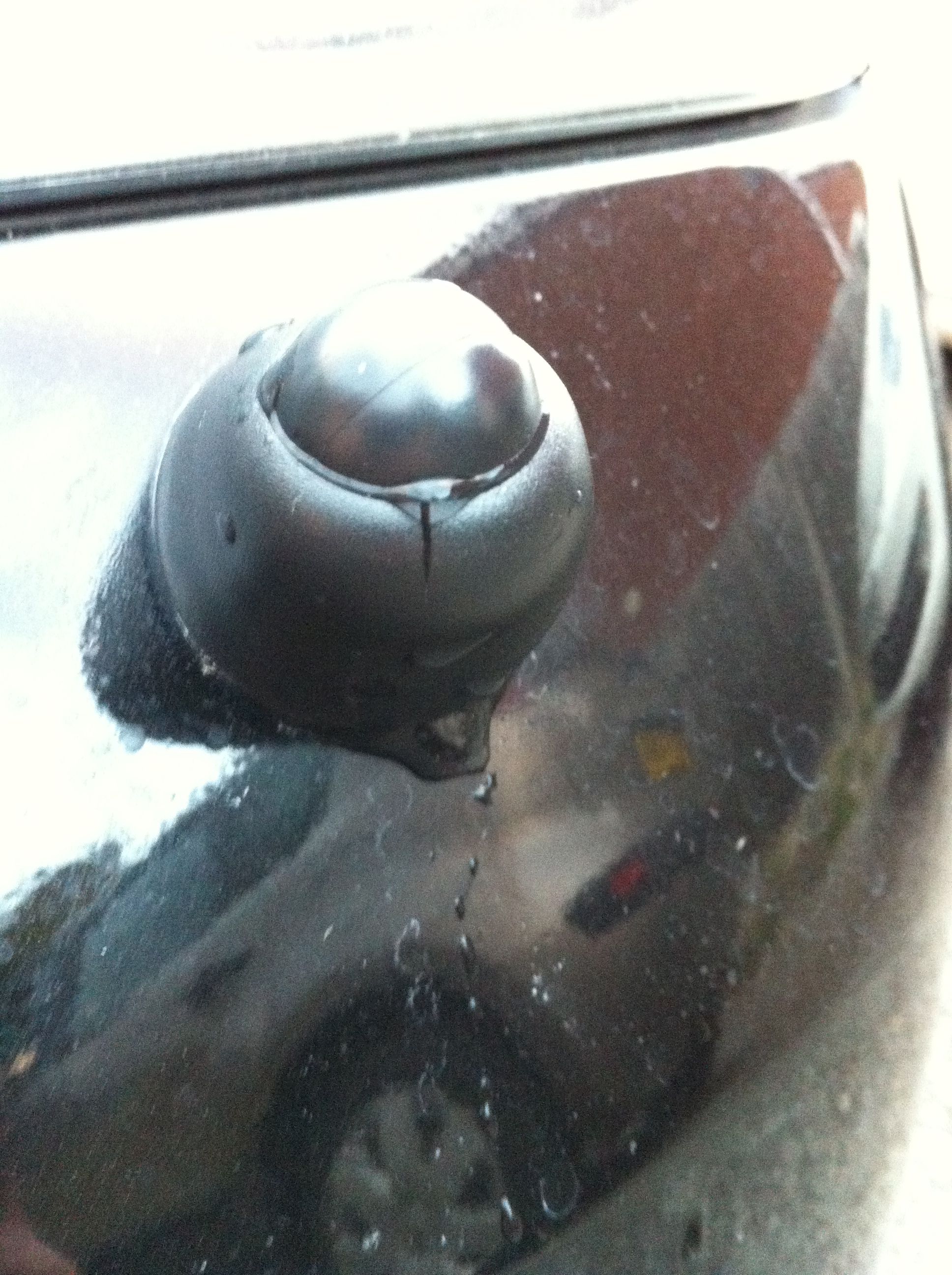

Sorry to bump an older thread, but I've got an issue with a leaking offside washer jet, it appears the plastic has actually split on the jet, and gravity is letting it leak!
Where can you get replacement jets, and how do you remove them?
I know a lot of people like to blank them, but I want to keep it standard.
  Clio 182
I jacked up one side at a time took wheel off and inner arch then 2 bolts for bumper to wing and fitted new jet. Was under £15 each.
