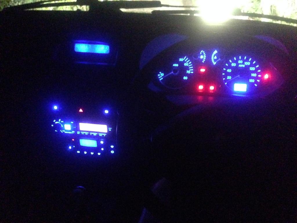

Especially thanks to @Goodj for product recommendations as they were right on the money (literally and figuratively). Not the best photo quality wise but, here's the head unit in situ, with the finished dash LED colour conversion.
