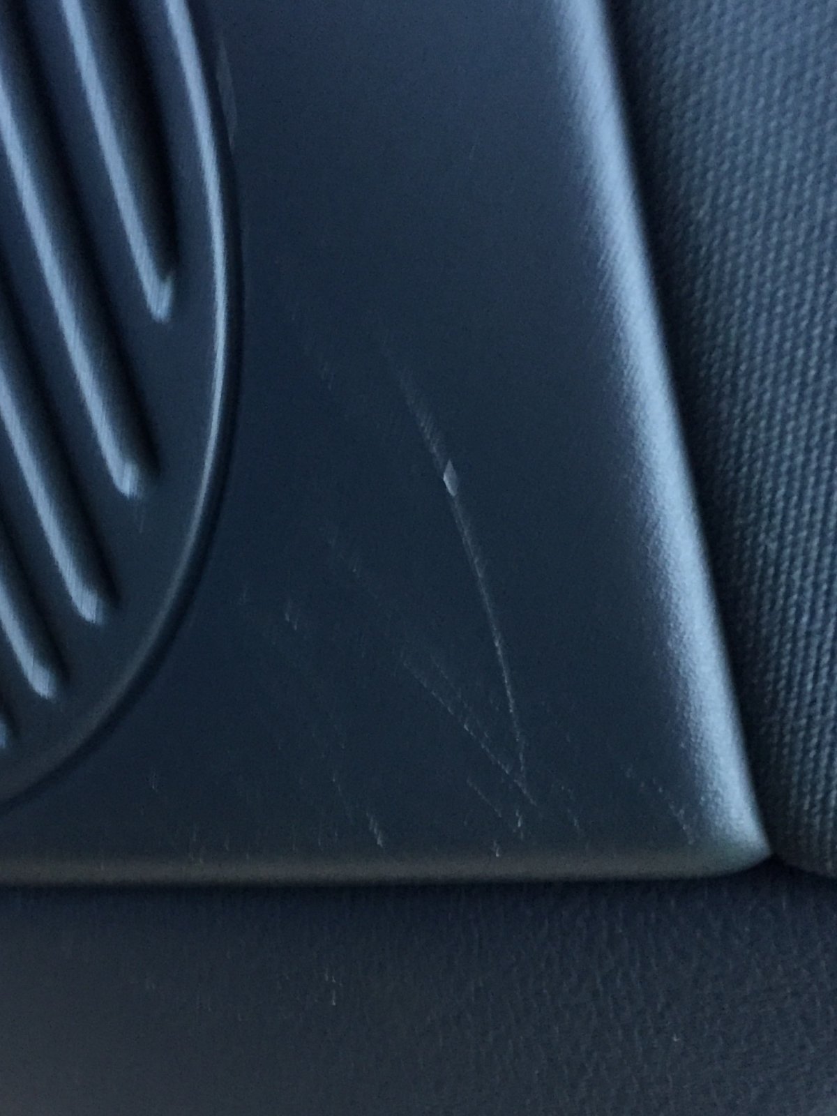

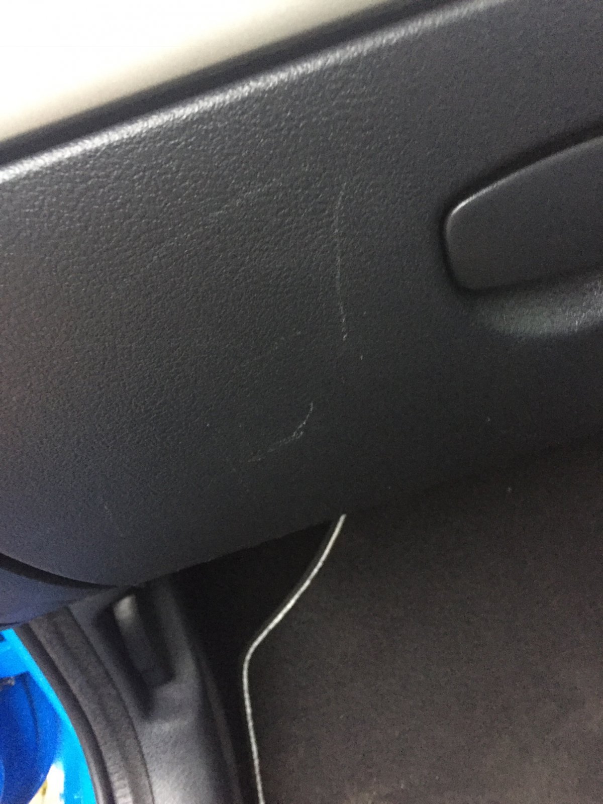

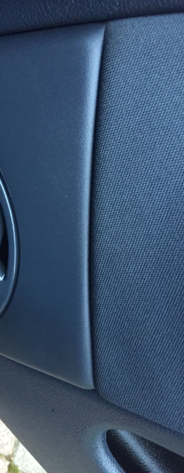

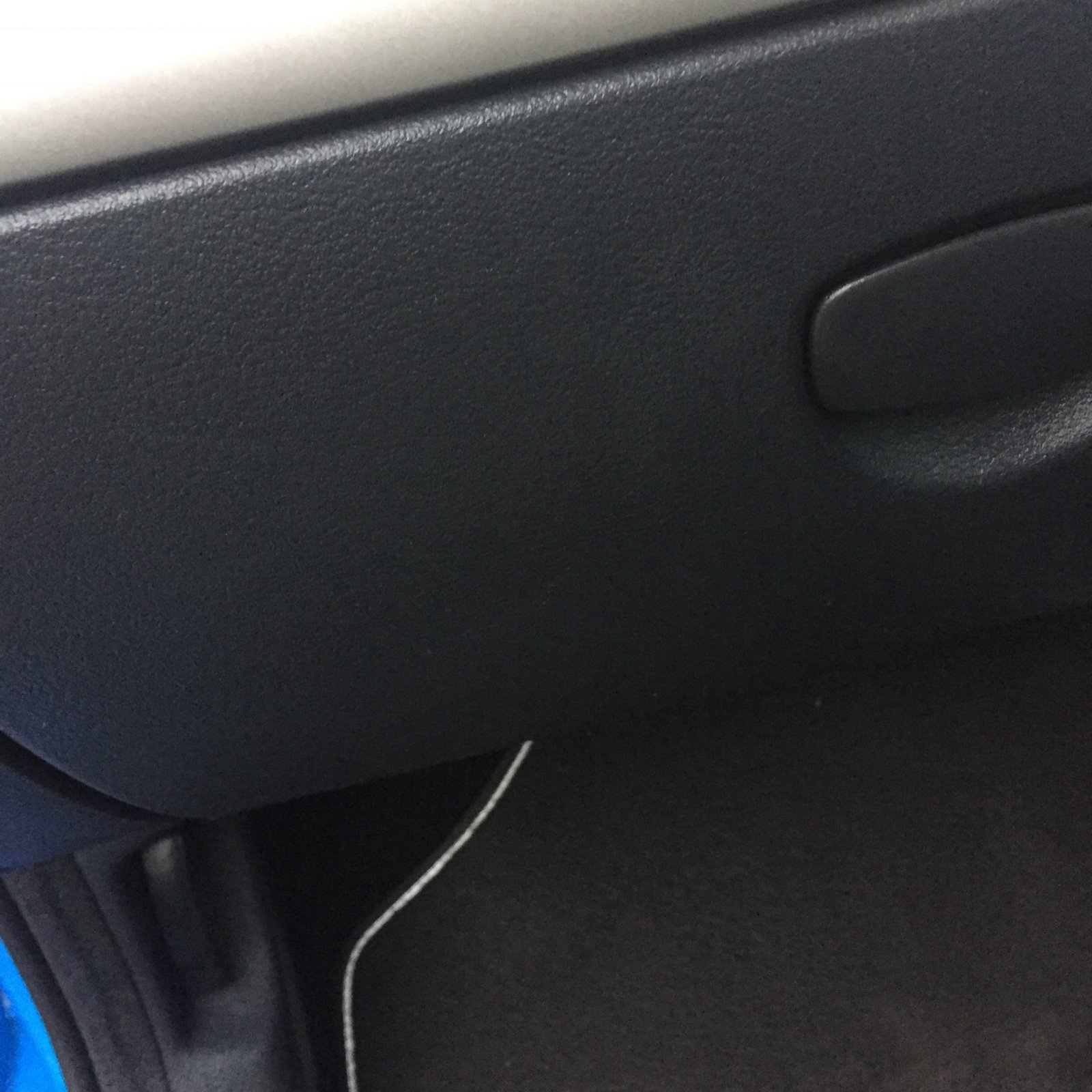

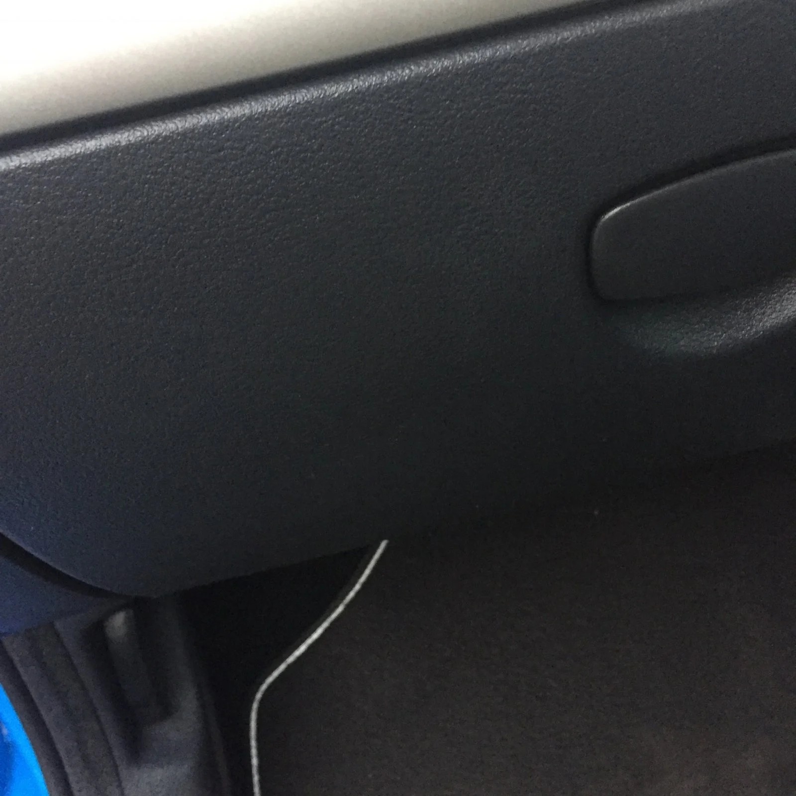

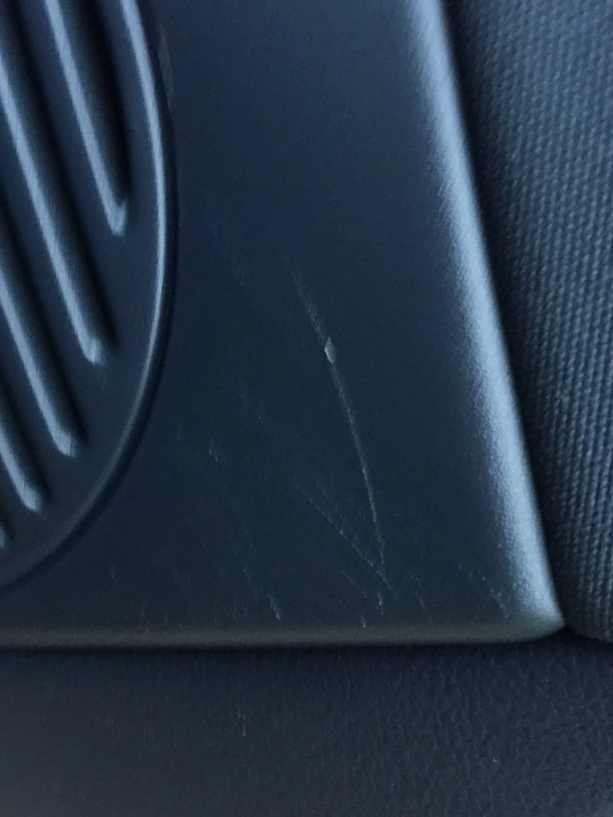

Possibly already covered on here but here's a couple of before and after pics of my efforts with the heat gun.

No you don't physically touch it. You hold the heat gun quite close to the panel moving it quickly left and right or up and down along the scratches. The plastic sort of heals the scratches under the heat. The best thing is to start prob 2 inches away and work your way closer. It's better to under do it than overdo it, move it quickly for a couple of seconds then move it away, then back again, as it gets hotter you will see the damage heal. The trick is obviously not to get it over hot or you will end up with a mess.
The above was my first attempt. I've got rid of all the kick marks on the door panel and the sill and some on the left side of the gear stick console, worked a dream
