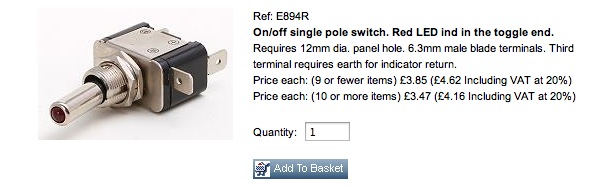

Your best bet would be to use a switch with an indicator light and then you just take a feed from the pin on the relay when active to the light :)
  220 Trophy
Thanks James - I like that idea! Although wouldn't the switch be getting the full 25A from the relay pin when active? Now that I've bought these timed relays I might as well make the most of them and would need a momentary switch, which I have, but with a light in the middle.

Anyway I've fitted an on/off switch and a couple of 12V LEDs (one for each circuit to show that the relays are working) from the relay live pins so can just turn the window on and off when needed.
Bonza and am really chuffed its all working. Just my luck though the weather has improved and I'm not likely going to be able to test it out for proper for some time.
