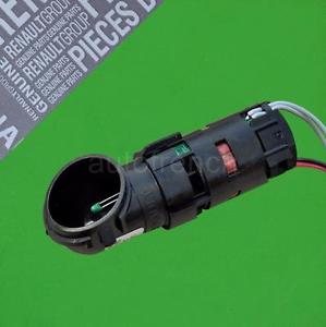

I recently stripped the cars interior out, and since then Im only getting hot air out of the vents. Im just wondering if this is because I have removed this sensor? Where is/was it located?
Refitted this into the centre console on the roof which sorted it
