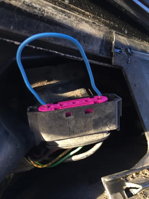

@cs_dave how do you go about testing it? Cant say electics are my strong point. Im also assuming ill need a multimeter too??? Being crimbo I probably wont get around to testing stuff myself!
@guysy I have a brand new resistor pack from euro car parts. Forget the brand. I tried it in my clio and it still didnt work so that might be going spare if you are up for that!
On the plug on the resister theres 4 wires going to it bridge 1 and 4 and if the blowers stay on full power you wont be able to turn them down its the resister at fault

Just bridged mine, my terminals where 1 and 5, and I got full fans.

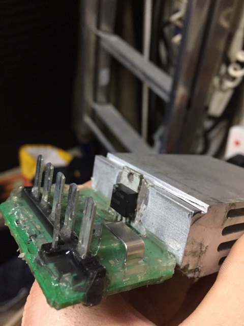

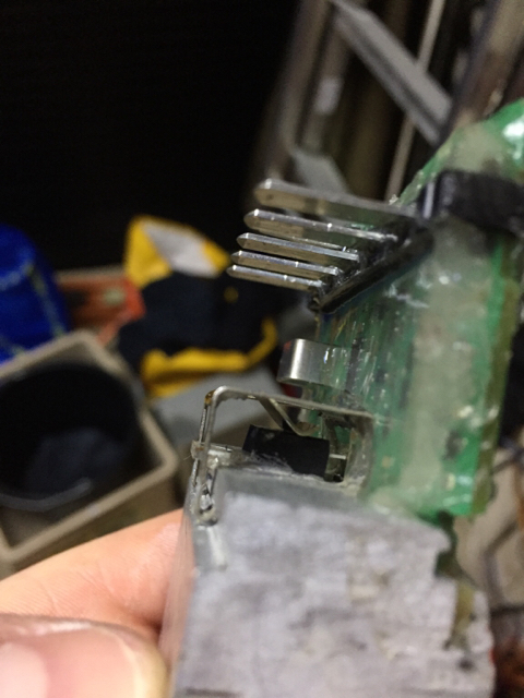

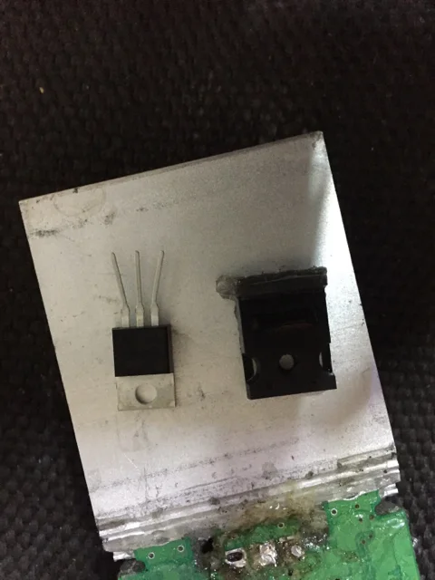

Right so the mosfet part came before the replacement heater pack.
Decided to see how easy it would be and if the fix would work.
The new chip was much smaller than the original including the legs. My soldering iron was s**t as well. But eventually I had the chip soldered on- used some thermal paste against the heat sink.
I now have fans - but even with the panel off, the fans go up and down but just not off, possible there is something wrong with the rest of the board, Any suggestions ?
Either way it's nice to have some fans now, I will see if the new pack cures everything or not.
I did clean the pads up before putting the new chip on.
Sat in place nicely on the heatsink with the clip...
(I broke the old legs off the transistor I know it's a massive bodge but I wasn't going to get all 3 out with my pissy iron, I removed them one by one)
