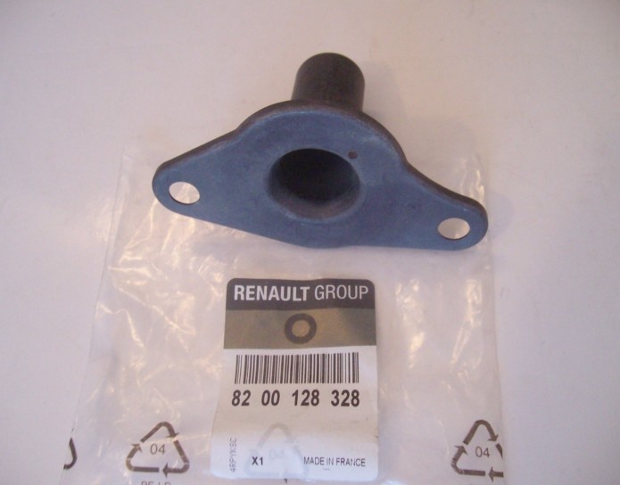

Did you clean the tube when you did the clutch?

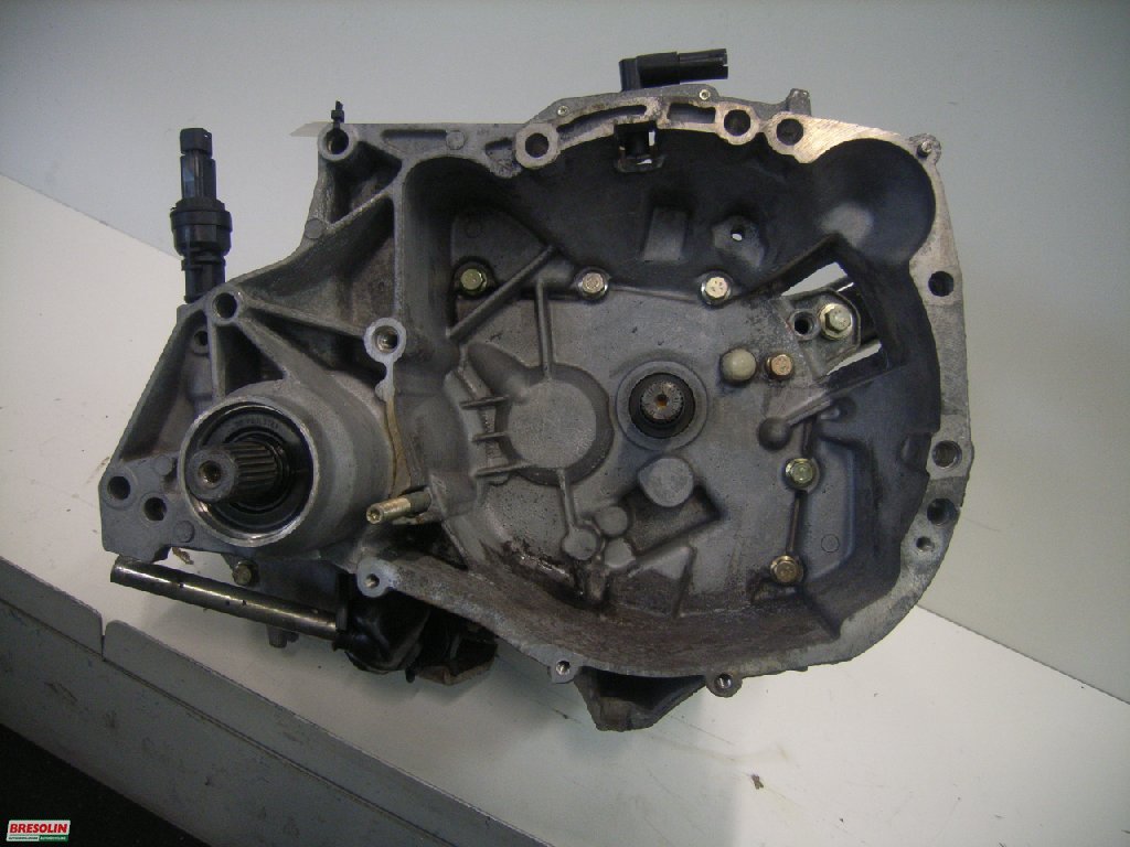

The 1.2 would appear not to have the tube/sleeve the JC5 has.
I wasted 20 minutes trying to find it on the parts list last night.

Also thats not my gearbox. Mine does not have speed sensor on gearbox it uses abs mate
Oh my bad.
Due to the fact that you have failed to tell us the year of your car, I have randomly selected a picture of the wrong gearbox to illustrate that your car does not
have a clutch thrust bearing guide sleeve.
Your lack of attention to detail may explain why you are having problems.
