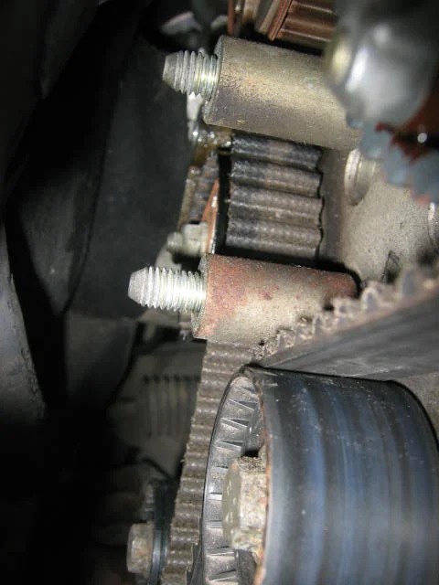

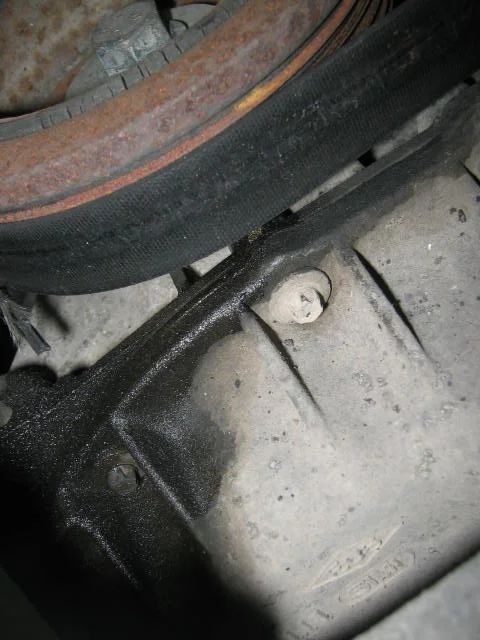

Im going to remove the cambelt cover and have a look - high costs of getting the work done (£4500 to fix a snapped belt!) plus the fact that I used to work as a fitter has prompted this decison -I will post pics along the way and let the community know how easy or difficult the job turns out.
Any help appreciated

realnumber 1
£4500?:S ?
From what I've read on here your only looking at around £1500 to replace the engine. If your doing half the work yourself then might be able to fix it for less.

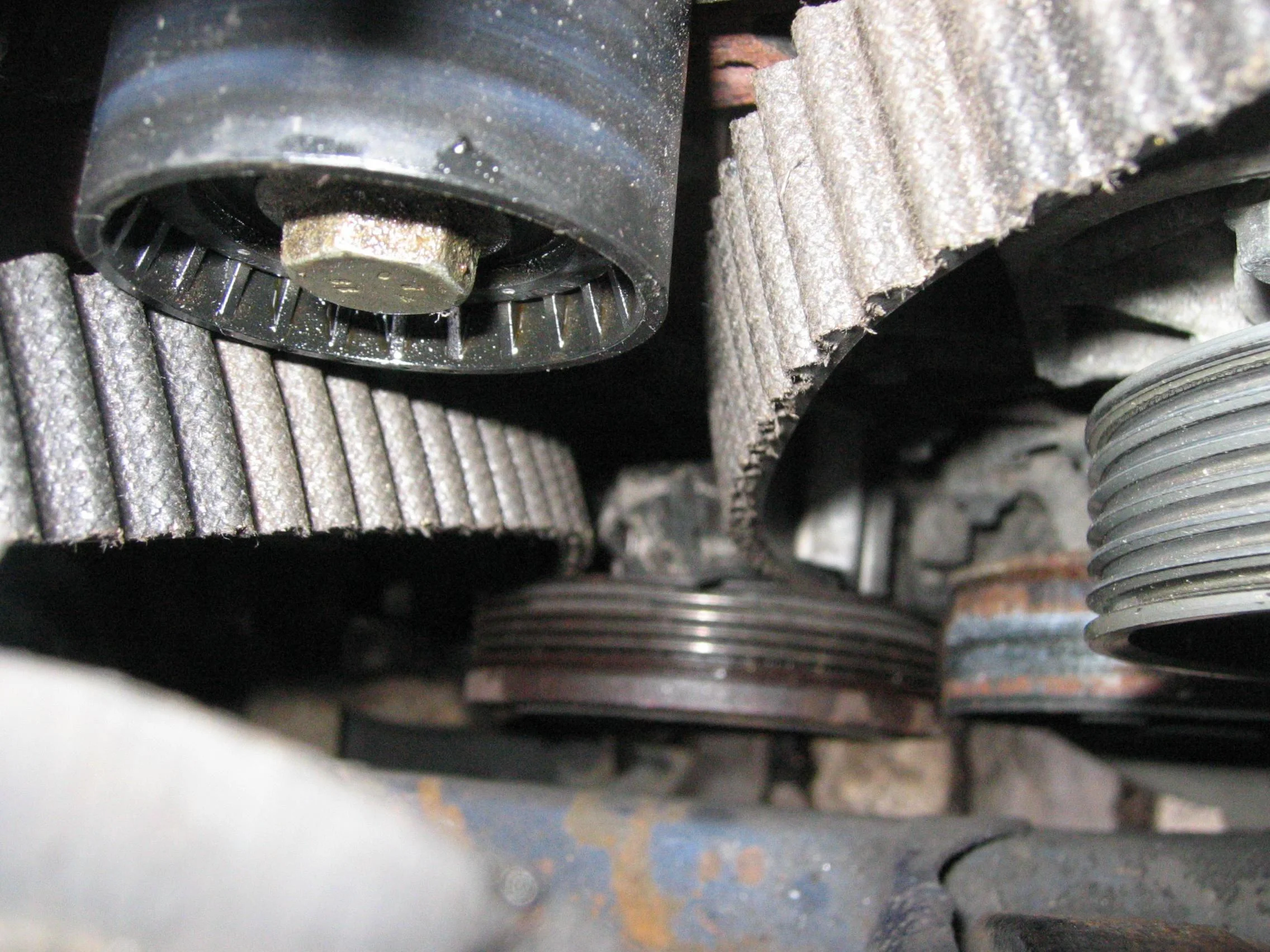

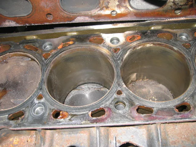

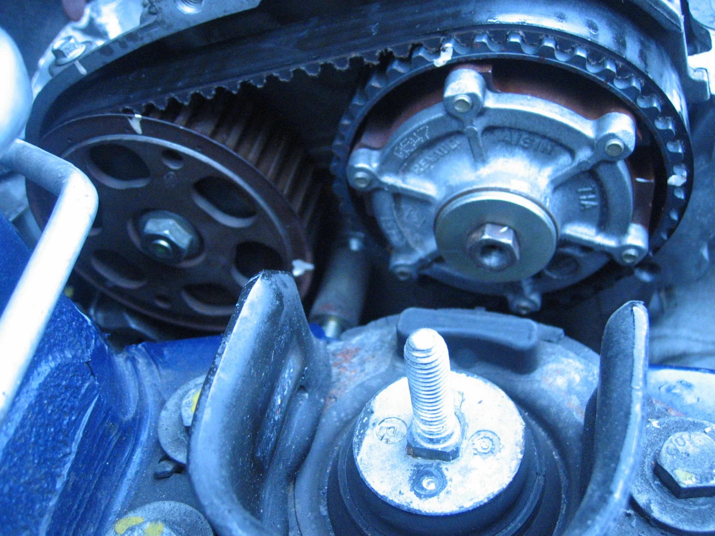

Cambelt and tensioners all good and the belt tension is also OK - however the accessory belt has moved one rib loser to the engine and is looser than I think it should be - its also breaking up and I found a piece of twine inside the timing belt cover - so did that get wrapped in the crank and allow the belt to jump? You can see the damage on the left of the first pic. If you look at the 3rd photo there is at least 1/8th of the belt missing in one area.
Camshafts photo 2 seem OK no breaks, but the engine locks on a valve - it did turn over on the starter before the AA towed me in August - havn't done it since. Question is how many crank teeth have been jumped and if only one how much damage would be caused by 18 degrees of missalignment (I think there are 20 teeth on the crank)
So the plan is buy the tools reset the crank / cams (which have not moved and were marked by Renault when the belt was last changed at 35K and the run it up and see if the valves are OK.
Or is that a bit mad?:lolup:

  renault clio 1.4 si 2000
if it's slipped a few teeth, enough to cause a piston to catch a valve and stop it cranking by hand, might it not have bent the valve at the point of the slip? you may wanna take the head off and check over it while you've got evrything else off. it's not a massive step further. if you sorted the belts and then it didn't work you'd only have to re-do it all :(
get some headwork while your at it FTW!

Valves do flex and are ductile - question is if it jumped a crank tooth cos the auzilliary belt lifted it and now its 18 degrees out is that enough to bend the valve - the hand crank feels the valve but it is not solid ie I believe I could hand crank it through - starter also would do it - I was thinking put the belt back connect up min and with belt exposed fire it up for 10 secs - it would let me know if a valve was bent - guess I could do a compression check first with the belt in the right place - need a bottle for the fule pipe mind - dont want that going off..
  LY 182
all this talk of teeth is wrong, its not timed up on teeth at all a "tooth" out on that engine is HUGE
all 3 pullies are 3 floating, the crank is physically locked at tdc (not via the pulley) and the cams are locked at the rear of the engine.... then all pulleys spin free on the shafts.
its probably spun on the crank, in which case you wont tell by looking at it, you need to strip it apart and time it up with the tools, but dont crank it anymore untill thats done as a starter motor will bend valves and if it locks its probably already had it

when you say free floating I understand that the pulleys are all free until the engine is set (TDC tool and cam alignment ) and then you clamp the pulleys to the crankshaft and the camshafts so the pulleys become fixed - sorry for being thick but at some point there needs to be a positive lock up of the system to allow the drive via the cambelt?
  172
Pulleys are only fixed to the crank/ cams by friction. If the two mating faces slip thats where the timing moves out.
I.e there is no woodruff keys on the crank or the pulleys
Its all friction fittings, i doubt the belt would "jump" a tooth, more like the crank pulley has slipped when the AUX belt went into it.
Without taking the head off it would be hard to check for bent valves, so i would get hold of the timing tools, try fit them and see if it all lines up..
if not.. re-time it and hope LOL

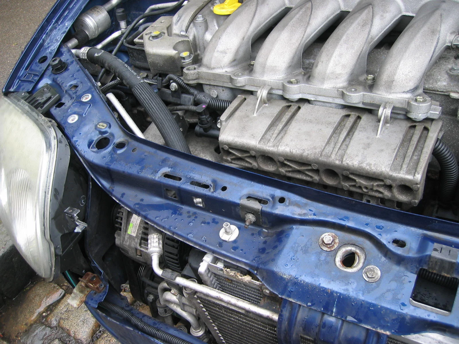

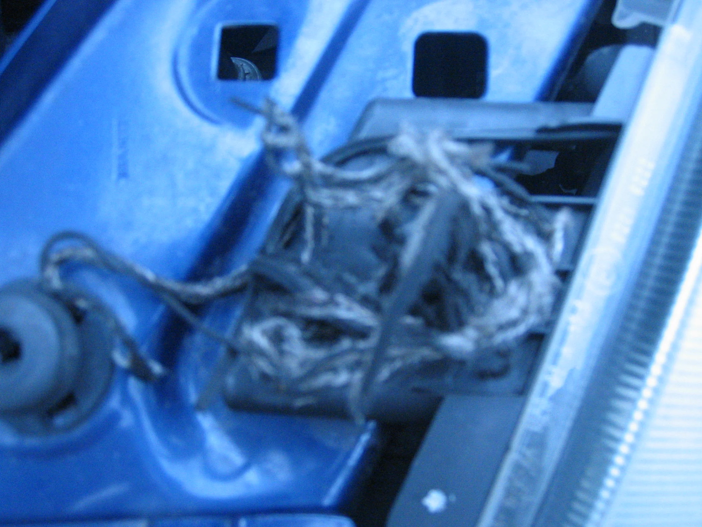

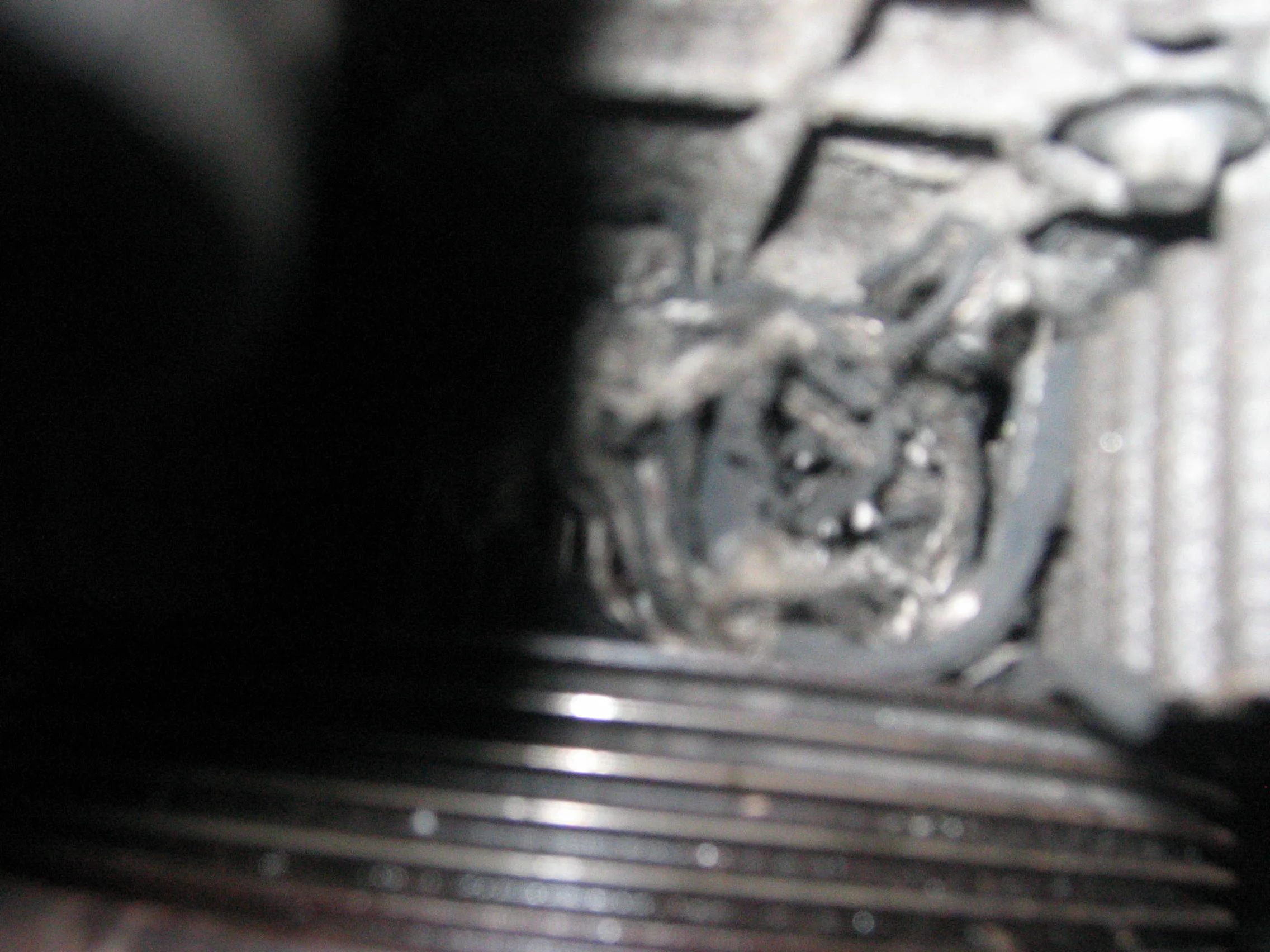

After much wet weather (I am doing the job in the street) I have found the root cause - the auxilary belt broke up and a small piece went between the cambelt and crank pulley which allowed the cambelt to ride over the crank pulley - see pic 1 & 3. Pic 2 is the bits pulled out on the valance - sorry about the focus here.
Did not go for the head option(one on Ebay in Swansea at £125) as I set the cams and crank (using a bar to find TDC which is what we used on outboards and American stendrives) and now it turns over OK by hand (can feel the valves lifting but they are not stiff just strong spring feel) - would like to do a compression check on the starter before firing her up but is it OK to turn the engine with all the systems not wired in - ie on the starter but no sensors or ignition connected? Obvously worried about the Renault computer and big earth leakges.
In the street it aint easy to find the TDC plug manual looks like gearbox end back of motor?

  ITB'd MK1
the plug for the crank locking hole is next to the dipstick tube. there's also a gap in the gearbox bellhousing where you can see the flywheel and there is a mark on the box and the fly you need to line up for accurate TBH alignment. just using the hole can still give a little variation in my experience

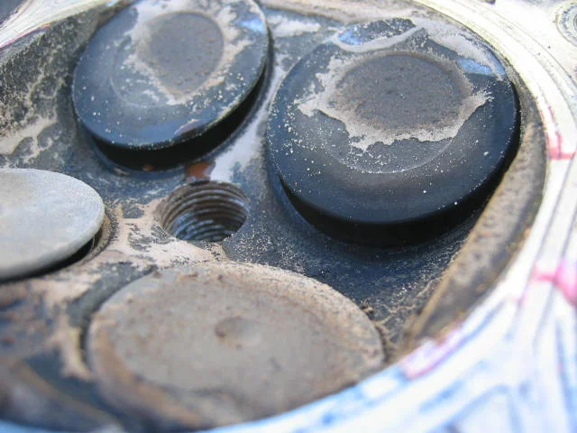

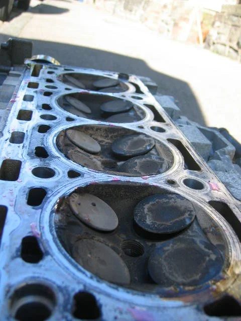

Good call - did the compression test nought! Turned over well and sounded OK no odd noises
Head off (once I got an E14 torx on it) and yes indeed all intake valves bent. No marks on exhaust but they look in the picture like they have a slight bend. Belt was still intact but one slipped crank tooth is worth a whole heap of trouble.
ALL THIS FROM A MINOR FRAYED (NOT SNAPPED) AUXILIARY BELT - BE WARNED!

  clio sport 172, 2002
your lucky mate i have snaped valves and marked pistons :(
