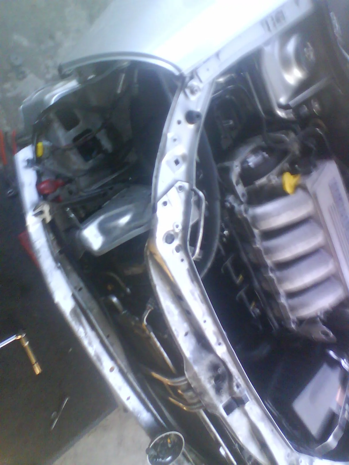

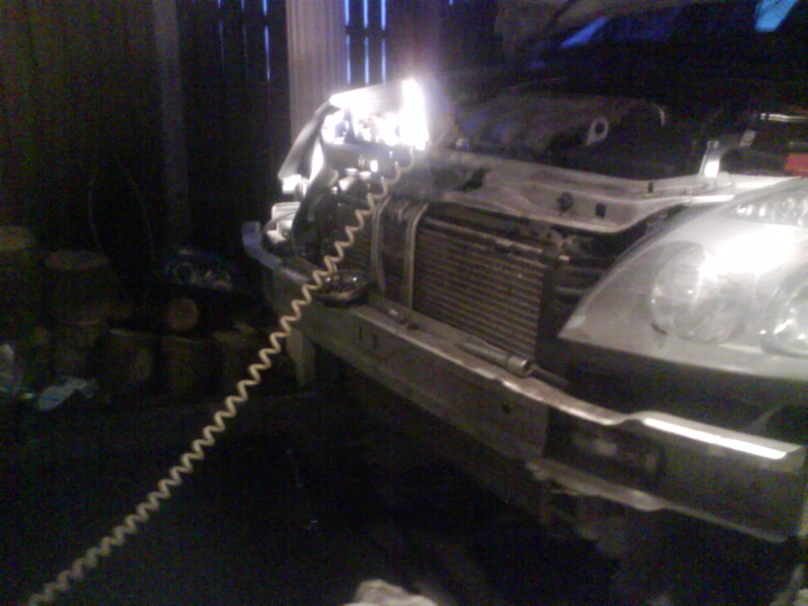

  Clio 182
Thanks so much for all your help.
For what your doing that is a t**t of a job.
Started it one night but had to wait till i could see what i was doing.
